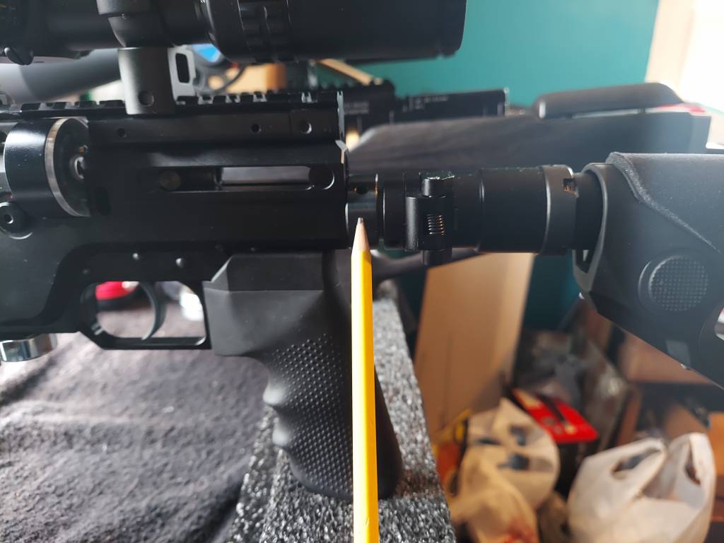

As for his hammer spring adjuster, it would add a couple of inches to the stock length, I like mine all the way in for bench shooting, besides, the spring is already adjustable with the collar in front of the side swing latch.
when I contacted the Pellet shop about my cycling issues they recommended backing this collar off and unscrewing the stock out by 2 turns, they also said that to further weaken the spring, leave it cocked overnight.
