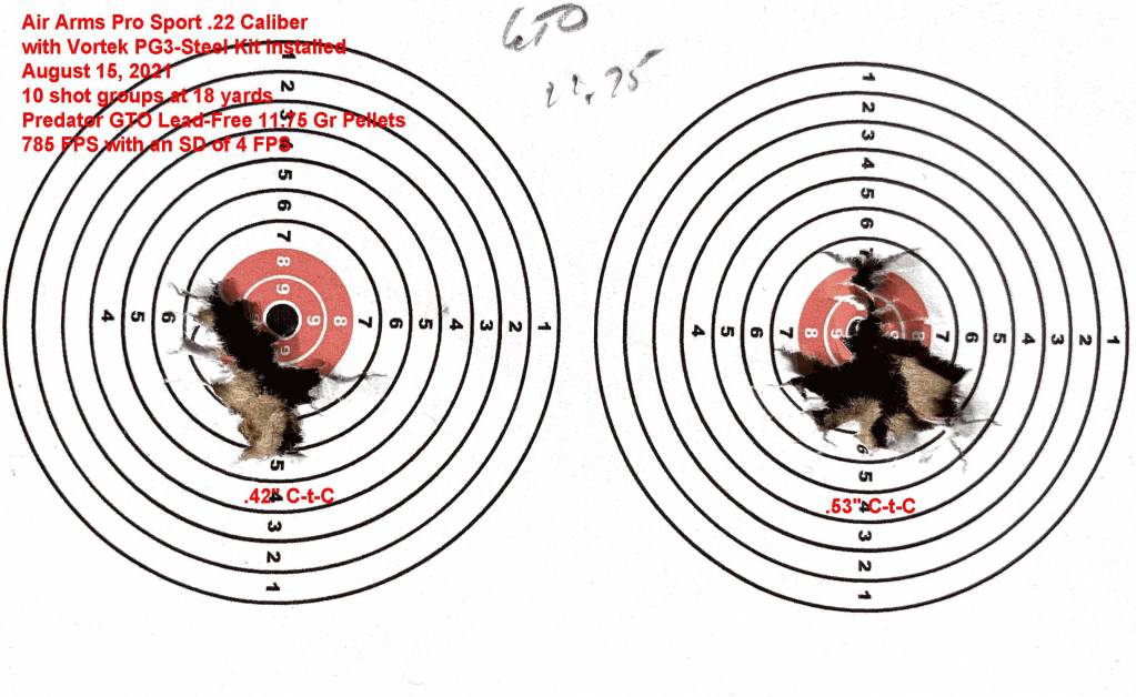

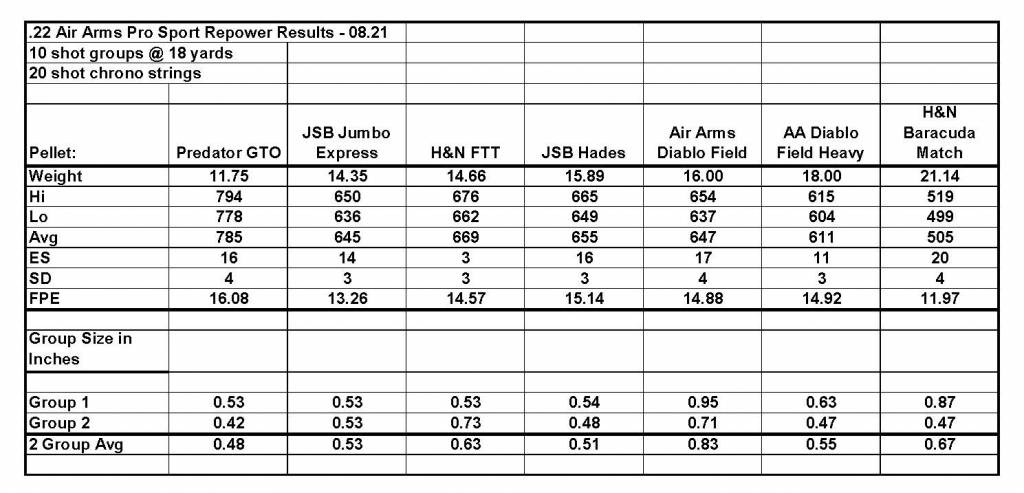

The rifle now locks up absolutely perfectly. Lubricated with Air Venturi's Tune-in-a-tube, the action is incredibly smooth. The shot cycle is as smooth as one can get, and the accuracy definitely improved. I tried seven different pellets to determine the one this rifle favors most. It shouldn't have been a surprise, as I have one TX200 and a Weihrauch 95 that strongly prefer the Predator GTO pellet, as did this one.
See the attached.
See the attached.
