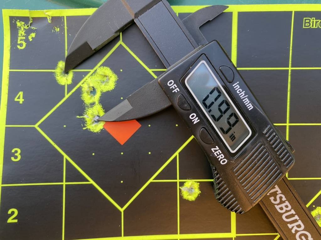

Except my luck ran out but tantalizingly close on this target, I have gotten 1 or 2 MOA groups with CPHP before but can’t find the pictures. This is 14.3 CPHP flying at 880fps at 100 yards on a range that wind likes to switch direction constantly, obviously very few groups are small like this out of many many groups with CPHP pellets.
That’s 4 shots in under an inch but the 5th shot the wind switched direction 180 degrees. It’s self torture/mutilation, weird, twisted, down down right demented kind of fun. 🤣 The bright side is over 100 shots a fill and cost 1 cent a shot cheap bastard kind of fun also, very satisfying when I get the wind dope right though.
Ok, ok, consistent sub MOA groups with .22 pellets is very difficult at the very least.
