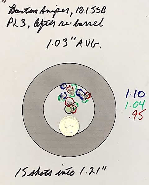

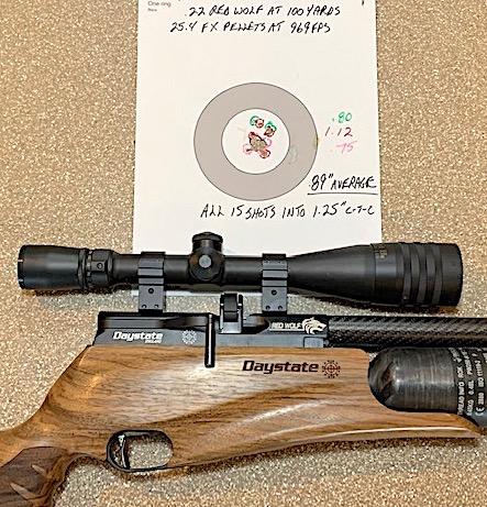

Yeah, the Tease for me is, I've always had groups where 7 or 8 of a 12 round clip, or 6 to 7 of a 10 shot group were sub 3/4" with the rest being 1.25" to 1.5". I got my RAW's ES below 15 fps, a harmonic tuner installed and now have weighed my pellets by 10 grain increments, varying speeds between 925/1030 fps.
With the 18.1's, after this the rest is the wind and me.... I've got some FX 25.4 RD, but for now the 18.1's shoot better.
Next, I will go to trying the 25.4 RD some more and likely slugs as Randy has suggested. Also, move up to my .25 cal RAW.
Also, as qball has said, it would be boring if you could achieve 1 MOA at 100 yards all the time. That's why I originally went out to 100 yards from 50 - 50 yards seemed too easy!
