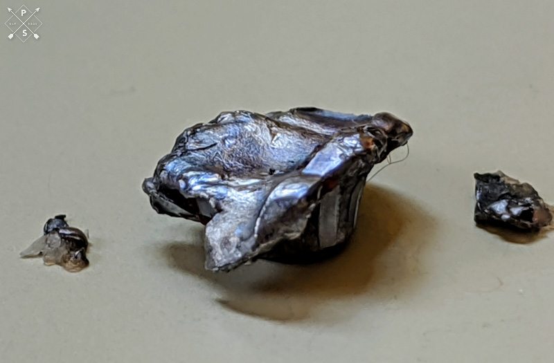

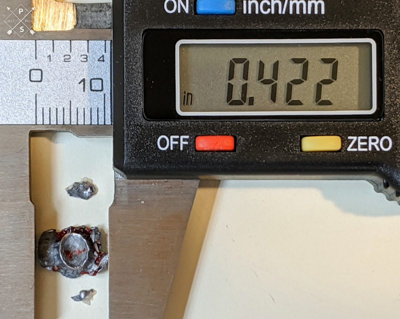

Here is what a 17.5 gr. slug I just removed from a squirrel looks like. These are flying about 900 fps from a standard RTI Priest. Did the trick for sure!

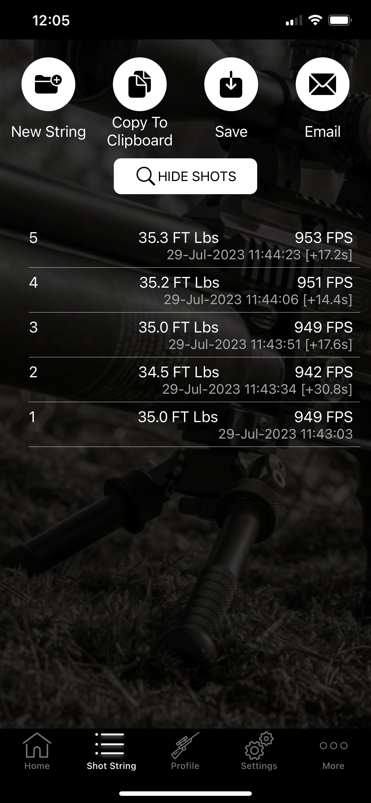

I have my RAW tuned to shoot JSB 18gr @ 970fps but also shoot the NSA 17.5gr on same tune and velocity is 20fps slower about 950-ish. I also put my open NSA slugs in my empty JSB tins labeled also like you...LOL!
