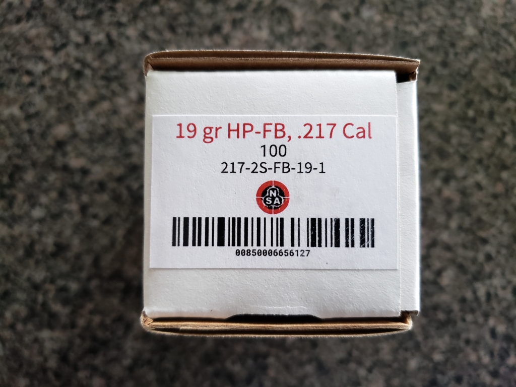

Any experience with the .217 19gr flat base ones?
Who makes those? I have tried the 20.2 grain .217 in my .22 EDGun R3 Long at 980 to 990 FPS and it loves them. They shoot too slow out of my Cricket so I didn’t bother checking accuracy, and I don’t want to crank up the power. Honestly I’m thrilled that I can shoot a slug (accurately) out of the Mini that has better wind performance than any of the “high BC” pellets.

Bought these a while back, put a few through my Condor.

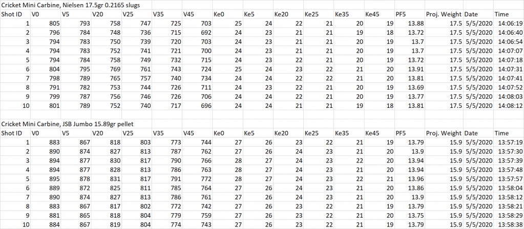

Centercut - I broke out my Cricket Mini Carbine and tried both JSB Jumbo 15.89 gr pellets and Nielsen 17.5 gr, 0.2165 slugs with my LabRadar. I live at an altitude of ~7100ft and the temp was 67*. My Cricket was tuned by Charlie Frear last year and I haven't changed any settings. I shot at 50 yards and have attached pictures of the groups. I managed about 1.5" with pellets and 3" with slugs. I have also attached a spreadsheet from the LabRadar with the 10 shot data. This may help you in determining BC for the slugs.
Thanks, appreciate the info. My Mini shoots the 18.1s at about 880 FPS and the NSA 17.5 at 850 FPS. Perhaps your gun isn't shooting them fast enough to get the benefit of accuracy? In my gun the NSA 17.5 and the 18.1 pellets were "hole in hole" HA! j/k ;) I'd say though that five shot groups at 50 yards with both would easily be covered by a penny.
On my best day I'm a 2 MOA shooter but I should have done better with the pellets. The test group Charlie supplied with the rifle was a 0.3 inch 5 shot group at 40 yards with 15.89 gr pellets. I only added the groups for reference. I agree that I need to up the fps if I intend to shoot slugs in the Cricket. The slugs were bought to shot in a different rifle that I intended to set up for slugs. The air pressure was 30.16 inHg. Meant to include that in original post. Also the altitude via GPS is 7126 ft.
