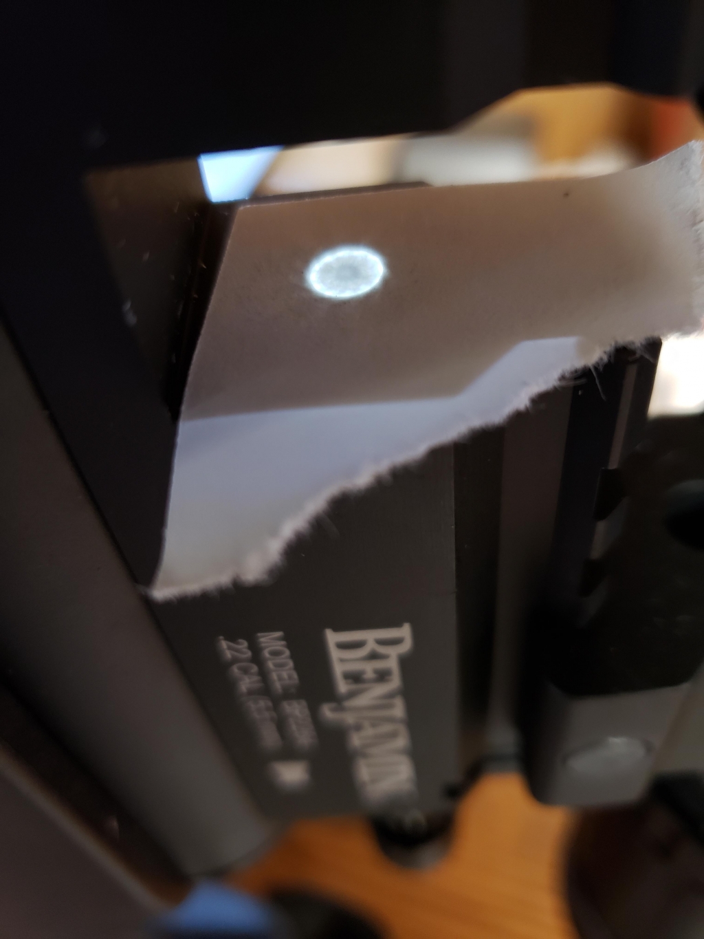

Luckily, I still had just enough .217 21gr slugs left to verify my hypothesis about the increased velocity. The uncoated slug can be seen setting in the rifleling, which was protected by my flashlight onto the paper.

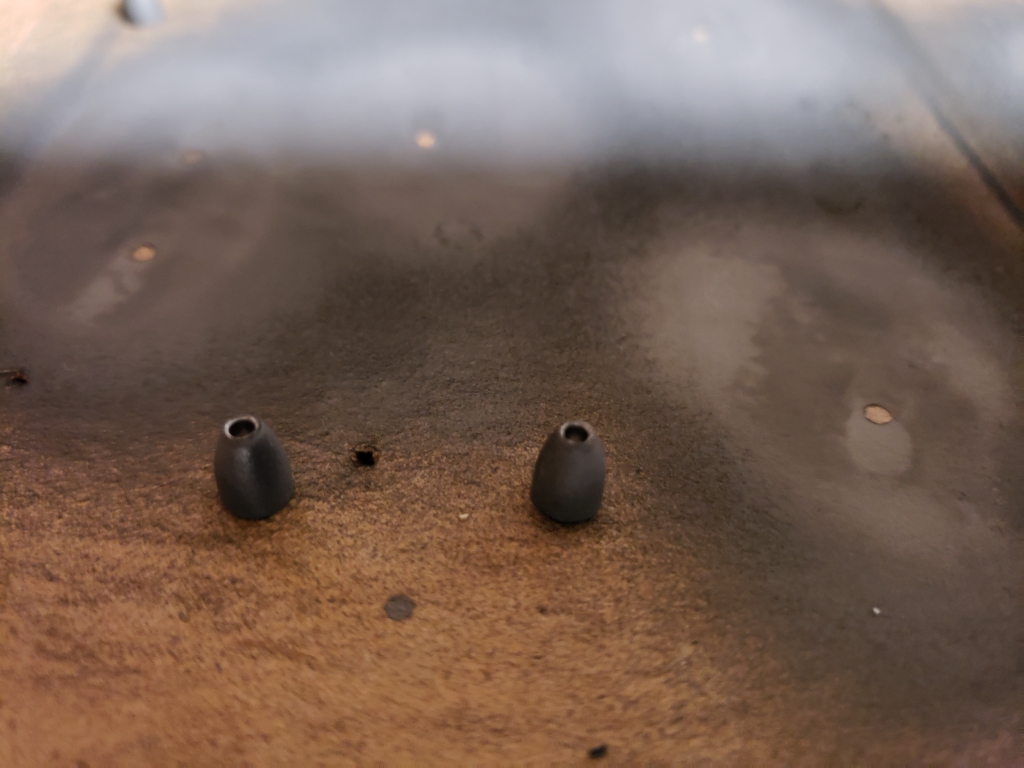

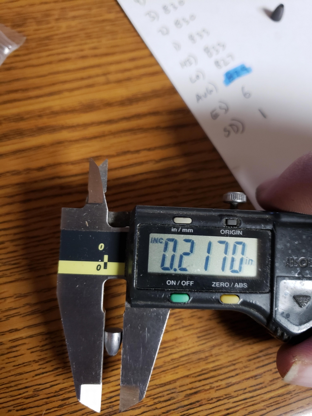

The first thing I did was to verify the .217 Dia., then washed the slugs to ensure all mold release and lubrication had been removed. I then sprayed them with a few coats of the TY lube, to ensure that they were coated well.
I measured them after coating to check final Dia., which varied from around .219 - .220. The goal was to prove a better seal with higher velocities, so consistent coating thickness was not really looked at.
They definitely look Tacticool in black.

I tried coating the last 7 21gr slugs I had very lightly to see how much the thickness mattered. That's when I discovered that I was actually using the 21gr .217 instead of the 19gr .217 slugs( which I have already used up the supply of), Which makes more sense in relationship to the velocities I recorded during the string. After coating the thickness was around .2175 - .218, which yielded an average FPS of 838 FPS which is 9 more than uncoated.This would suggest that it is more due to tighter seal in the bore.

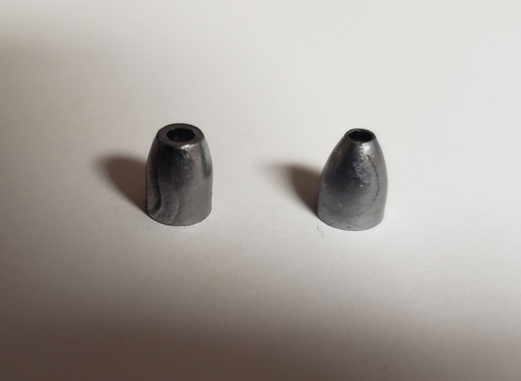

 I go the 23gr slugs today, and unfortunately, they are a bust for me.
I had them moving at about 840 FPS and making over 35ft-lbs, but they couldn't hold a group out of my barrel.
One thing I noticed was that there is significant more slug engagement with the rifleling.
I could tell the difference as I chambered each slug as compaired to the 21 gr slugs.
