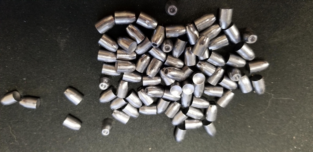

.216 slugs were made today, all the same weights as the .217 and .218. Just enough to do some testing and get a little feedback. Hoping some of the choked barrels will like the smaller diameter.
We expect production to start next week when we finish up overseas orders. Any request as to what weights people interested would like to see available first?
