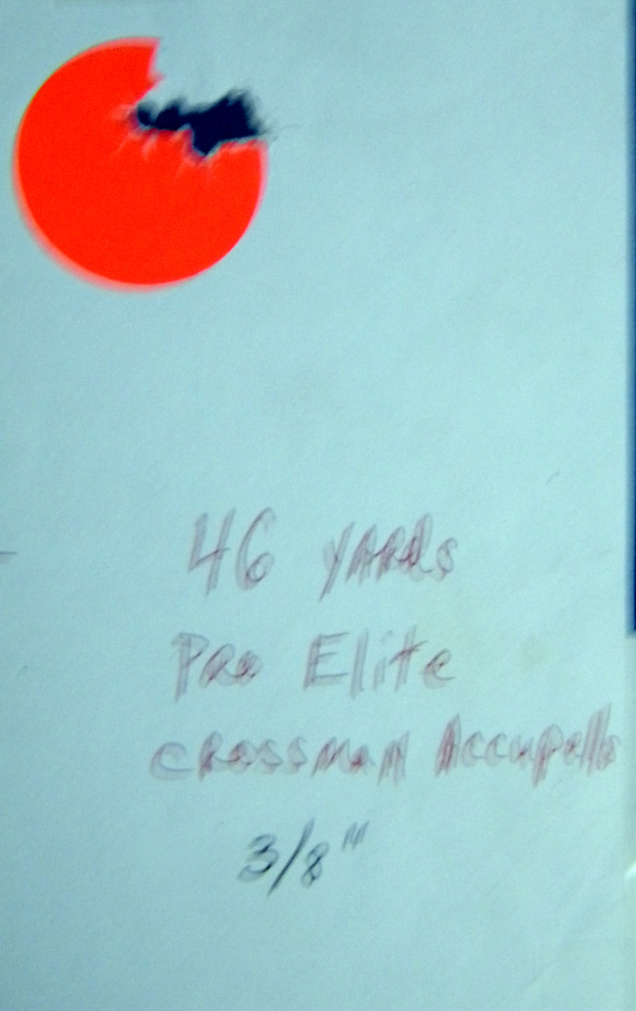

20+fpe shot while standing and grasping a door frame, rifle rested on that hand.

I owned a Pro Elite once - they are now hard to find, almost none were .177 caliber, and right at 20fpe. Not a field target gun.

Over 500 PE's were made in .177. People also say an R9 is not a field target gun yet I've won 2 state championships with mine and it was shooting 15-16fpe

I've owned at least 4 PE's and one is a walnut .177

It was never a question of they are not hard to find or not easy, I responded to the "almost none were .177 caliber". 500 is pretty far from none and no fewer than 2 PE's were on eBay for some time!
