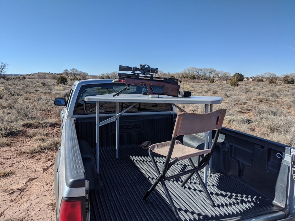

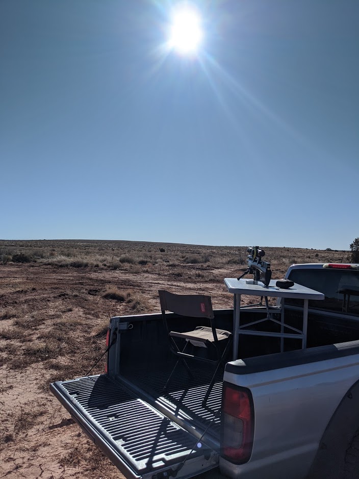

In the first pic there's a lone juniper bush out there about where the gun is pointed, target is in front of and a little to the right of that tree. You can see said juniper in the rangefinder pic.
Holding phone to the rangefinder.......kinda works.
