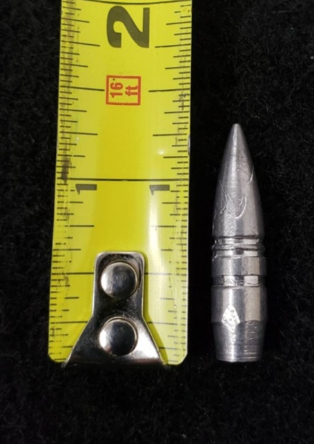

I found it and watched the full video. This is all the info I could get:
.308 caliber
Slug: 155gr
BC: probably a G1 BC of about 0.31
Velocity: ~1000fps
Elevation: ~8000 feet
Most every shot was called after about a 7 second flight time. Under the above conditions, that puts it at about 1750yds. Hard to believe the 2058 yd distance was correct. They should have shown the view of the 36” target (if that’s what it was) through a high power FFP scope. That would have allowed for a visual stadiametric verification of the distance. From everything shown, the numbers don’t work out.
A velocity of 1200fps could do it, but doubt that much was possible.
They don’t explain how they verified the distance.
I don’t doubt that the shot is possible, but not as shown. I’d like to believe it. Give me some of the missing info that makes it work.
Edit: A close up of the “impact” point would have been good to see. The description sounded like a drop shaped grey streak. That could just as likely be a bird dropping. Overall, they need a more scientific approach if they want claim a “WORLD record”.
