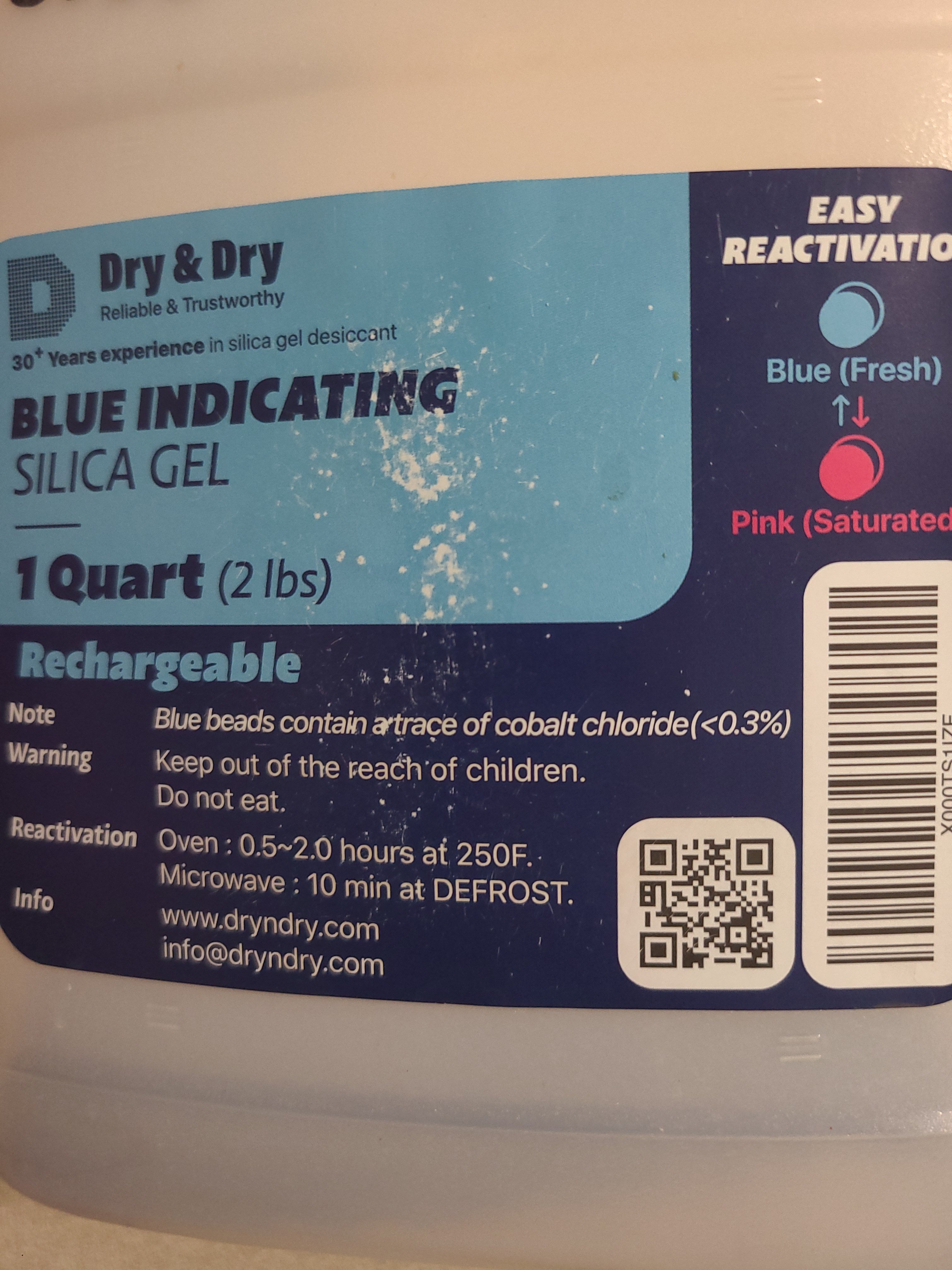

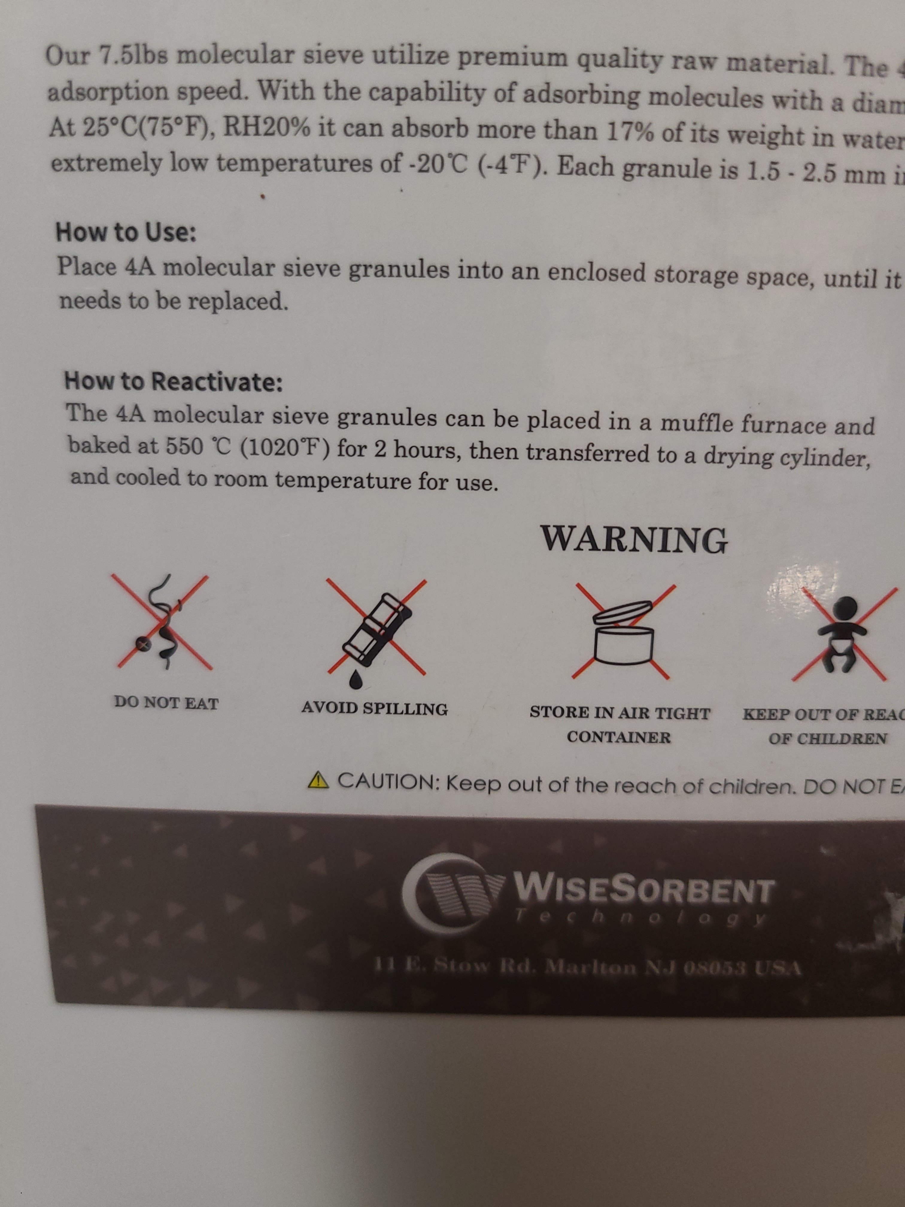

How are you drying your molecular sieve. To reactivate the stuff I got, the instructions says, heat @ 1020F° for 2 hours. So, I just been tossing it.
So far, I've only used 3a but plan to get 13x later on.
I microwaved the 3a sieve with blue (pink until dried out) silica balls mixed in until there was no more moisture collecting on the inside walls of the microwave oven (approx 15 minutes). That seemed dry enough for me. Since returning all the desiccant to the peanut jar and running the compressor for another 90 minutes or so, the indicating silica is still blue. And, I still get NO moisture from the CS4's drain.
You can choose to disbelieve, but
this has been working out for me so far.
I've never tried to dry molecular sieve beads precicsely because of what Ta-Ta-Toothie says, but whenever I dty out my silica gel beads, I weigh them before and after to find out how much water has has been driven out. If the beads have fully turned, it can be about 30% of the dry weight.
Next time you dry yours, I would highly recommend weighing them - it will let you see if you are getting all of them fully dry, partially dry, or just the indicating ones . . .
