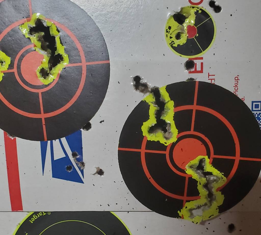

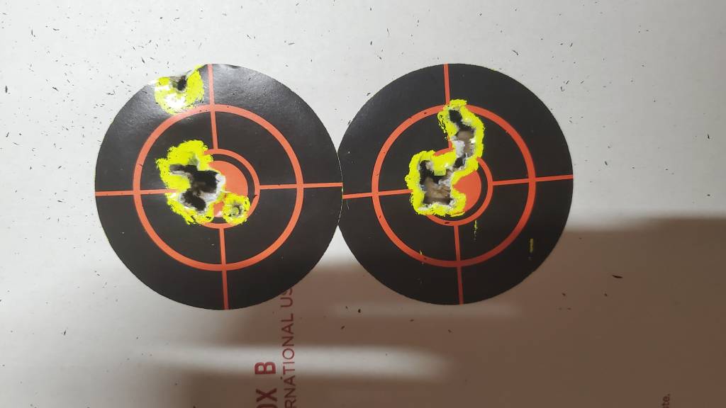

I'll do what I can. I've still been chasing tuning for my lightweight pellets (14.3 Crosman HPs). I've already gone through 2500 of them and 500 JSBs. I tried going down to 12 MPA on the reg but that led to a wide swing in FPS from shot to shot. Kelly said to go up to 17 MPA and that got my under 10 STD.
In my 11 yard basement range that wide swing led to my POI going up which happened consistently. POI starts low, goes right, then up and left. Very weird. These are all 19 rounds.
Turned the reg up to 17MPA and went down one click on the power wheel. It settled down a lot as shown in the left target where I shot as fast as I could (top and right fliers were my fault). Right target is the same previous 12MPA reg setting. Again, both targets are 19 rounds.

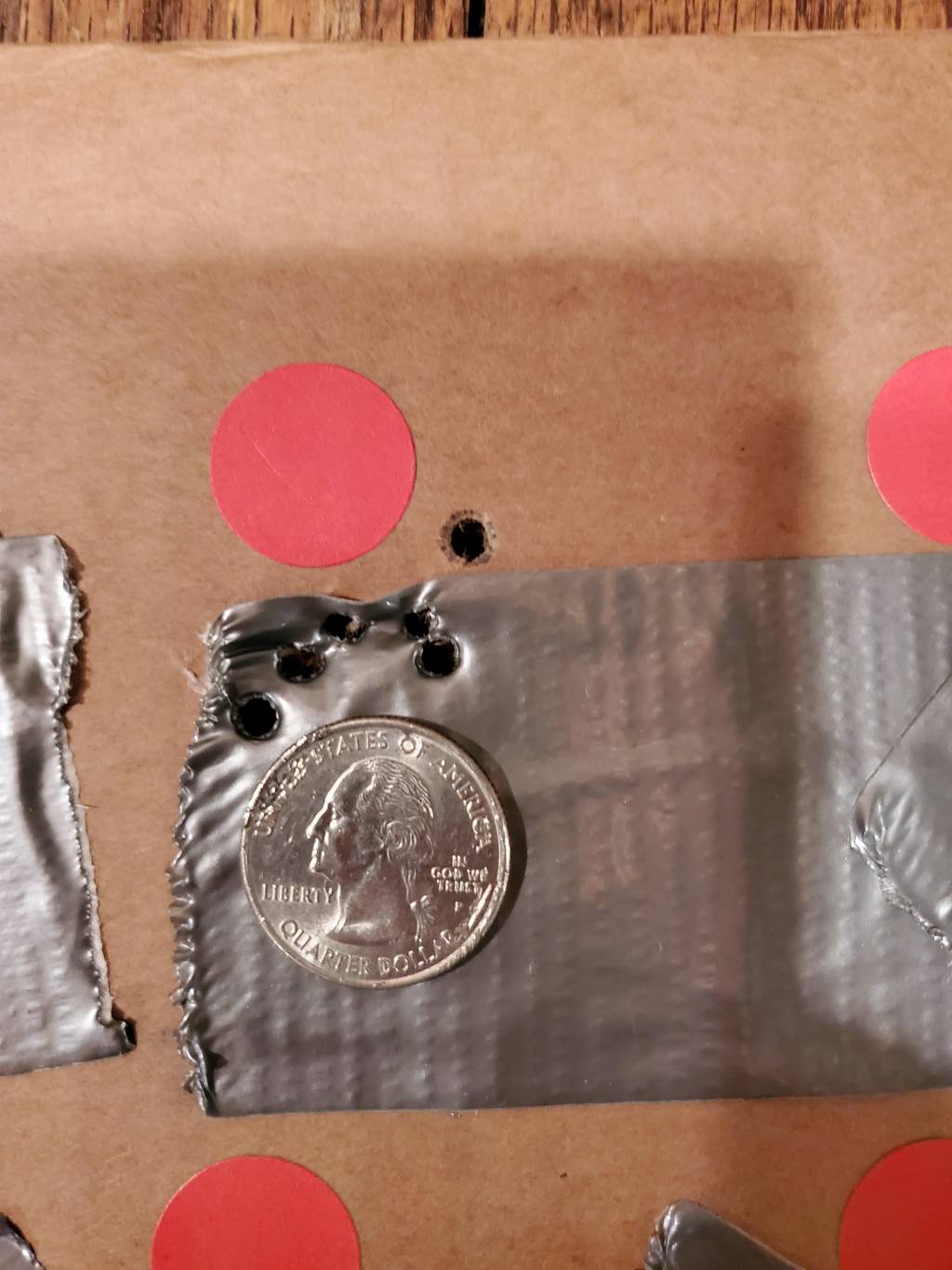

With most of the Neilson slugs from .26.8 grain dish base, the 36.2's, and of course the FX Hybrids, I'm shooting groups about 3/4 to an inch at 50, yet they also tag some long distance (217 yards for one) shots almost like the Impact X did, my old beloved silvertone that I basically traded for it. I've caught some of these slugs with my eye, and they look great in flight. Good indication that these groups don't seem to spread out at long range, as some destabilize, and cannot stay the course over a couple hundred or more yards.
The FX Hybrids and the 26.8 dish base blaze outta the barrel at 1080 or so. This is all with factory set reg at about 175 according to it's gauge. They stay as tight as the 36.2's running about 960. Wanna turn the reg up and see what it'll do. I'm finishing my makeshift 1996 manufactured 60 minute SCBA tank. With the PCP fill "station," Main valve, and dated tank; I have maybe 120 dollars in it all, and it works great.
