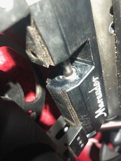

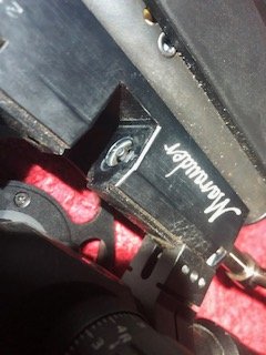

thank you...Since I bought my Marauder in March 2015, I must have a Gen2. Thanks for the information. I'm attaching a couple of pics. Is the O ring at the rear of the breech the "blown out" o-ring?
That does look like it might be it, but the groove is in the barrel, so to see if it is where it is supposed to be you have to look at the other side of the mag slot from the pictures. It does no good on the probe - it has to be in the slot. if it ended up back there as shown in your picture you'll have to fish it out and get it back in the slot. They are tricky to get seated in the slot - a dowel up the barrel as a support helps a lot.
Second pic. Check to see if it’s around the base of the bolt probe. If it’s there remove it and insert it back into the barrel side.
