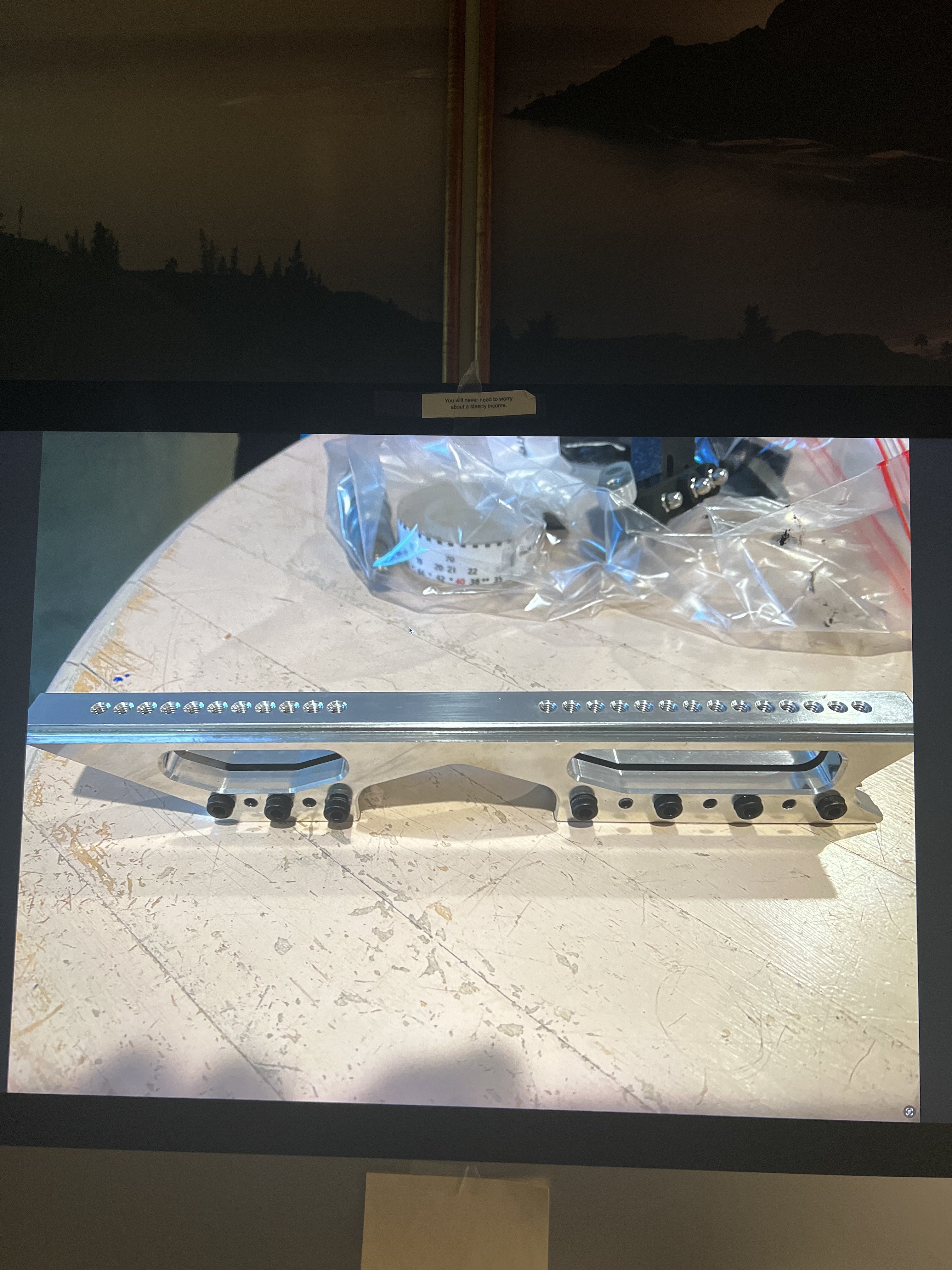

I and wondering where I can find a 20 MOA Dovetail to Piccatiny rail adapter. I have search the threads but all the links I found and clicked on did not work. Thanks in advance...

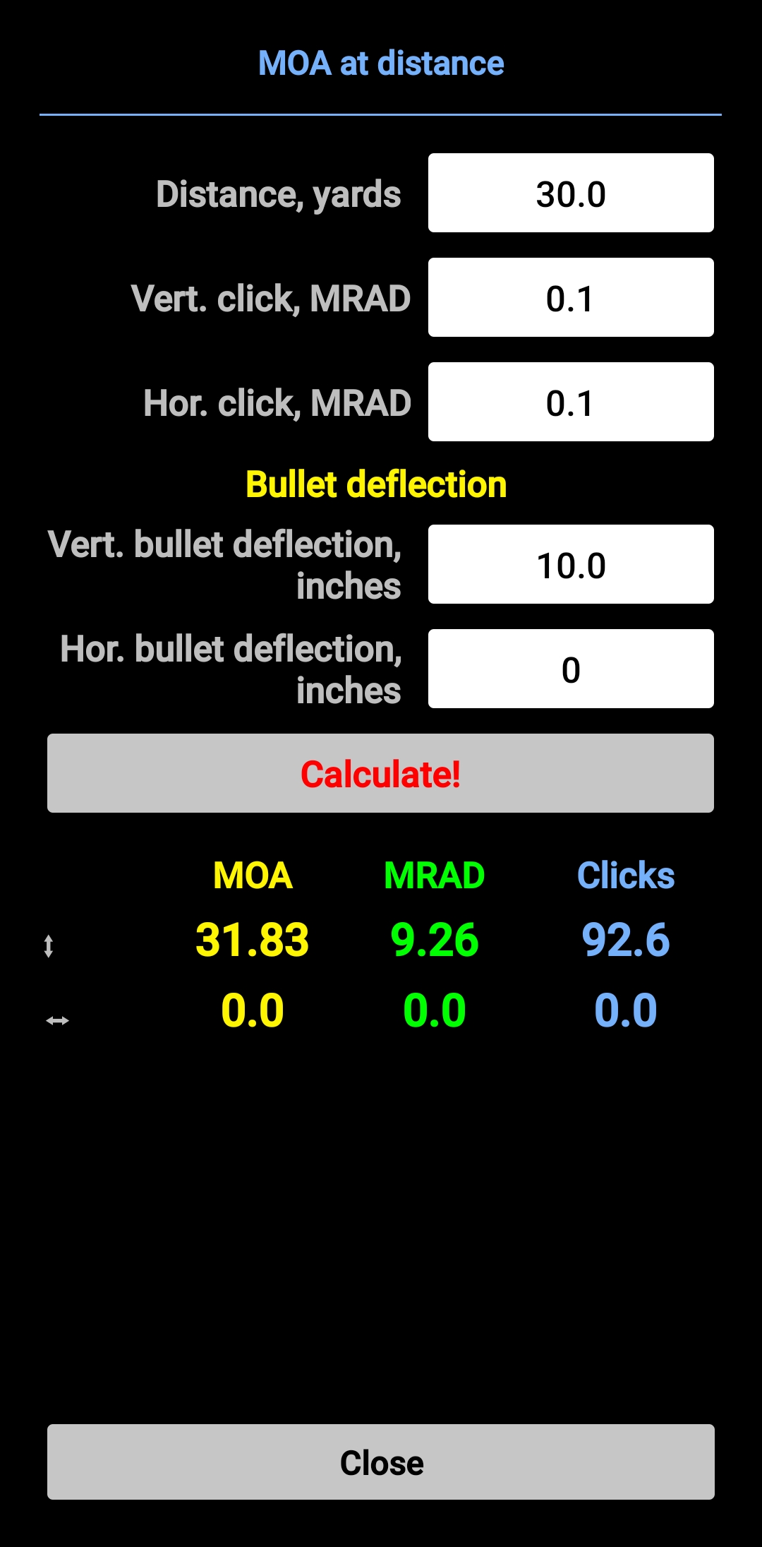

That's what your fingers are for@SilentSquirrel I believe that will work... I actually saw that but did not read the description like I just did,lol!! I appreciate it. I wonder what that 10" at 30yds calculates to in MRAD!??

This may work for you
Seems to be available here:

@RM.510bigbore I appreciate that. I just looked and they are out of stock on BKL website. Apparently I'm not the only one looking for them, lol!!!Only buy AIRFORCE brand BKL adapter .. I tried most other brands on my .510 Texan and they would slide under recoil from 650 grain slugs
20 mao doesn't help much with my TEXAN. Im usually 60-100 moa to optically center .. Adjustable moa scope rings pretty cheap...For airguns i use all adjustable scope base or adjustable rings or i wanna pull my hair out...Doesn't BKL make some 20moa mounts?

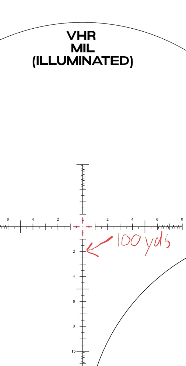

@RM.510bigbore I am still pretty new to ALL of this. I crossbow and rifle hunted for the last 10 years. I would just sight in, go to the woods, take a shot! It was not till I got into air gunning that I went down the rabbit hole of learning everything that I could to try to understand air guns, scopes, reticals, holdovers, air capacities, tanks, tuning, and the list goes on!!! Not really a 100% sure how much 20 MOA is. I currently have a UTG cantilever mount with an Arken optic scope on it. Every scope I have had on it I simply shimmed the back ring to give me more elevation. Not sure how much, but it always seems to be enough! I sighted in with my new scope from Arken yesterday at 50 yds. At 100 yds I held over on the two on my reticle and hit my 8-in gong Target multiple times back to back with 350g HPBT Zan's, if it's getting the job done like like that should I leave the shims and cancel the order that I place for an Arken cantilever with 20 MOA that will not be delivered for 4 to 6 weeks?20 mao doesn't help much with my TEXAN. Im usually 60-100 moa to optically center .. Adjustable moa scope rings pretty cheap...For airguns i use all adjustable scope base or adjustable rings or i wanna pull my hair out...
