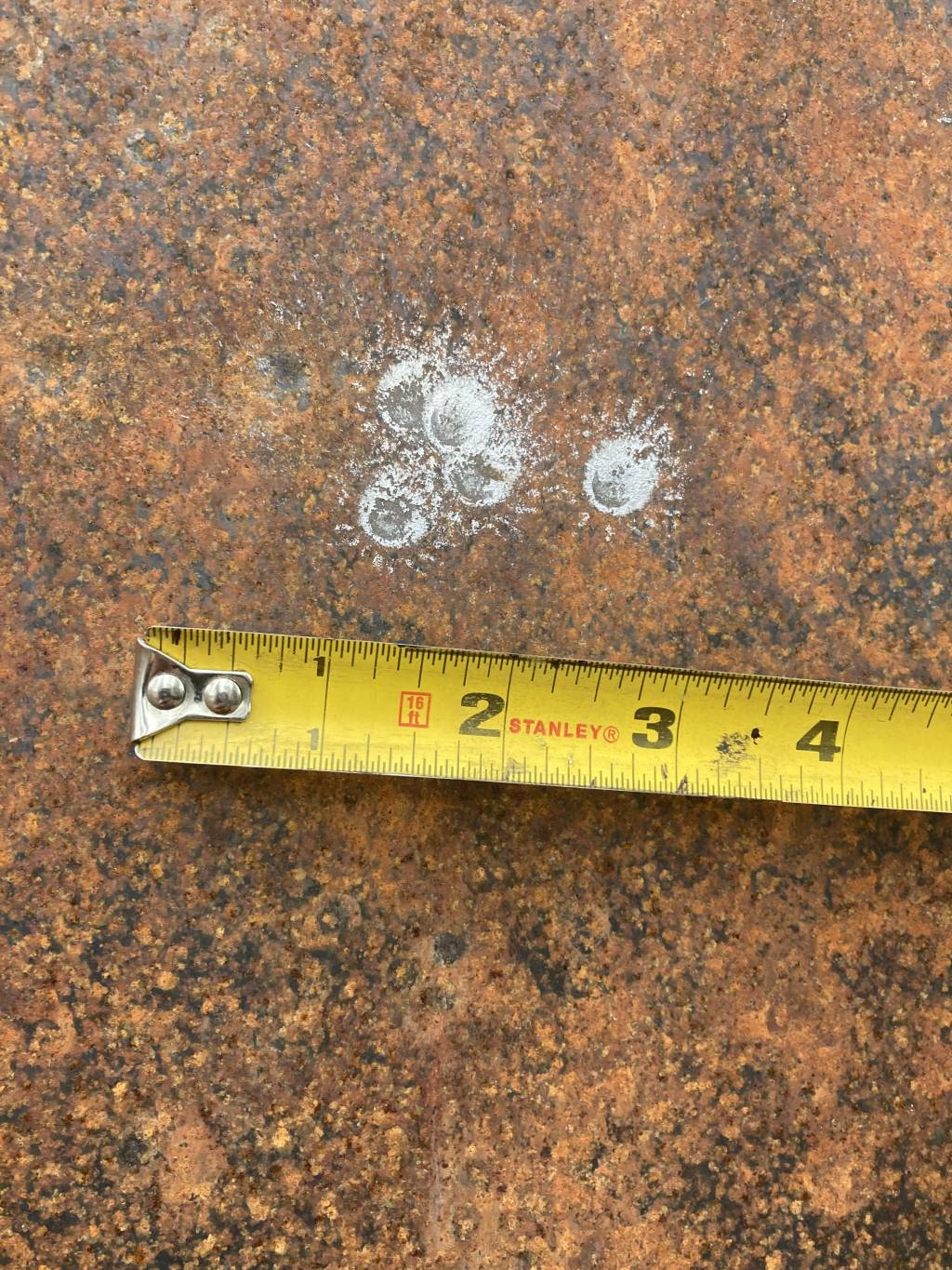

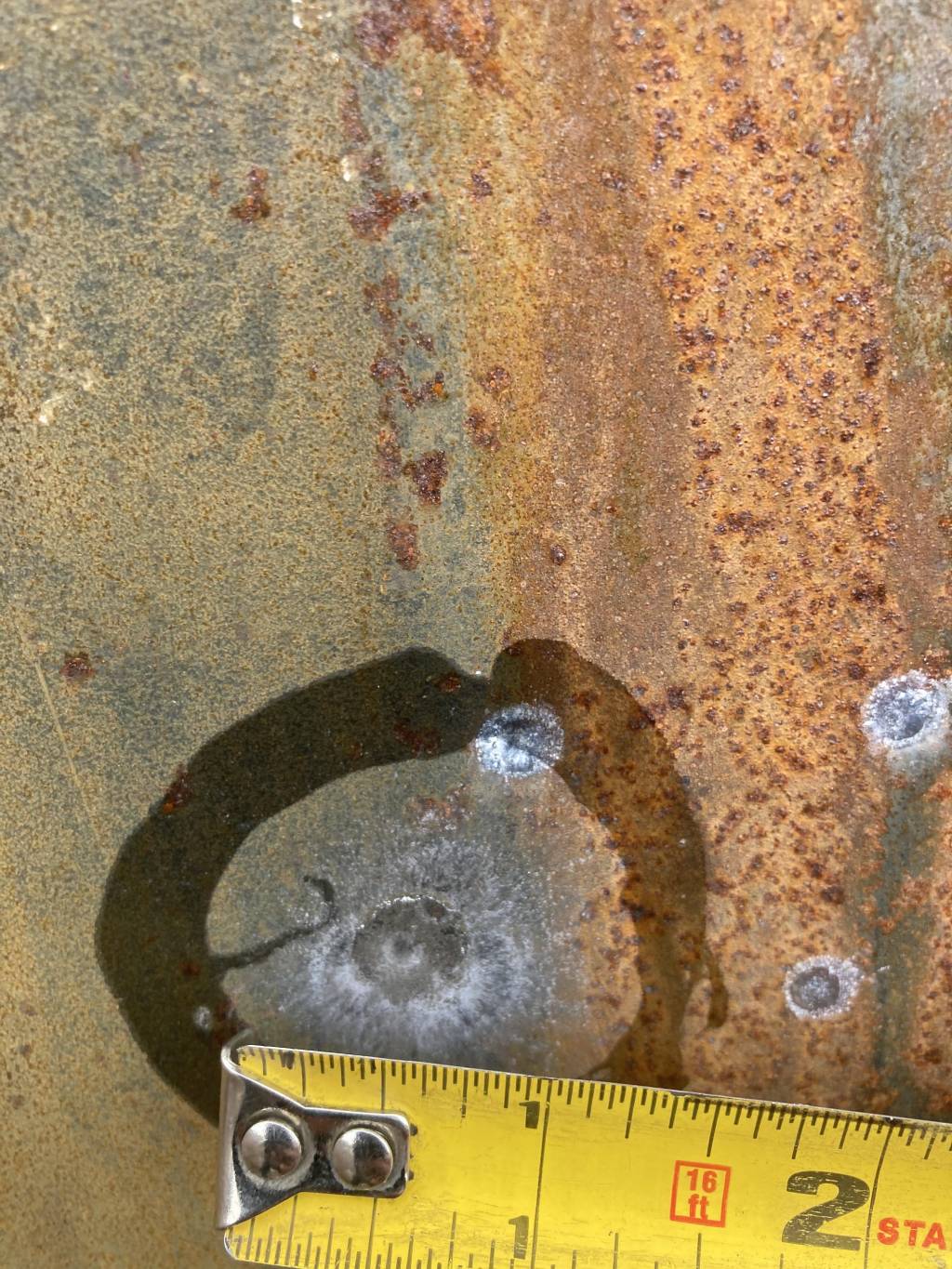

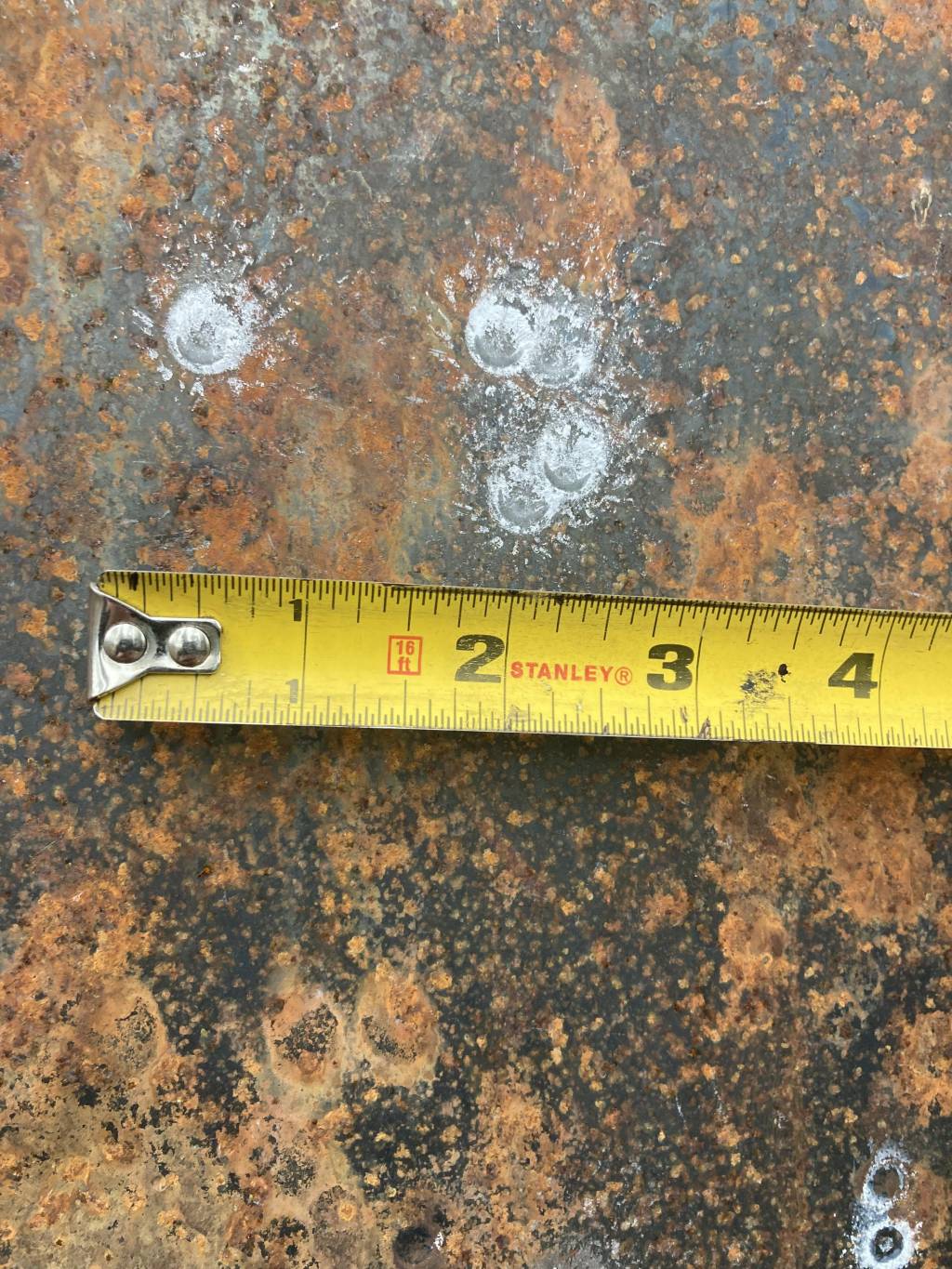

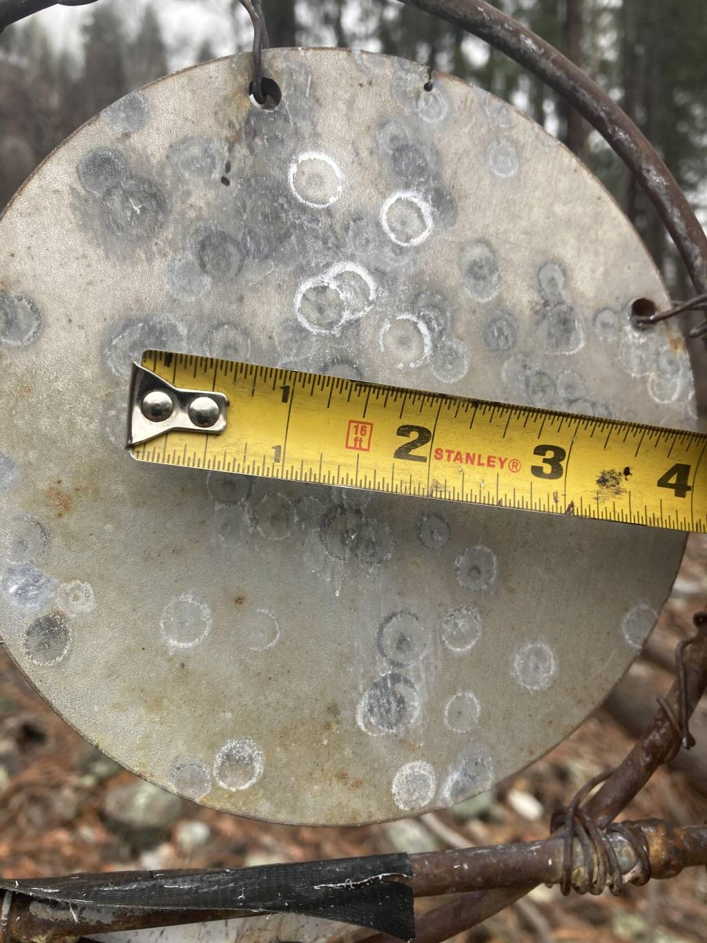

The snow finally came off the mountain and I could get to my 130 yard target again. I shot with my Theoben rapid .20 cal. with 13.73 grain pellets, and the .30 Crown with the 44.75 grain pellet. There was some wind, enough to only try one group with the .20 because the little pellets just blow off course so easily. But the .30 was pretty amazing, it’s shooting around 870. The .30 hits so hard! Look at the picture of the circled group, it was shot at 70 yards and is pellet on pellet, but what’s really amazing is how much it dented the steel sheet! None of my other rifles do that on the steel, definitely use’s some air though lol!

It is a blast to have em pile up Mike! But now I want to try 200 yards and beyond like you guys are doing with the slugs. This .30 Crown was converted into a high power .20 caliber by AZ, it was going to be shooting the heavies at about 970.
Allen said the Crown would produce plenty of power for the project and he was going to do one for himself as well.
But unfortunately the two LW barrels I ordered and had sent to him were imperfect and both of them were causing a small flutter in the pellet flight. They would only produce a 3/4 inch group at 60 yards, and that’s with Allen shooting. So we gave up on the idea of the hot .20 and Allen put a FX Superior .22 barrel on his Crown and sold it to someone, some lucky someone, because he said it was incredibly accurate. Since I had just ordered a RedWolf .22 HP, I decided to have him leave it as a .30, and he added a hammer weight that brought the power up to 78 fpe!

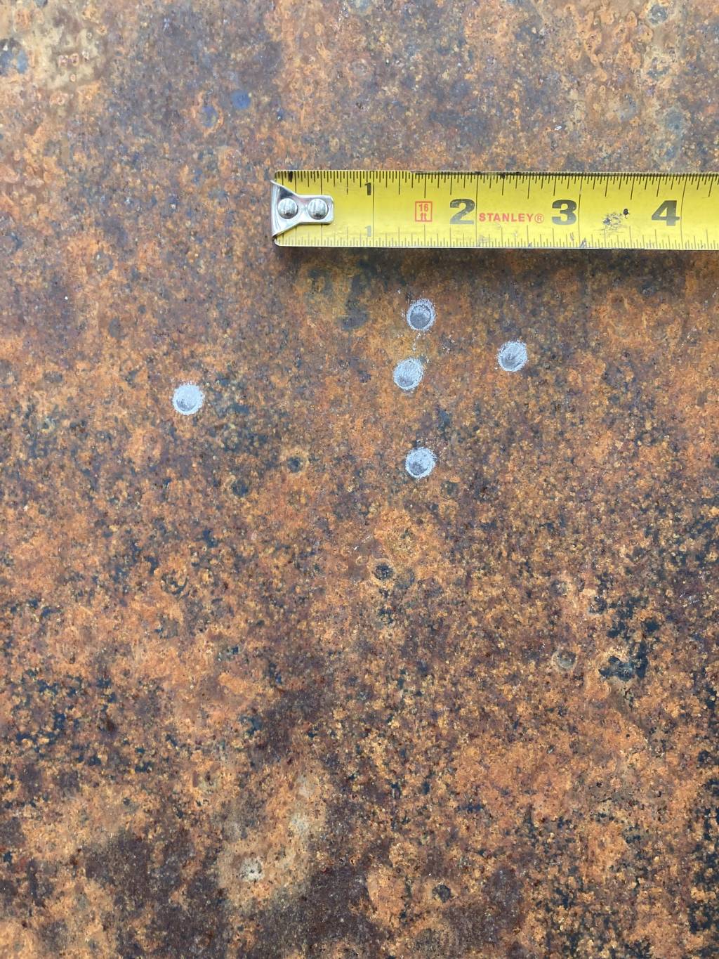

And while it hogs the air it is really accurate and a pleasure to shoot. Here’s my best yesterday at 100 yards. What I don’t understand is that I seem to be able to get good groups at 130 yards, but they don’t improve much, or at all at 100 yards! Maybe it means that I’ll shine at 300 yards lol! Don’t I wish!

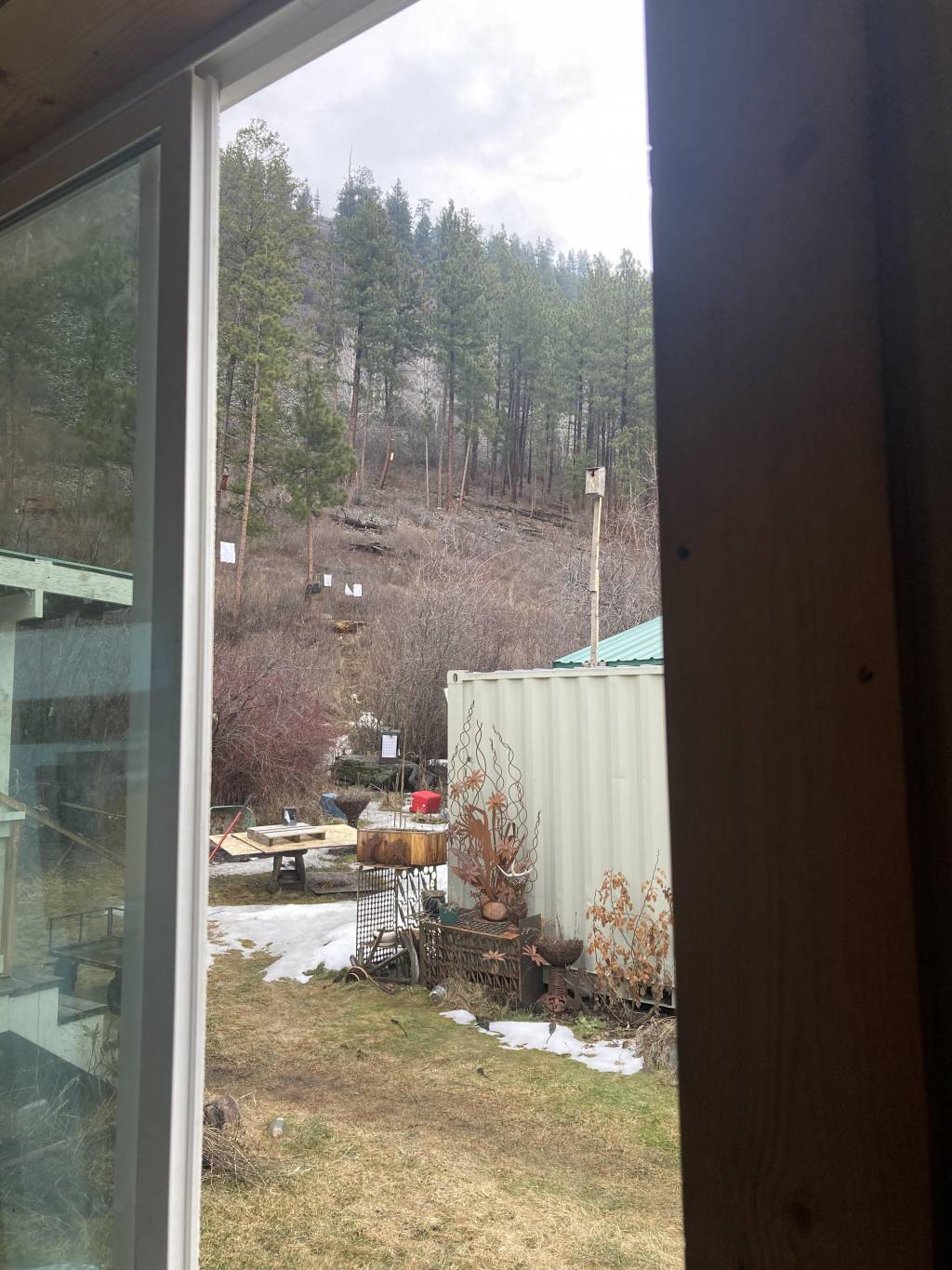

Love your back yard mountain range by the way.

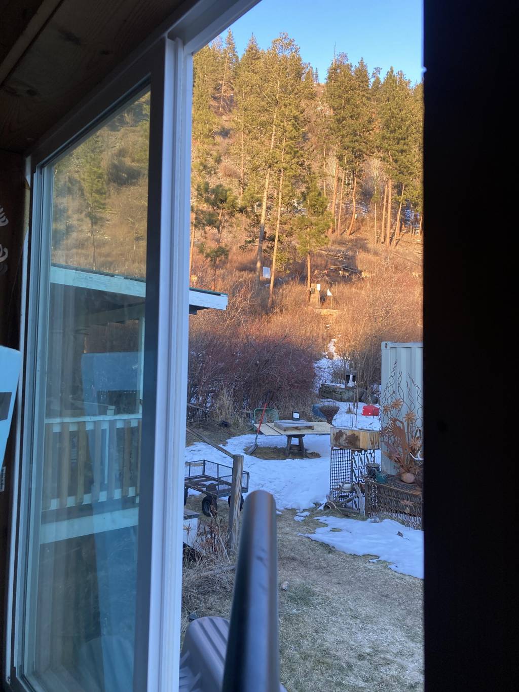

AZ said they would need more speed to stay stable, but my rapid likes the 13.73 so much I can’t bring myself to change the way Allen has it set up. I’m afraid that I’d not get it back if I tried tuning it for heavies lol! I don’t have the confidence for that, I got lost trying to adjust the ball bering trigger on my Steyr lg 110, and AZ walked me through it on the phone to get it back lol! I’m really lucky to have a shooting range even if it’s uphill! You often have to take a break while wildlife passes through.
