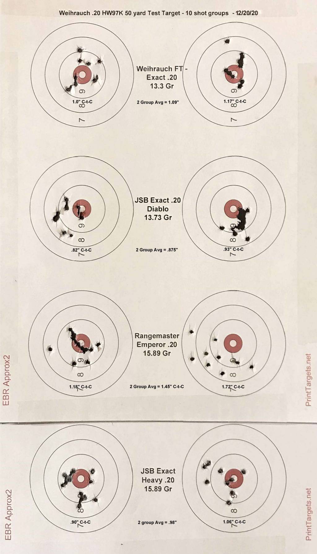

The accuracy results and the improved stability of the power plant were incredible. Four different pellets were tested at 18 and 50 yards. All performed very well, with the JSB Exact 13.73 proving to be the best match for this rifle out of the four tested.
See below:
