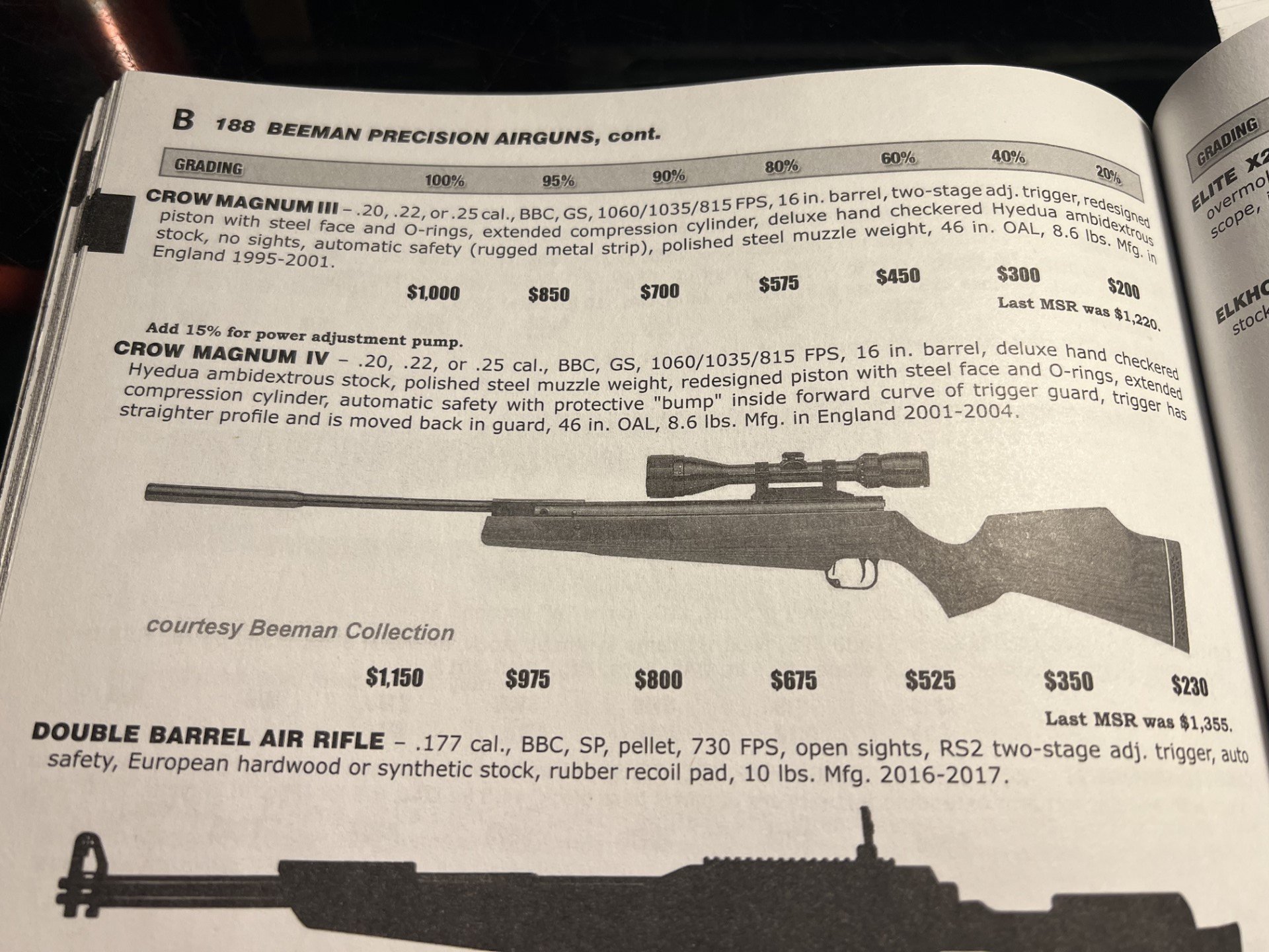

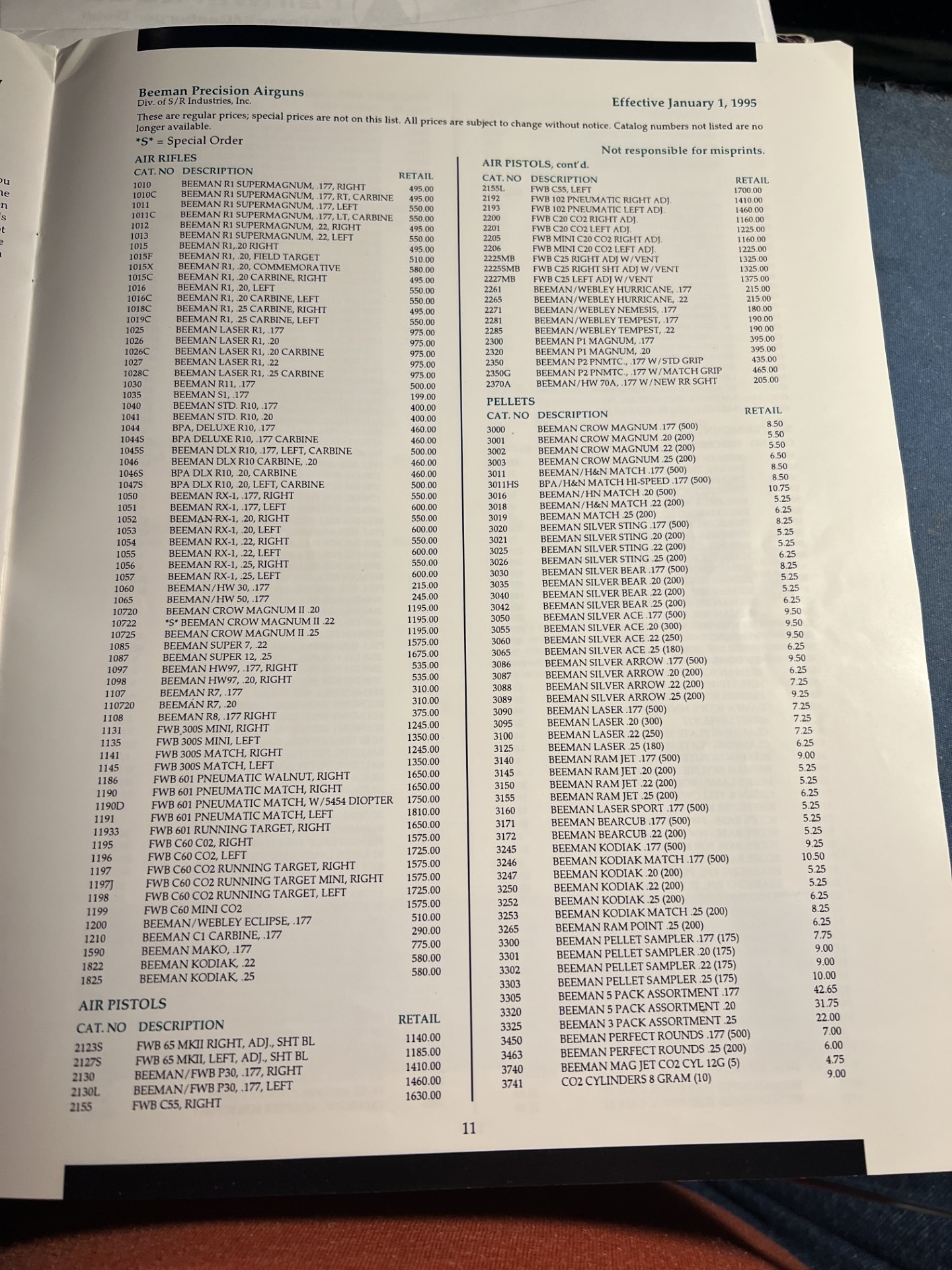

and these were expensive and still have a great value in the Blue Book
a Crow Magnum II in 1995 was 1195.00 all calibers
you will see that the trigger is different on your rifle the I-II-II had the same trigger but the model IV change to the flatter trigger and all this was found in a quick search
the model IV is worth the same as it was sold for retail today in 100% that is what the Blue Book says
because of price and the fact, they were so hard to cock i doubt that many were sold
View attachment 437675View attachment 437676
Hard to cock at full power is really underselling how hard they are to cock haha. I had to bury the stock into my inner thigh and crang it with both hands to get it down. Even at 24ftlbs its really no slouch and I cannot imagine most people would like it. 20ftlbs will probably be pretty easy though. Keep in mind that I'm 5' 7" and like 150lbs so I'm far from a big guy. That being said this gun really made me appreciate how great Sig did with the ASP20. At essentially the same power level the cocking effort is significantly less.
