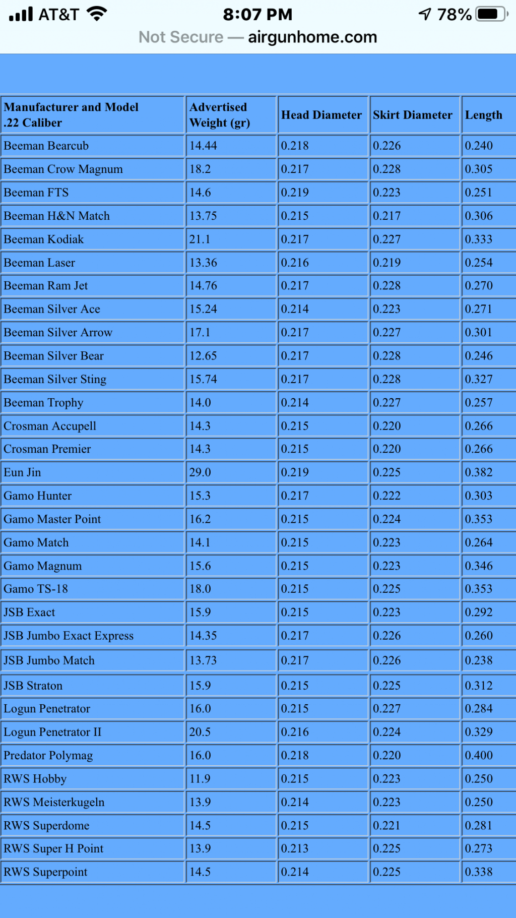

2 Tuned spring guns will only put 5.54 H&N FTT hole in hole
One is a HW .22 & I just found out it was tuned for 5.53's.
Other is a San Raphael R1. Now if it likes 5.53's great.
Weird thing is 5.52 JSB 18.13's hit way higher in line with the 5.54 zero. Guess they're too tight. Hopefully 5.53 is magic in R1 also.

My Huntington Beech R1 and Goldfinger Carbine R1 both like 5.53's and 5.54 FTT. Neither will shoot most JSB's worth a darn, except for the 18's, which have tended to group similarly (at 25 yards) to the FTT's - similar to JD's experience. Best group I've gotten yet was actually with the JSB 18's, but I need to shoot some more groups to get a better sample size.
The problem I've found is not only the bores are too big, but the chokes also too tight. That's a losing combo all around, you need a "big" pellet to seal the bore and make any power, but then it gets squished too much right before the muzzle. At the least it causes a smear of lead to build up at the choke.

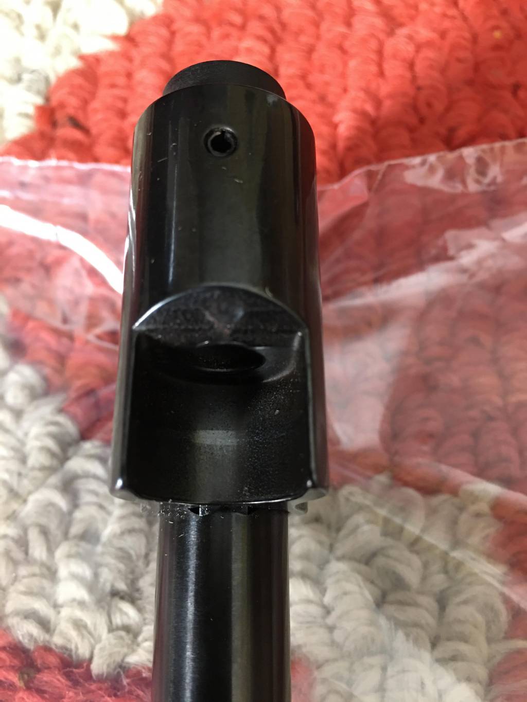

I'll show a picture but be aware I am thrilled with the seller. I knew this was a QC issue & most people wouldn't notice unless they used the irons or a laser/instrumentation. I'm not anything but GRATEFUL and just seeking information on perfecting a mass produced QC issue.
John Thomas probably noticed right away but being owner has a $800 Vortek on it who cares about correcting a front sight band off 1-2* so it's not like it wasn't disclosed. In fact seller is who saved me a lot of BS & let me know right away that he'd send 5.53 14.66's until I got some. That's what it was tuned explicitly for & does best with. I was getting hole in hole at 40 yards with 5.54's; but oddly JSB 18.13's hit way higher at 40. Think on that. Less friction from 5.51-5.52? Too heavy causing me to lift? Doubt that. My hold is solid straight back no torque & perfect follow through. I know Thomas tuned magnum guns and while this ain't no 25ft/lb .22 it's going to settle in from a hot 17 to 16-16.5ft/lbs if I know tunes & springers.
Any of my 7 extra scopes would fix this but I really want to get refined sights and Williams match micro click rear way on back to see if I can outshoot my other refined sights.
That band is hard to tell it's not true. Until you add the height of the front blade.
I then looked at spacing of under lever right before seating in the bottom of front band. Another tell tale sign it's the bands Dovetail cut at bottom that's off. Or barrel was pressed in canted.
77's and 97's unfortunately don't have the HW nut at breech for barrel.
Top sight too far right, and latch wear in shows It's to the left of radius's zenith. Conclusion is crooked band due to barrel being pressed in out of alignment. Not really that Dovetail is off.
I think the simplest fix is new Dovetail cut in when I get HW, FWB, Anschutz front globe insert & William's rear notch micro click.
Do ya think HW knows?
You could also just remove the latch, file off the dovetails, drill and tap throught the top for set screws, and press it back on straight. That way it's adjustable for how you like it and it solves the problem of the sights as well as the underlever alignment.
