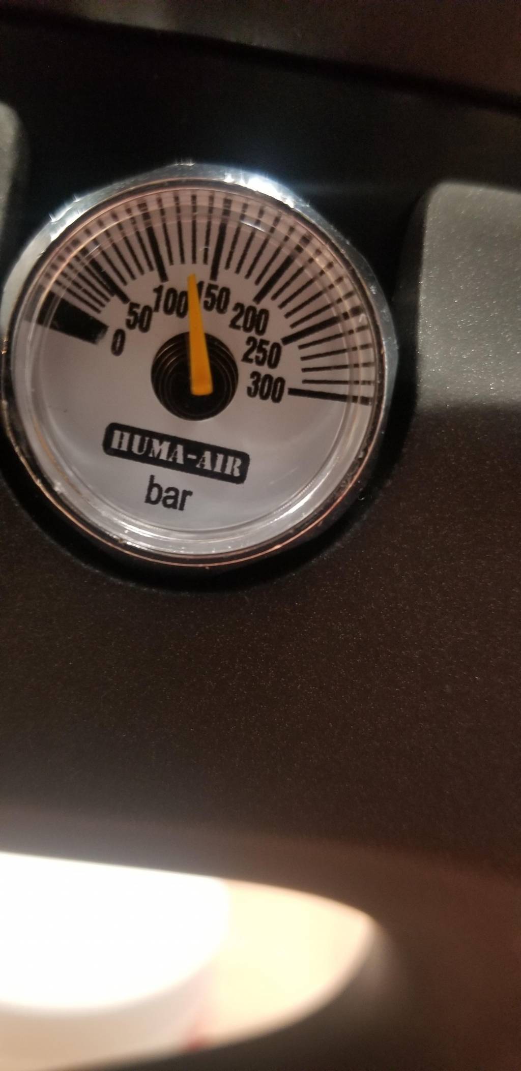

So I installed my new ernest rowe designed 2.5" plenum today. It went well except for a leak that was fixed by Installing the brown oring. By the way this is on a .22 mk3 sniper. So my pre plenum tune had my gun shooting jsb knockouts at 848 on power setting 6. And 880 on pwr 7. With the addition of the plenum per 6 is 890 and per 7 is 919. So a about a 40fps increase.
I also installed a huma reg pressure gauge that has a more precise readout on it. And my reg pressure is about 125

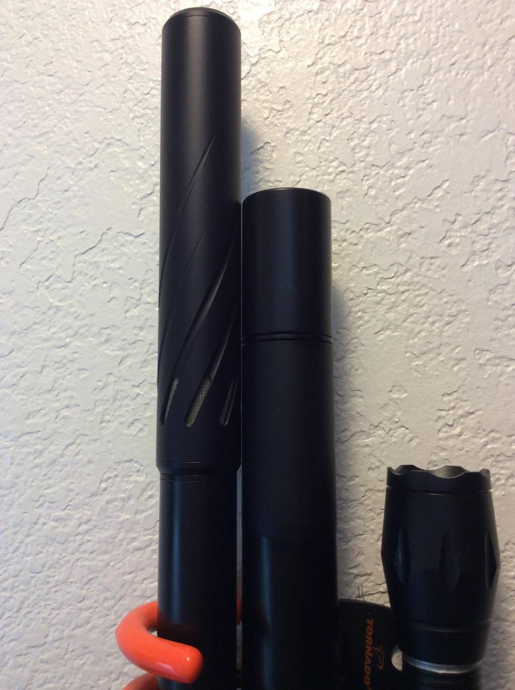

HUMA MOD 30 moderators will also perfectly fit the Wildcat Compact when using the Plenum extension

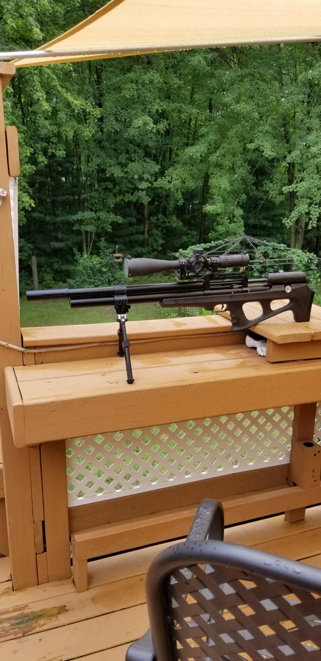

Hey joe I do think my cat is totally freaking awesome. I have made several timber tiger head shots at 67yds I really need to get it out to 100.
Mine absolutely loves jsb knockouts so that is mostly what I shoot. I would love to have this gun setup so that it shoots the slugs on one of the highest settings jsb hades at one of the lower settings.
I haven't been crazy about tuning and getting everything perfect because I knew I was adding the plenum and everything would change at that point. Now I will fine tune it in for those two. I really like the barrel band I just didn't like all that Flex in the barrel I do stand my gun in the corner out on the deck or in the house while I'm watching the yard there was a lot of flex now it's rock solid and I don't believe it hurt accuracy at 67 yards. I haven't been able to shoot any groups yet since I put the plenum on yesterday. yesterday was very rainy and windy here in Michigan.

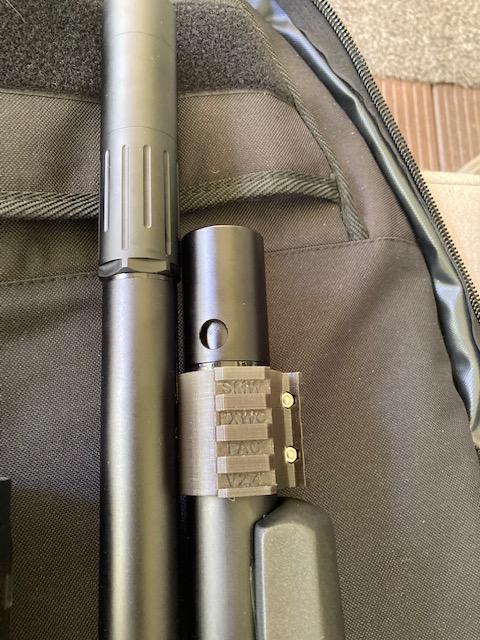

By the way for anybody who is interested in that smw Barrel band mine took six weeks to arrive.
