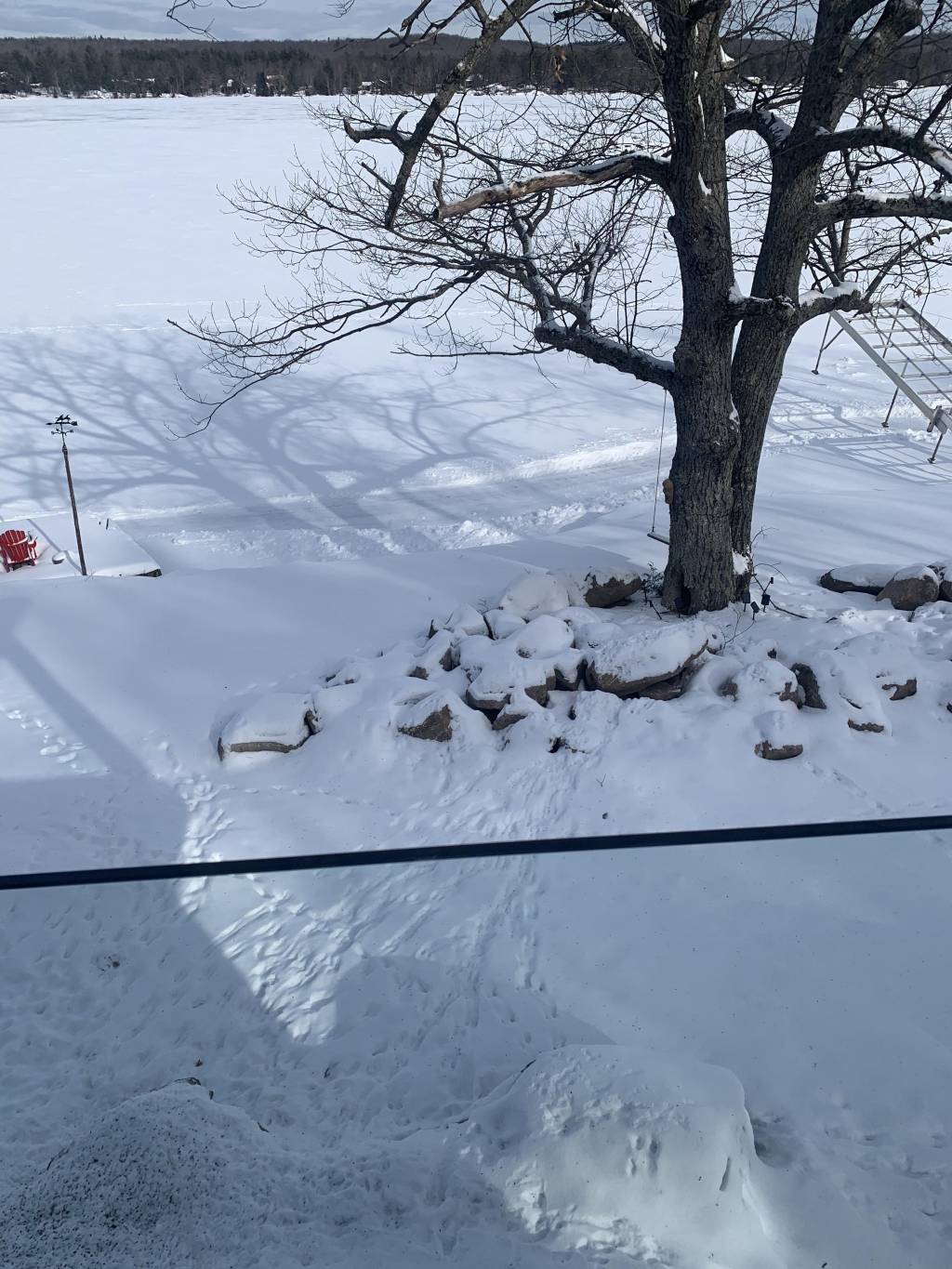

Another theory; I shoot from my deck which is 15 ft. down vertical when
target shooting. Now if Rocky is in the tree does the different angle change your sights?

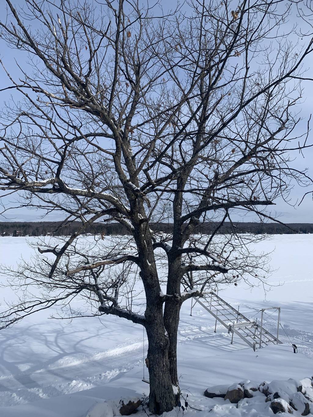

As someone stated above a steep angle will affect point of impact. The photo of the tree tells me you shot about level when you fired from your deck. If this is true shoot a few targets from the angle you shot at the squirrel and shoot a few targets from the down ward angle you normally practice at then compare the points of impact of both angles.
Throughout the day I grabbed 4 different guns, a 77,97,tx200 and lgu varmite,all sat idle at least few days. I was meticulous with the first shot on all, Your right they were all dead on. When I targeted where Rocky was they were high. there is about a 35° difference, as well the targets were 10 yards further than the squirrel.
I was aiming for his skull cap,my error. He is one lucky squirrel. Thanks for all the replies Crow
