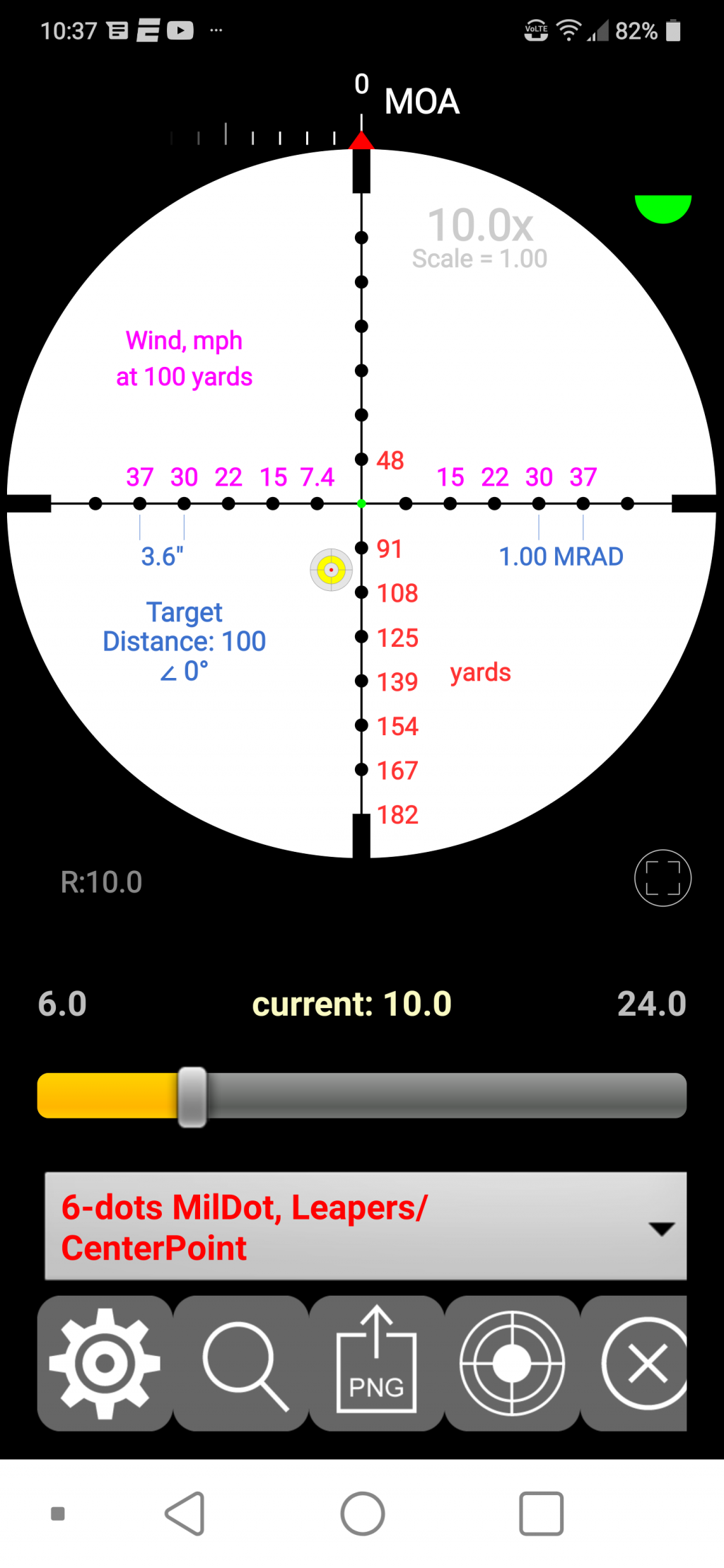

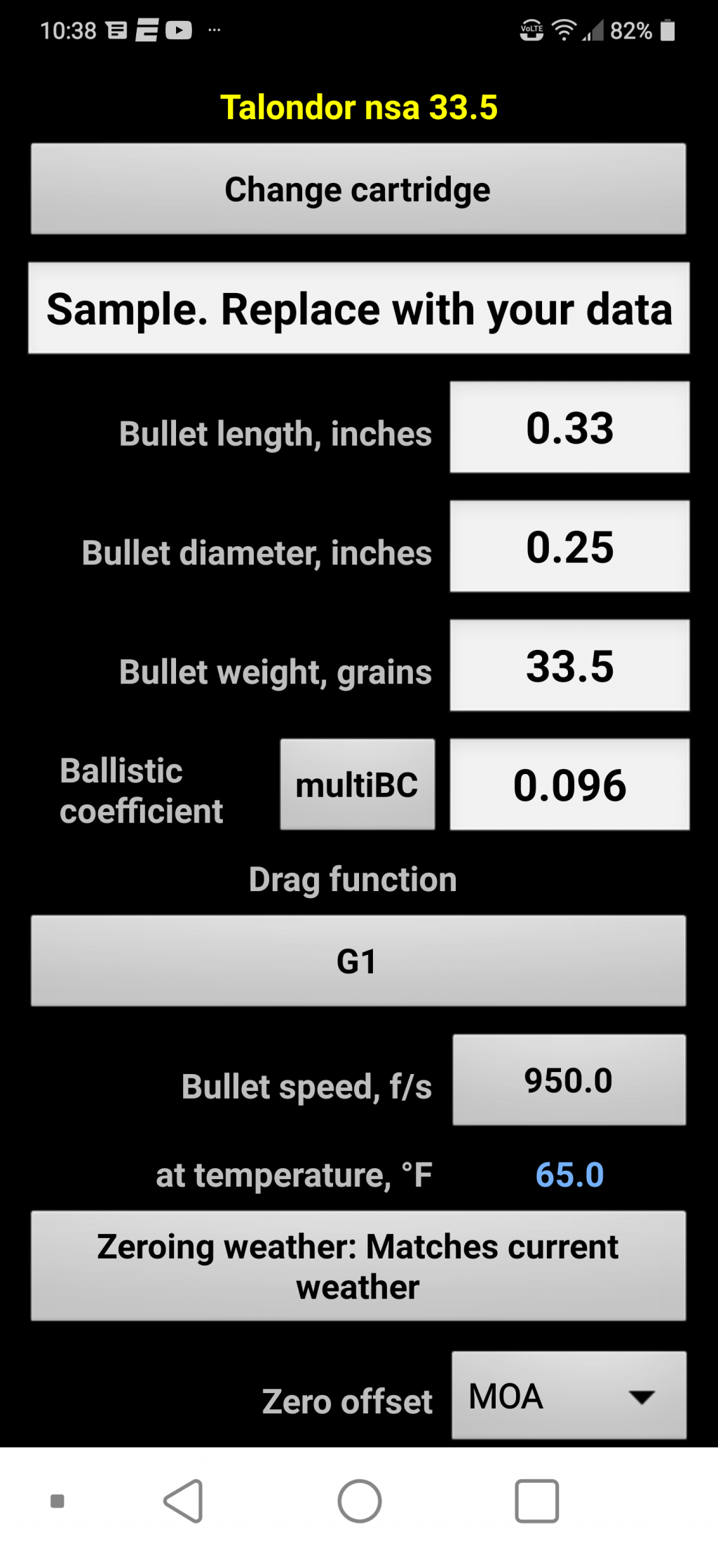

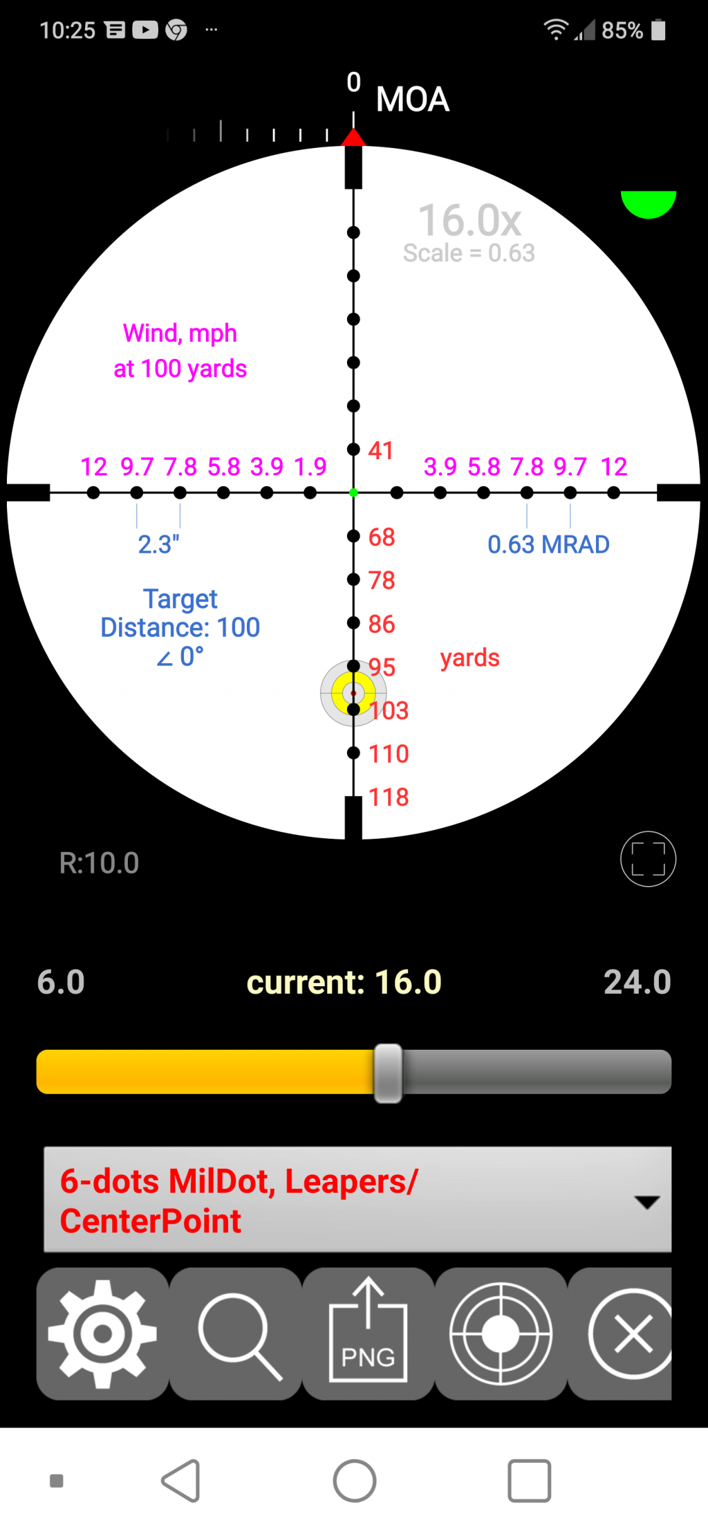

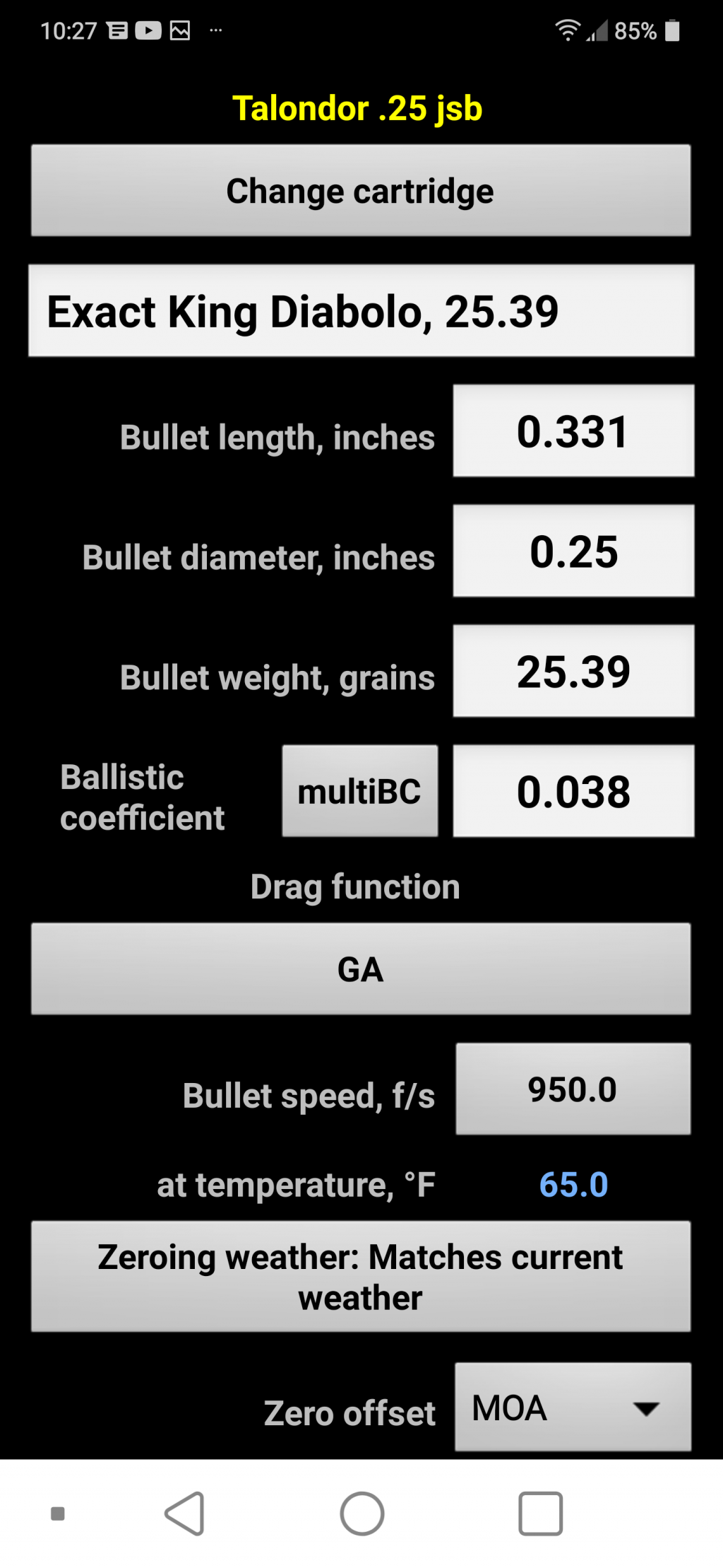

Reading the wind. This is a 5 mph crosswind and the effect on a jsb 25.4 @ 950 fps @ 100 yds.

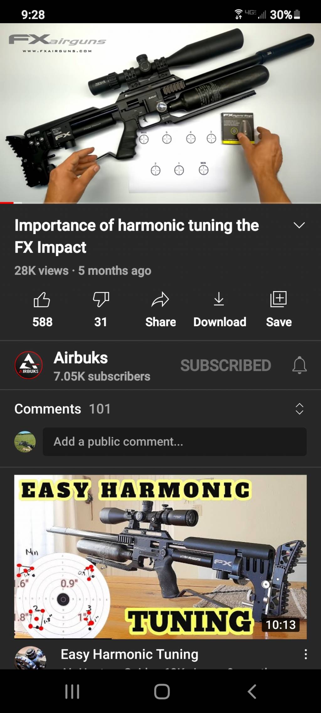

Try NSA slugs. I have been shooting NSA 49.5gr. Slugs out of my .30 Impact. They are extremely accurate at 50 yard. I have not been able to shoot them at longer ranges yet. I have been shooting NSA .25 caliber slugs for years and they extremely accurate so I imagine the .30 cal will be too ! Check out Airbuks or Airhunter Gerhard tuning guide on YouTube. The more air efficient the Impact is the more accurate it tends to be .

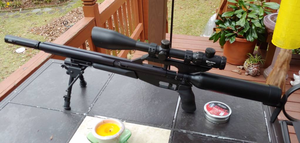

My .25 impact with 700mm slug liner often shot .5 to 1 inch groups at 100 yards and I have seen many others do the same so it's not like it can't be done. Mine is now a short barreled .22 compact. Shot thes one hole groups the first day out while tuning at 50 yards.
