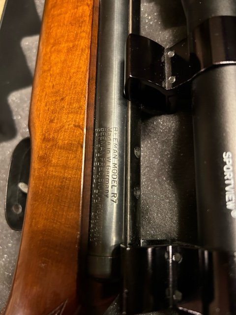

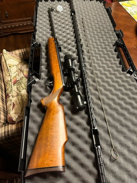

I picked this one up at a garage sale today for $200. Came with all the paperwork & Beeman magazine (Fall 1982). Has a Bushnell scope and brass cleaning rod too. I took it home and fired around 20 pellets at a 30yd. target. Cocks very easy & only seeing 400ish fps w/ 7.9g CPHP...
So , did I pay too much? What will it take to make this a shooter at 30-50yds?

Probably does need new spring and seals (it's 40+ years old after all!), but try diff pellets. In my experience Weihrauch barrels are pretty indifferent to Crosman pellets.

The Bushnell Sportview airgun scopes are pretty good for the money. Yours doesn't seem to have AO, though. Beeman dealers carried the AO version as a reasonably priced alternative to the Beeman scopes with the gaudy blue (not ever a fan of that 😝) paint. There was a 4x version with blue paint slopped on it (too bad you can't get that off). Sorry, fan boys, but the RWS Hakkos are classy.

Nice find! They are indeed nice shooting guns, but yours is definitely down on power. Probably due to a smooshed breech seal, deteriorated piston seal, and dried out gummed up grease.
I would stay away from the Vortek stuff personally, especially in the R7, as it will increase cocking effort and likely give you problems with the metal sleeve on installing it.
Go with Air Rifle Headquarters if you want a kit for it. Snag a new breech seal from somewhere too.
