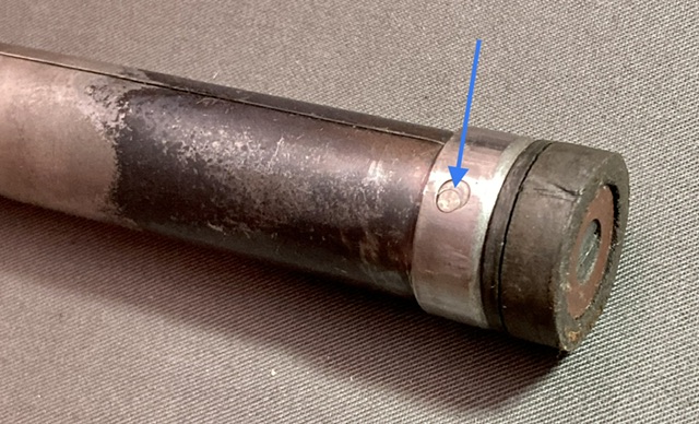

This piston is from a model 27 made in 1970. Note that the screw securing the seal has a blind stake rod (arrow) to keep it from turning. To get the screw out, you have to torque it hard enough to shear the rod.
