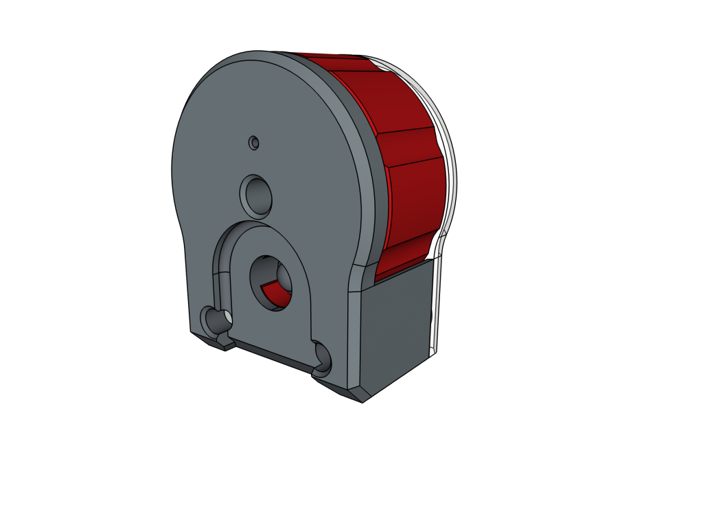

1911 PCP concept

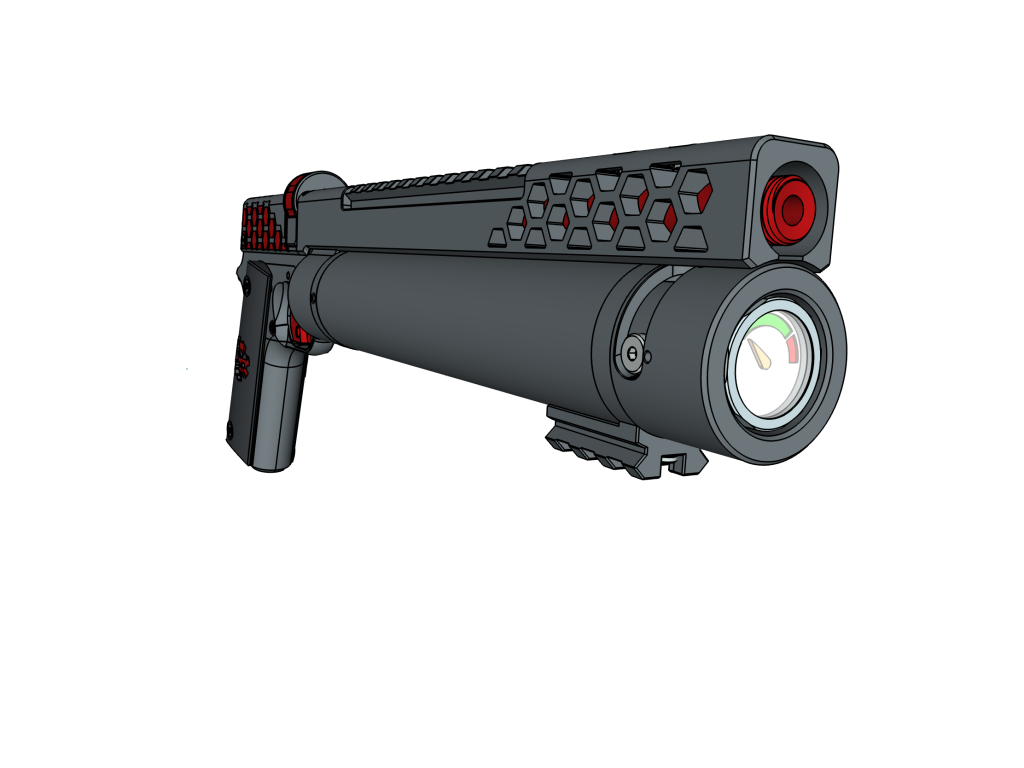

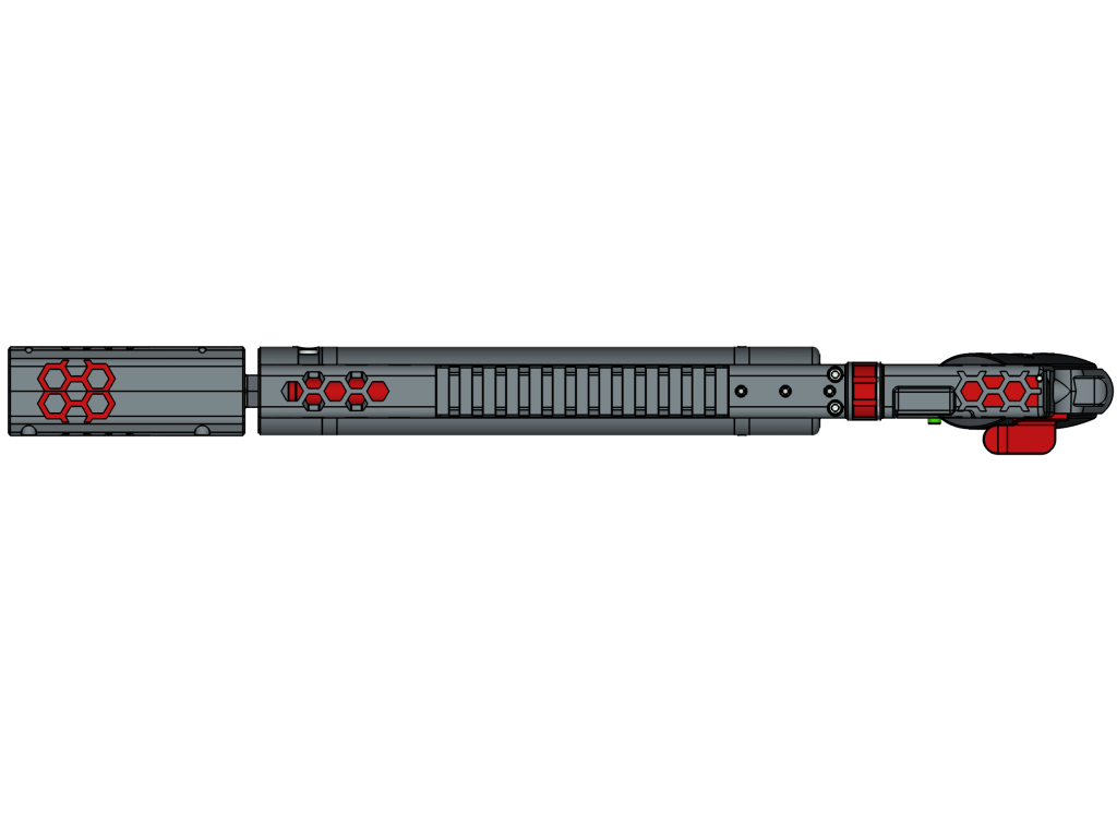

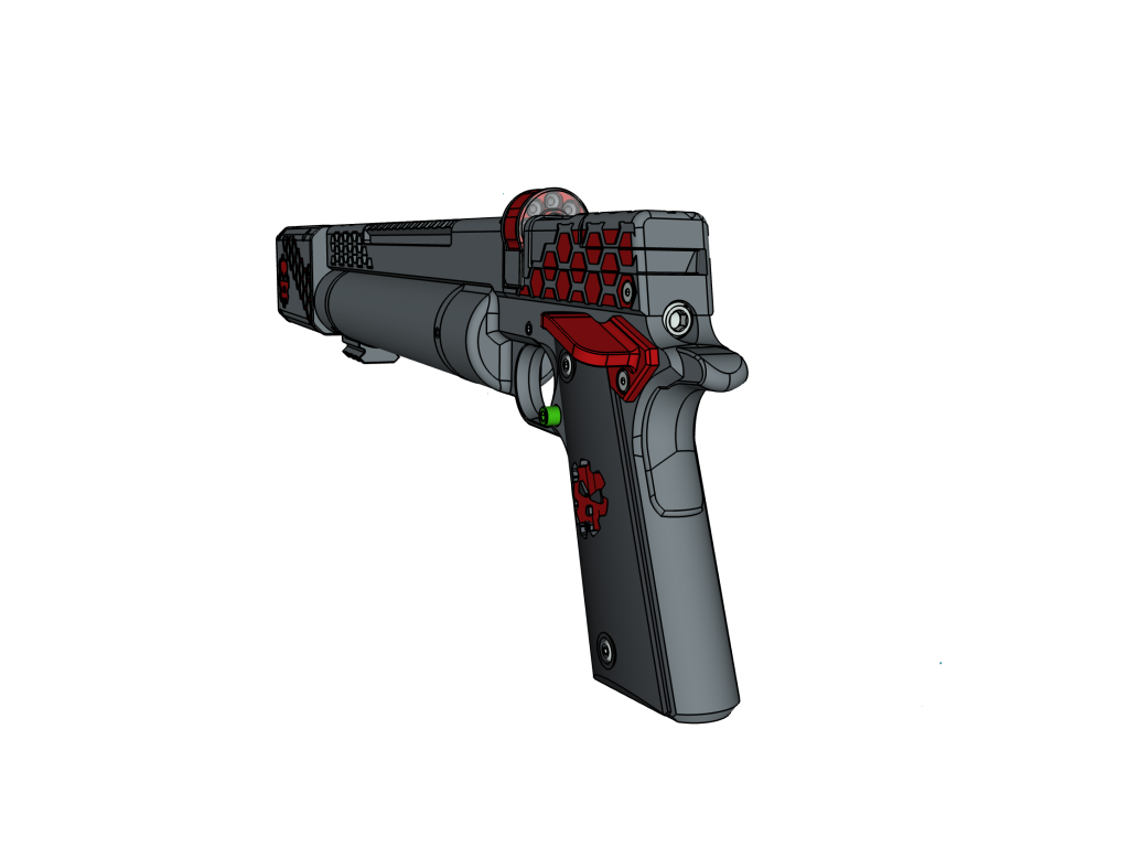

Please send me your feedback about this design. I want to start build the prototype, but need be sure if the design is sexy.

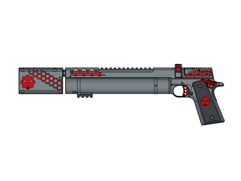

Shorten it,looks too top heavy,butt if keeping that length,why not add a bottom "hold handle" for two handed shooting,Yea please do that and it could be even longer...remember for good shooting it is function over form,butt you can combine both with your concept pistol...heck make a butt accessory for it to......yes it could be a really kool pistol.

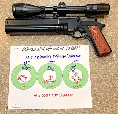

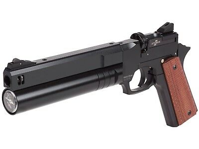

The pistol has the same dimensions of Ataman AP16 Standard (14 3/8”)

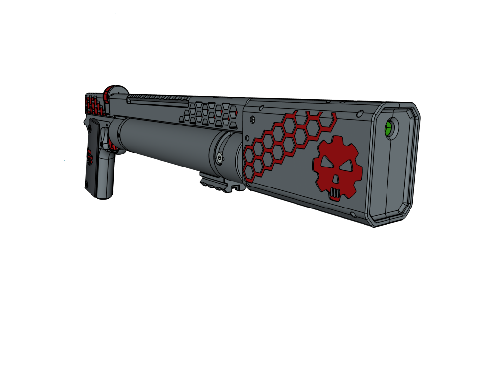

The suppressor is made of Aluminum using nylon monocore.
the total weight is <= 1kg plus the suppressor

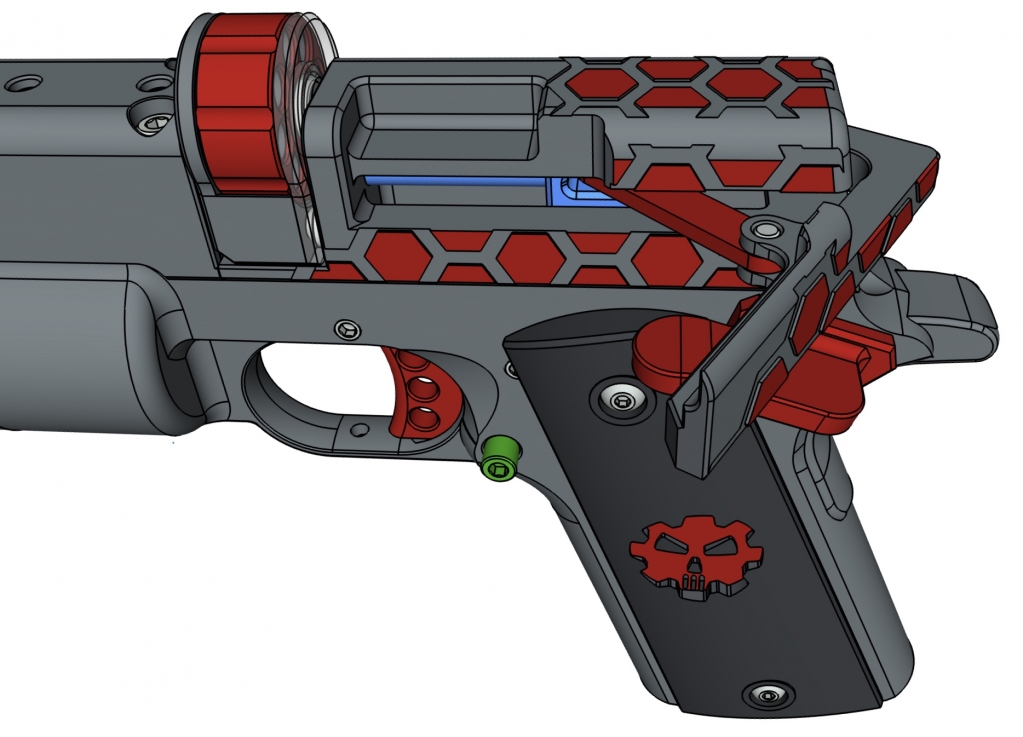

I use a lever because is easier to compress the spring that use to impulse the hammer that hit the valve pin. The slider could be more difficult to do it. I do not want to be a semiautomatic airgun because I want to approach the total air to push the pellet and get a energy of 25-30 ft lbf

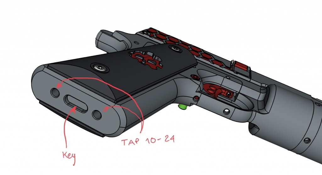

In the bottom area of the grip has a holes to attach a stock. I am working in the design.
