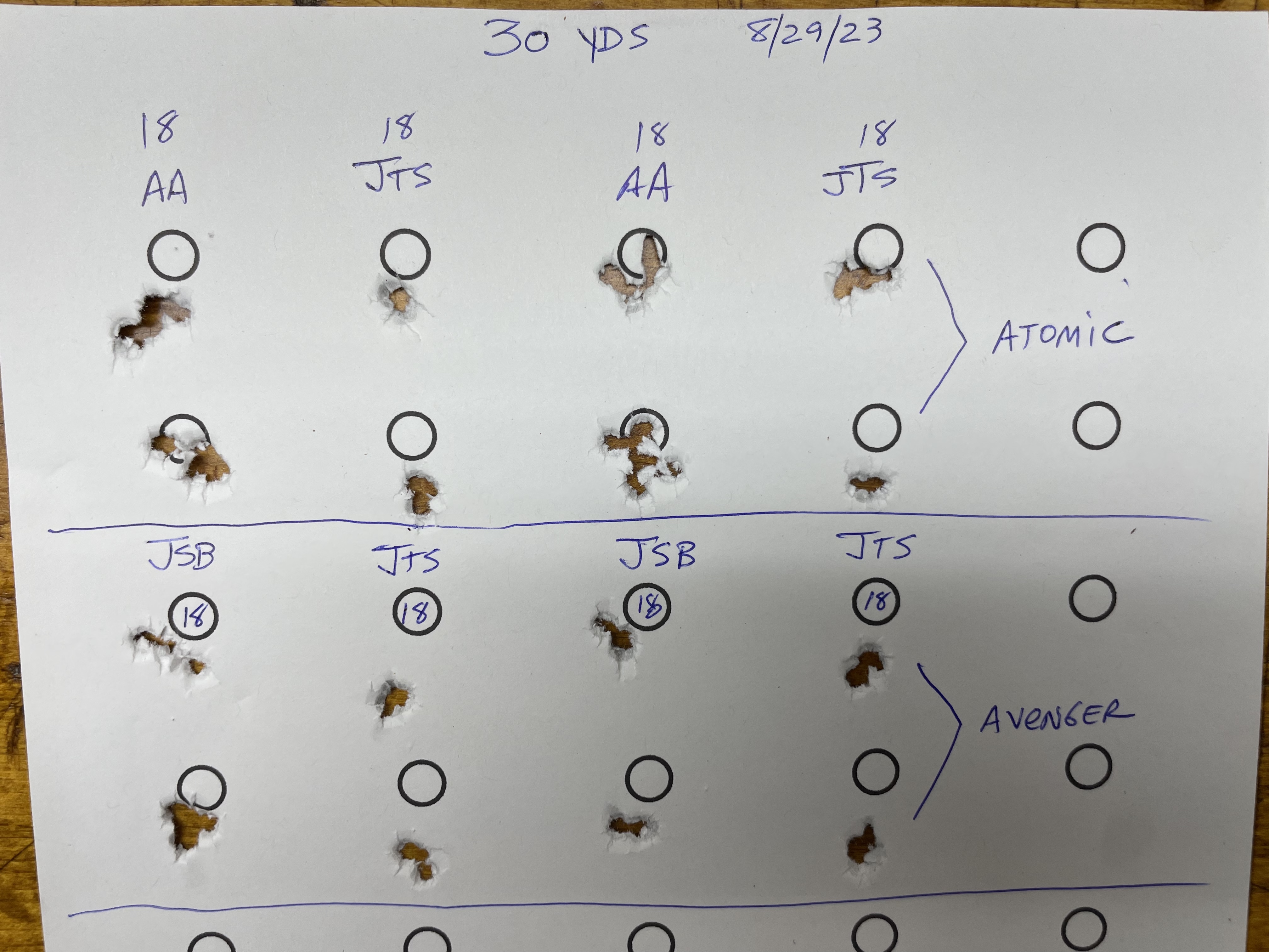

I received some 18 grain JTS pellets at the recent PAC so I compared them in two different rifles today. My Atomic likes AA18s while my Avenger likes JSB18s so I compared them to the JTS18s. With my limited time shooting today it seems both rifles shoot the JTS 18s a tad more accurately, at least at 30Y.
How many shots in each group?
