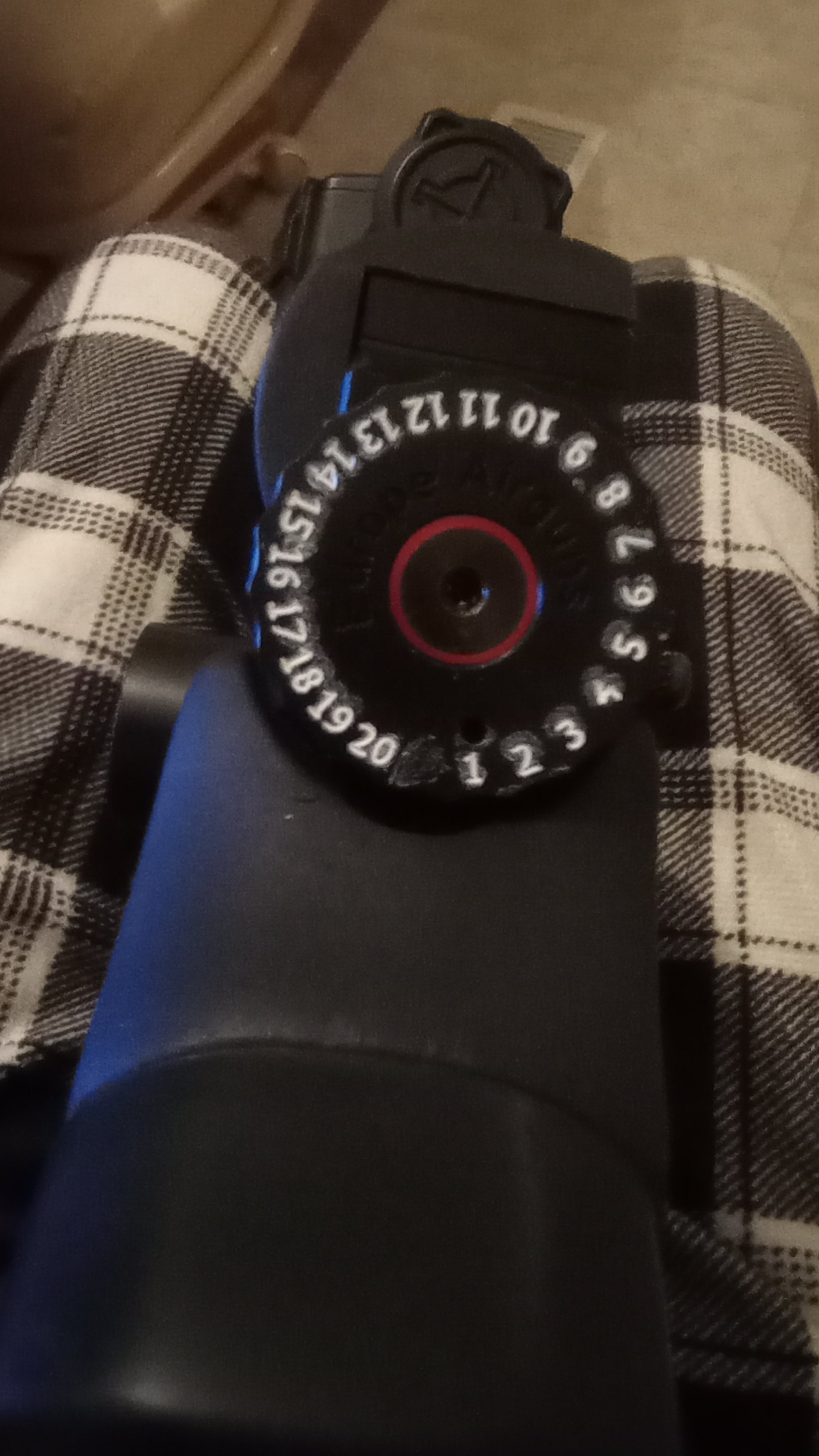

I did notice this......i couldn't find a 600 stx liner for the wildcat....so I had to buy a complete impact barrel in .177.....the extra runway helped...evn my dumbass cud see that.....so outa simple curiousity i flipped it to the dual flow port......gun settled way dwn..speed went from 900's to 1050 fps.....(im deaf so i gota tune with the shroud off just to hear the difference)...I started at 1050 n subtracted my 3% and worked down from there....at 5%...990 ish....thats when it started hitn what i was aimimg at........But I cheated...I put one of these Euro power wheels on....n i dial 10/20 fps without havin to get that allen key out to adjust hammer spring tension......impatient & lazy paid off in this case.....i love that adjuster
