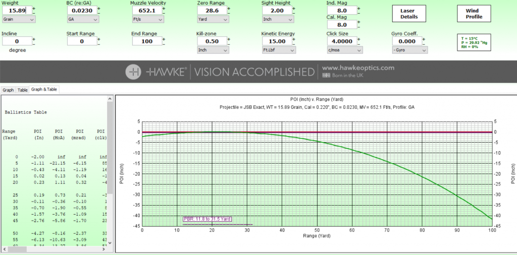

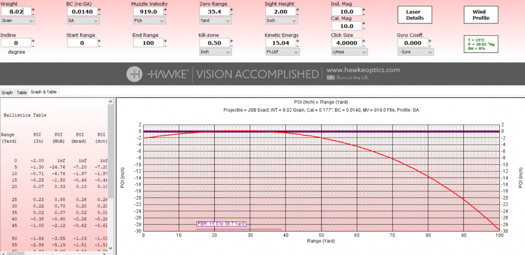

I ran these in another thread for Polymag shorts in 177 and 22. That may have been for you in the other thread you mentioned. I'll post them again in case it was a different thread.
I kept power consistent for both calibers at 15 FPE. Used the same scope height and optimal zero for both calibers. 1/2" kill zone.
177 had a point blank range (PBR) of 15 to 38.7 yards or a 23.7 yard "flat" zone with that scope height.
At 50 yards the 177 Polymag short drops 1.86".
22 had a PBR of 11.8 to 31.5 yards. The flat zone is four yards shorter at 19.7 yards.
At 50 yards the 22 Polymag short drops 4.27".
Do note that Polymags don't have a high ballistic coefficient so there are similar weight pellets that will perform better.
Like I mentioned in the other thread, I like heavier pellets at my current house as the PBR plays nicer with the variety of distances I find pests at. Most importantly the closest shots are right in my PBR with a heavier pellet. I can just point and shoot without hold over or hold under.
In the above case both projectiles require hold over at 50 so I don't particular care how much it is as I still have to have a dope sheet for both. In general I don't mind taking my time figuring our holdover for longer distances. But those close shots I just want to aim and shoot so heavier pellets work better for me currently.
