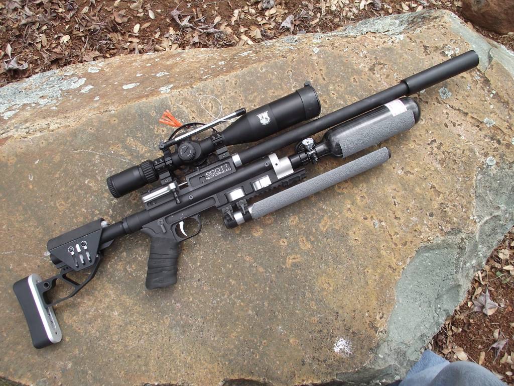

Built one up myself a bit over a years ago. NSA 15's @ 1040 fps or JSB Beast 16's @ 980ish
VERY very accurate .. tho like any .177 wind is not your friend.
Picture from a few years ago when rifle was a FT prototype tester ... sense then fitted with a full length LW 12 groove standard no choke .177 barrel & different optics.
Rifle otherwise identically looks the same ... Has a balanced valve of my own design in it, custom hammer & SSG etc ... Very custom internally.
Scott S
@Motorhead That is a fine looking rifle. What’s the silver rod on top of the scope?

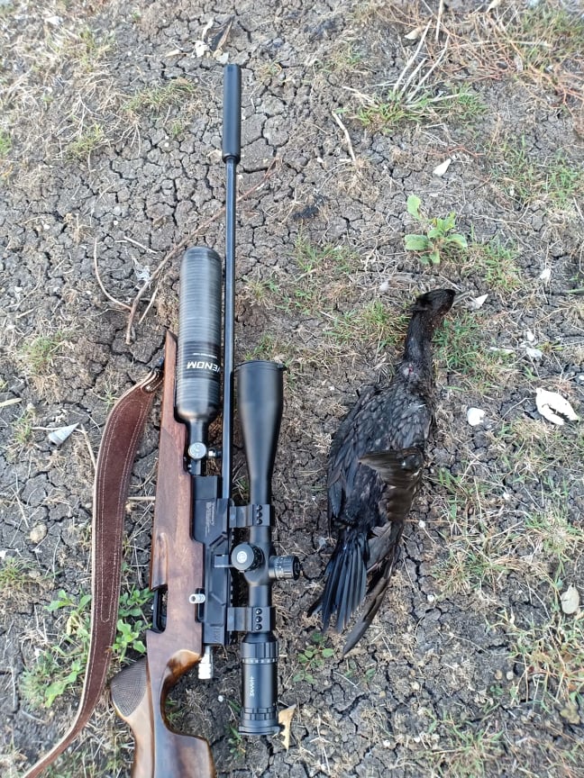

I think the wind aspect is true, shooting slugs today, the 13.43 KO was a bit better than on Wednesday, and the 15gr NSA ones i also tested today was not too shabby either.
Sadly i got side tracked by the Beasts in my pellet box, and as in the 600 mm barrel my Maverick do like to shot those on 50 M
Even tried Barracudas too, but they dident get to anything really sweet with the few things i tried today.
Even if i get updates to my slug gun this week ( among that 2000 slugs ), i think i will grab the V3 on the next outing and do some pellet shooting with that. ( fairly moderate winds forecast for Wednesday )

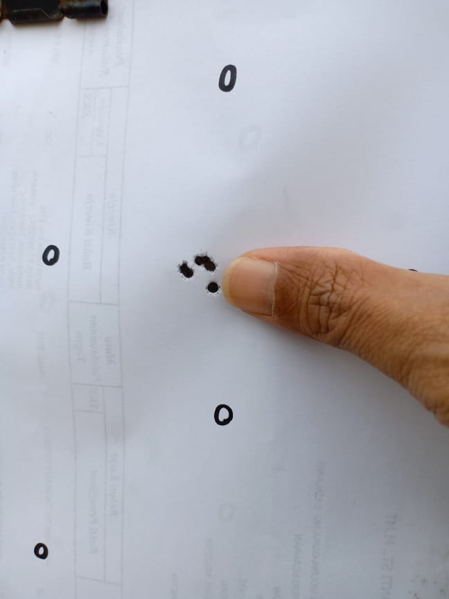

Impact MKII 700mm OEM Barrel kit, reg set at 90 bar, JSB KOs 13.43, could not get a chrony today, but the NSA15s were at 920 fps at the Max hs setting, the same setting I shot the JSB KOs. Could not tell you if the hs is factory, probably not. Getting great groups at 101 yards today, under an inch. Hope that helps.
