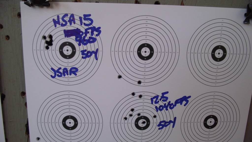

I purchased a LW standard .177 barrel and machined it to fit my flashpup. The NSA 12.5 slug shoots
best so far. ( around 1" at 50 yds.). Tried about 5 different Griffin slugs, not good. Read where the poly
barrel might be better but they like high fps. I'm shooting the 12.5 around 960 fps. Found out this standard barrel loves the Air arms 10 grain pellets.
Also looking for a rifle that will shoot the .177 slugs well, Red Wolf a little over my budget.
That is threw an LW standard "choked" 17.7-1 barrel. 10 shots BTW
Sense then using a Un-choked and it does a tad better yet with NSA's
