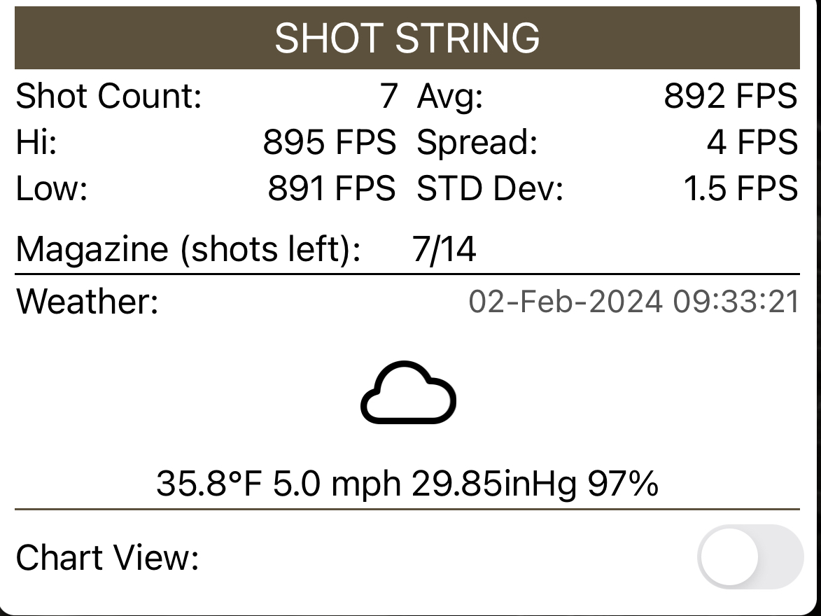

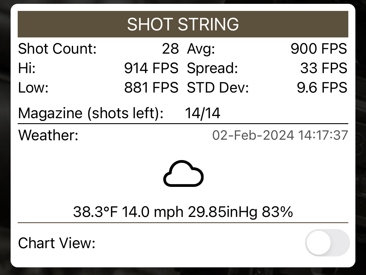

I’m not sure if this will help but here goes anyway. I recently had my Akela .177 upgraded by airgun revisions drop in hammer spring kit. When Rich was done, he did a chrono test and it was shooting 950 fps with an SD of 1.5 with the AA 10.3’s from a 3000 psi fill. This from an unregulated gun.
Yesterday I tuned it down to an 890 range with the 10.5 gr Benjamin pellets and it was still a 1.5 SD at 892 avg fps 18.x ftlbs. All I had to do was adjust the power wheel and that took only 7 shots. I then ran 28 shots for an SD of 7.7 and 880 fps. This was done while the gun was acclimating to the outside temps. Started at 68 degrees inside to 36 degrees outside.
Then I shot a two mag string with the AA 10.3 gr and 28 shots ran a 9.6 SD at an average of 900 fps. This string was after the rifle had acclimated to the 36 degree temps.
I can only imagine that the gun will be very consistent once my usual shooting weather arrives.
I know your question is about the regulator, but, maybe you don’t need a regulator?
