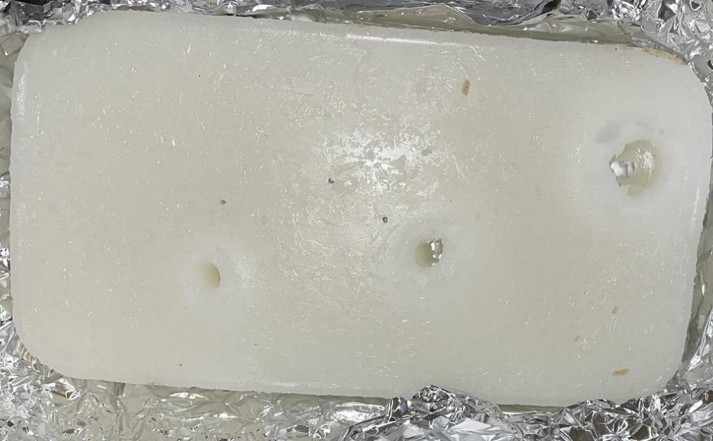

Playing around with this wax block I still have, its Parafin wax mixed with mineral oil 50%. Shot it today with 3 types of ammo in this order: Kvintor Gamma 3, JSB Hades, and finally the 10.03gr knockout. All are in .177.

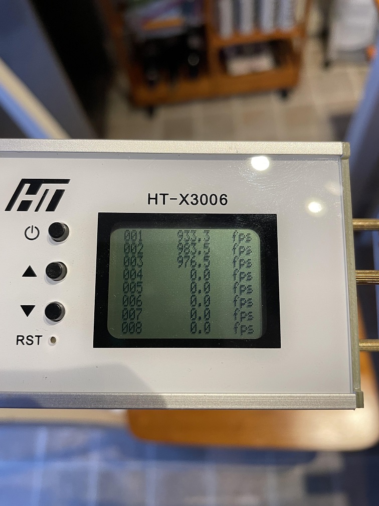

Speeds are in the order of shooting. My Avenger always shoots the first shot a little hot due to regulator recovery. So that 933fps is a little fast. I'm surprised that the hades is faster than the knock-out even though its heavier. This is most likely due to the amount of bearing area on the knock-out slowing it down.
Entry holes:

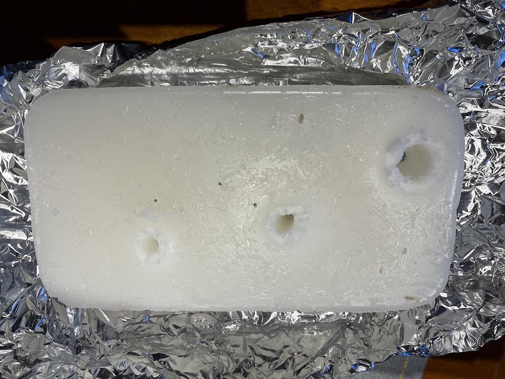

Exit holes:

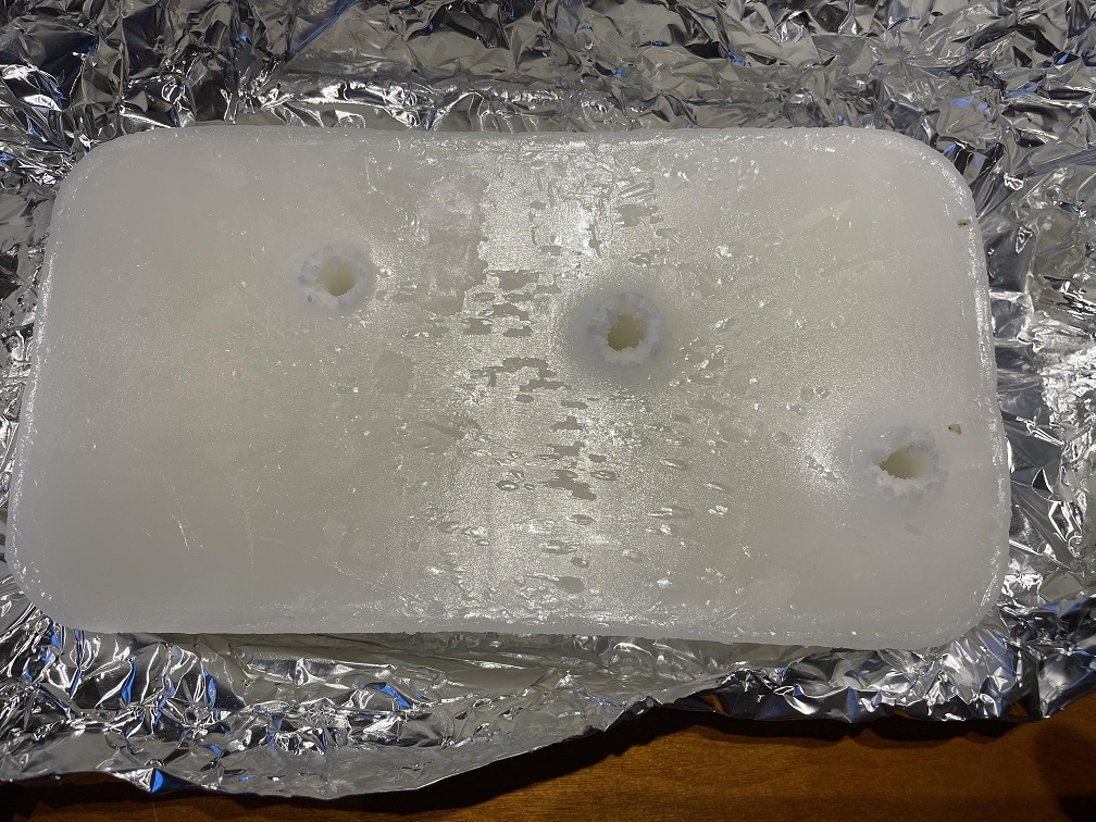

Little bit different pic of the exits:
The range was very close in my tiny back yard.
This is the first time I have shot the Kvintor Gamma 3 which is 12.3 grains. It is a pointed design. This pellet made, as expected, the smallest exit hole.
The JSB Hades made only a slightly larger hole.
And of course, the Knockout blew a huge hole out!
