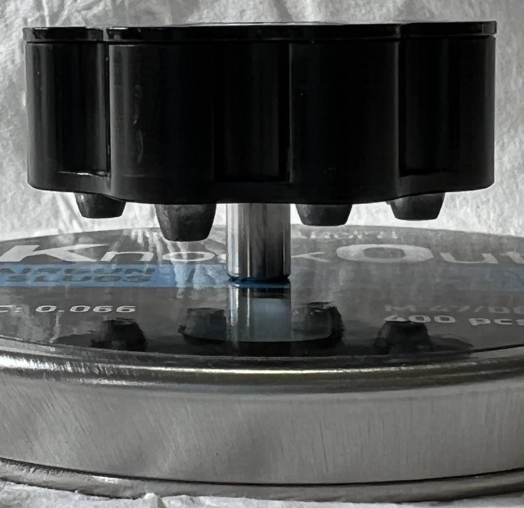

Good news, the JSB KnockOut Slugs fit into the Leshiy 2 .177 magazine and do not fall through the magazine. The slugs do however protrude about a third, out of the barrel end of the magazine.
When the gun is held with the barrel pointed downward, the one slug that is aligned with breech, protrudes into the breech of the barrel, will prevent the magazine from being manually rotated. Holding the gun with the barrel pointed upwards, all of the slugs will fall to backplate of the magazine, then the magazine can be freely rotated manually.

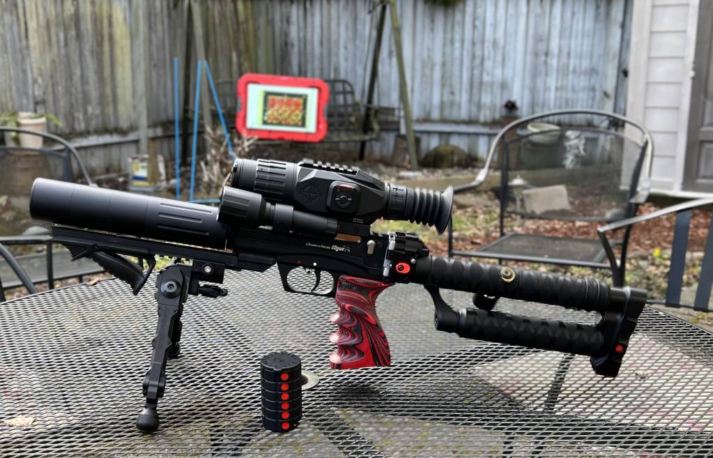

I only use my L2 for backyard pest control, so I cannot comment on how well the KnockOut Slugs perform beyond 10 yards.
