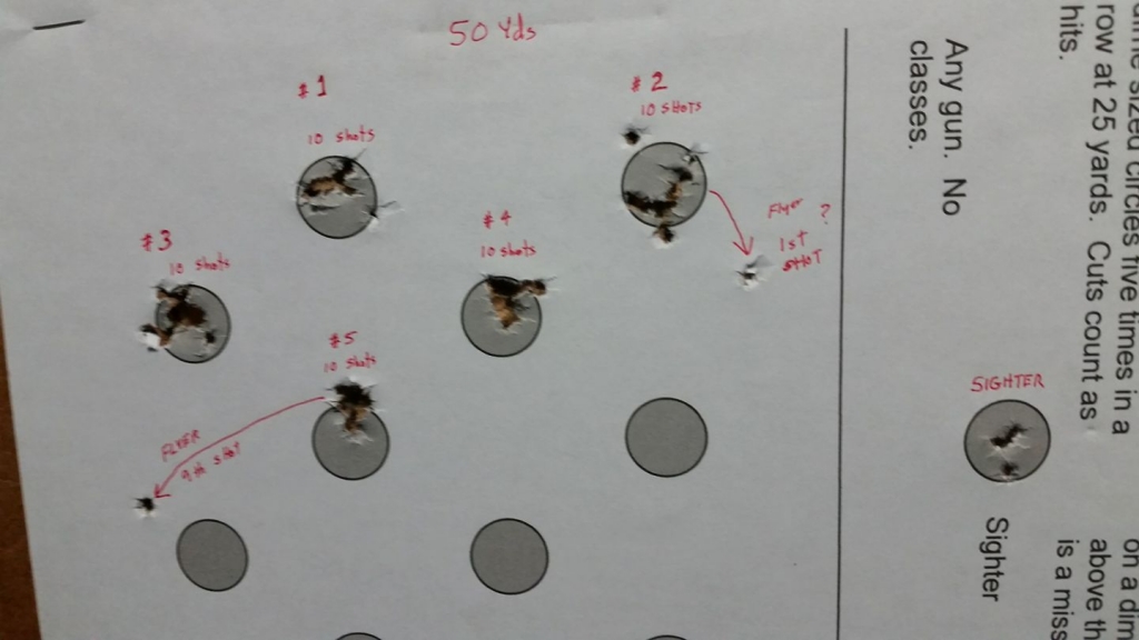

My Thomas w/polygon barrel and my Logun w/ LW barrel love the original .177 JSB 13.43 pellets. The redesigned not so much.
https://www.airgunnation.com/topic/three-gun-battle-at-28-yds-dirty-barrels-vs-clean-barrels-etc/
