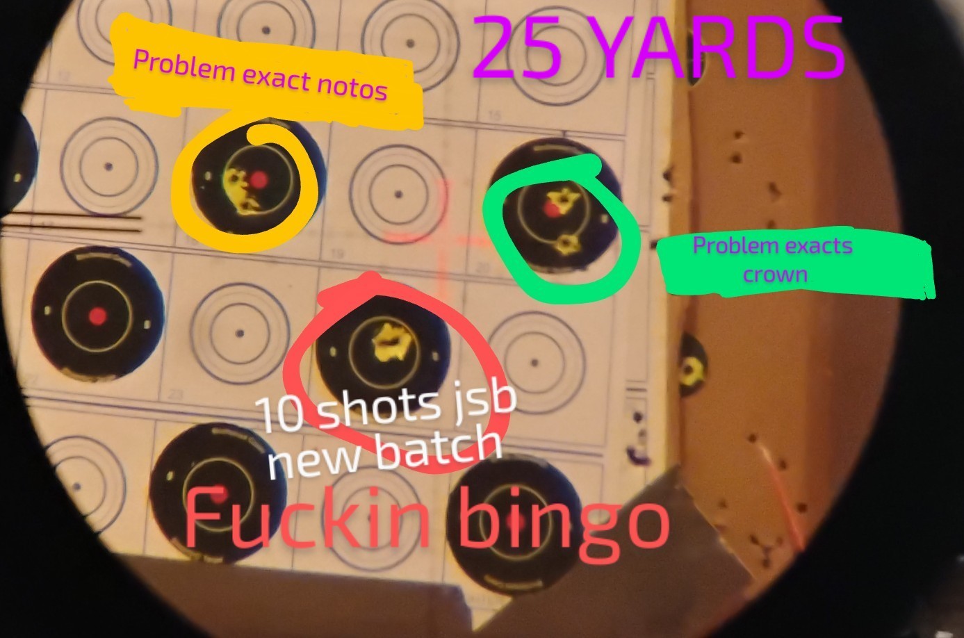

I've been shocked by how bad some tins have arrived. Chattered up skirts, crushed skirts, gashed heads. But when they're in good shape, they just go thru the same hole more often than not. Like a magnet for the crosshair. This is the first and only time I have had issue with JSB.
