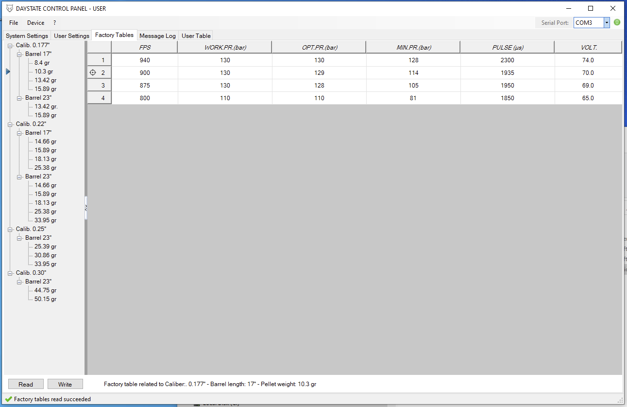

@Ed24 - you have to choose the .177 17" barrel in factory settings in order to get options for 8 and 10gr pellets. I've never really understood the option for 15gr for the 23" 177 barrel - where are those pellets found?
Personally I prefer the Advanced settings screen and using the USB programmer with the app to setup individual rows for each projectile and speed. It makes it much easier. Not a huge fan of the chrono feedback process as neat as it is.

You might find this table of the factory tables useful:
Reactions: dgeesaman and Ed24
