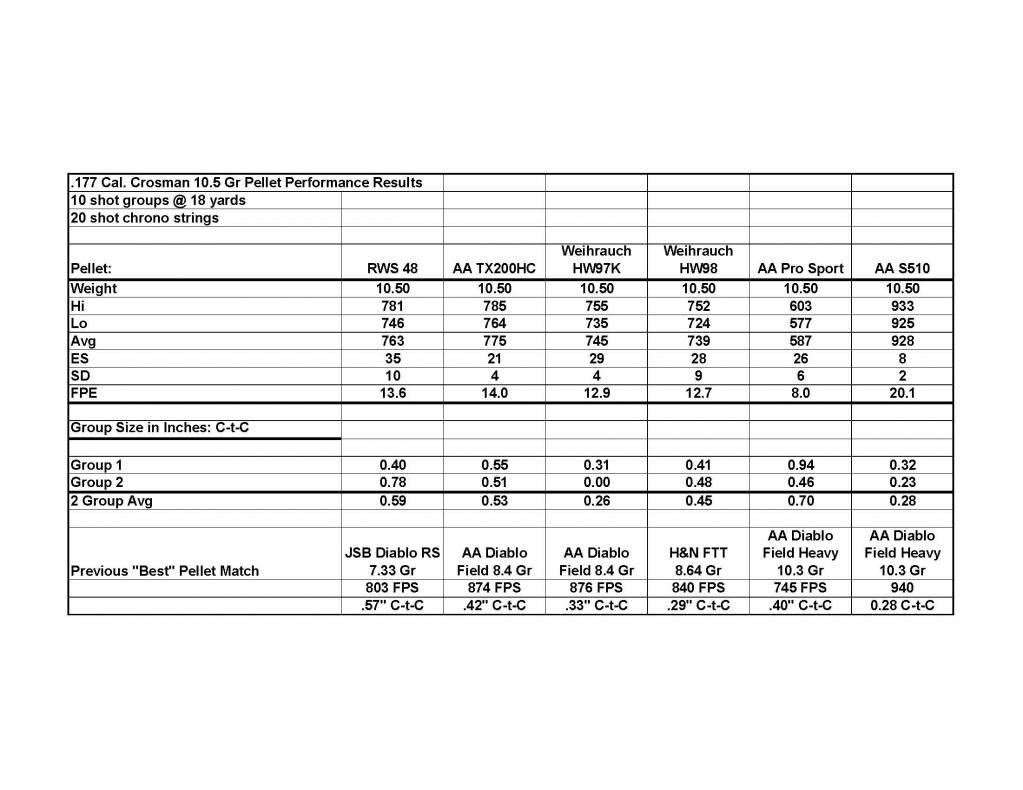

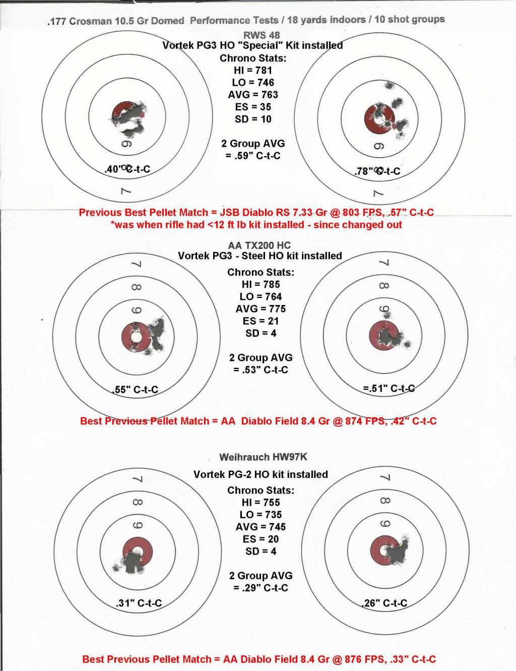

I had never shot this pellet, so decided to test it across all of my current .177s in the vault. I shot the pellets to determine their consistency in terms of statistical deviation and group size, not POI. The results can be found below.
Of particular interest, the pellets shot really well out of the Weihrauchs. Not really a surprise when they fit so perfectly as they went into the breach - not too tight, not to loose, just comfortably snug. Several duplicate chrono readings occurred. Note that the Weihrauch 97K, 98, springers, and the Air Arms S510 PCP, shot extremely great groups. So good in fact, that I followed-up with the 97K, making the Crosman 10.5 Gr its new "go to" pellet.
