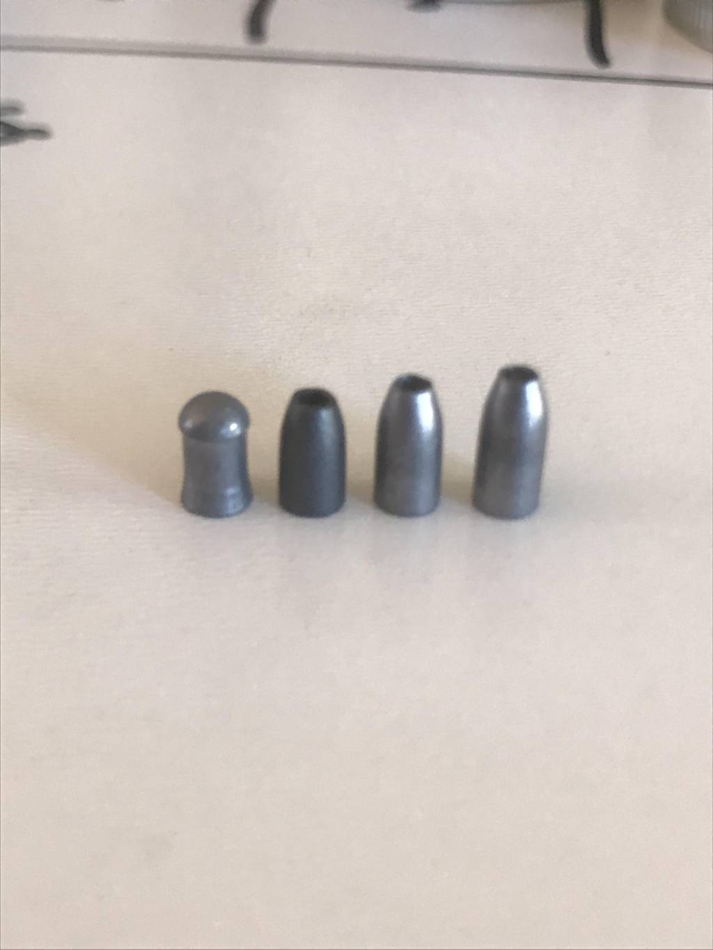

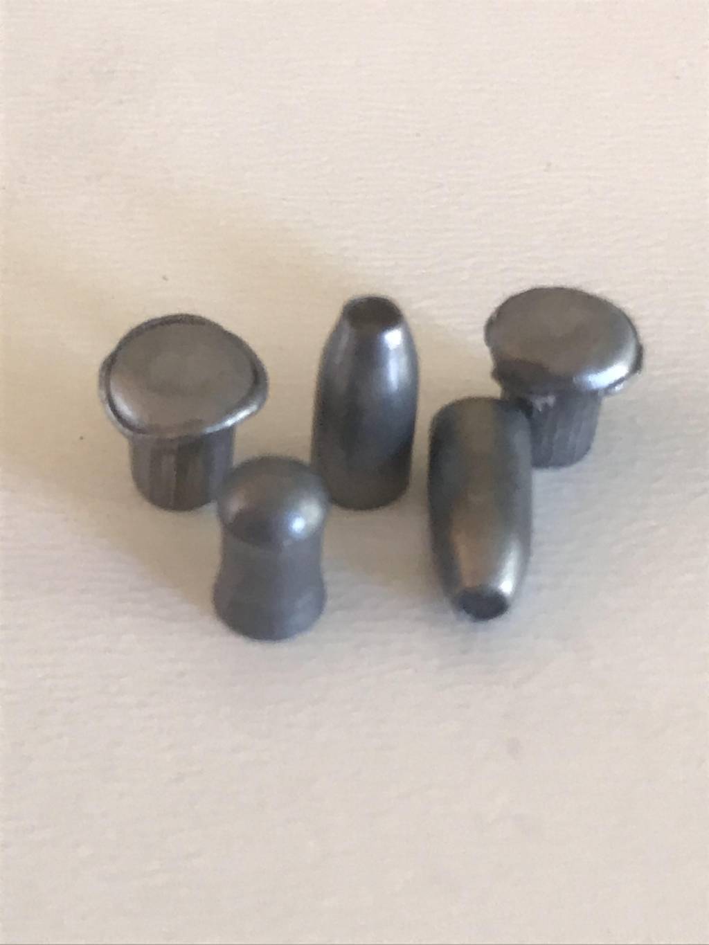

Thor slugs are manufactured in South Africa and they carry the range 177, 217, 25, 30, 35, 45 & 50 cal. Their slugs are very similar to FX Hybrid slugs with a deep rear section, which creates a good air seal with the barrel.

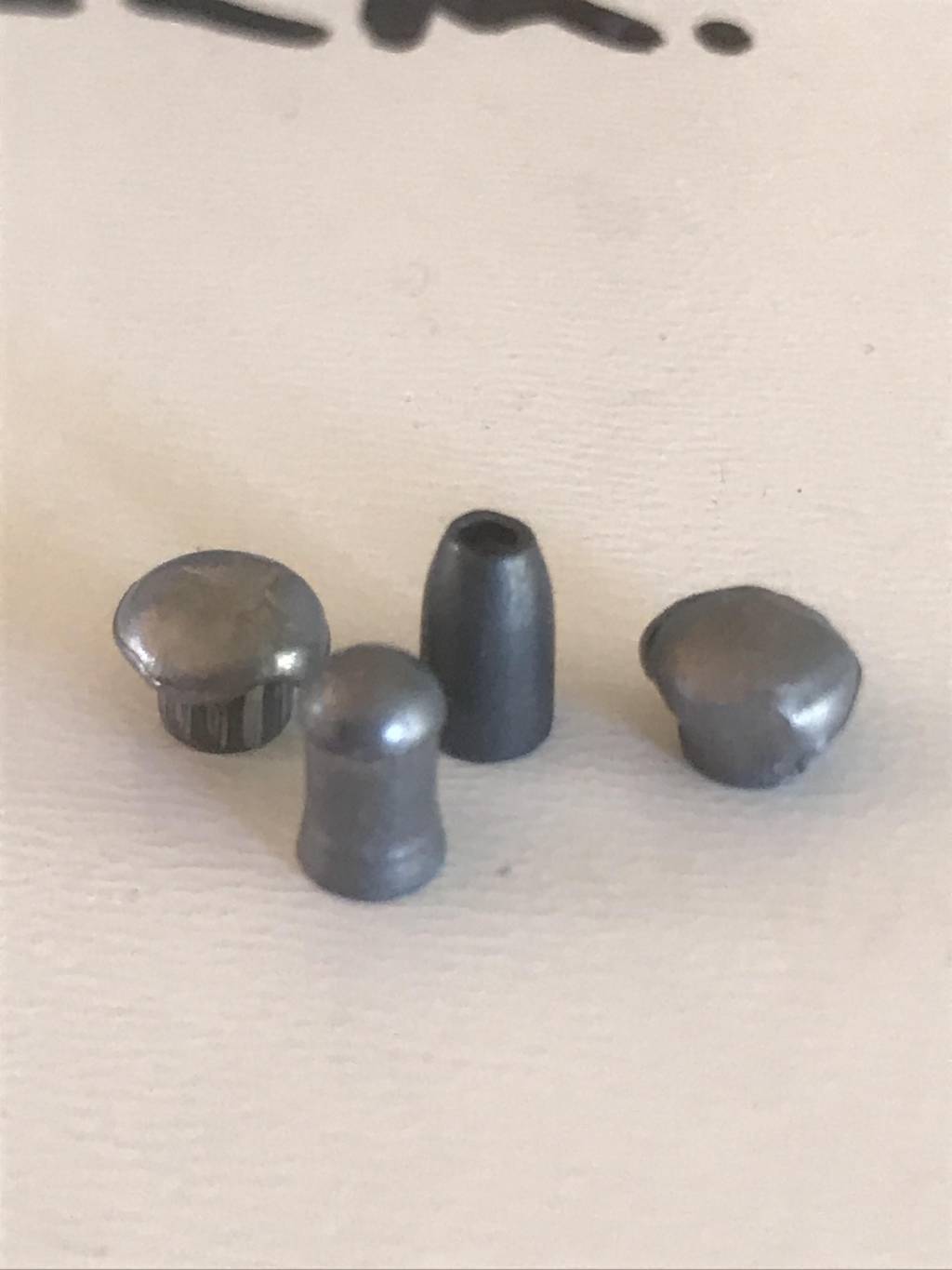

Left is a JSB Beast 16 gr pellet then 15 gr, 17 gr @ 19 gr, they manufacture a 13 gr as well but unfortunately I didn’t have a sample to add to the line up.

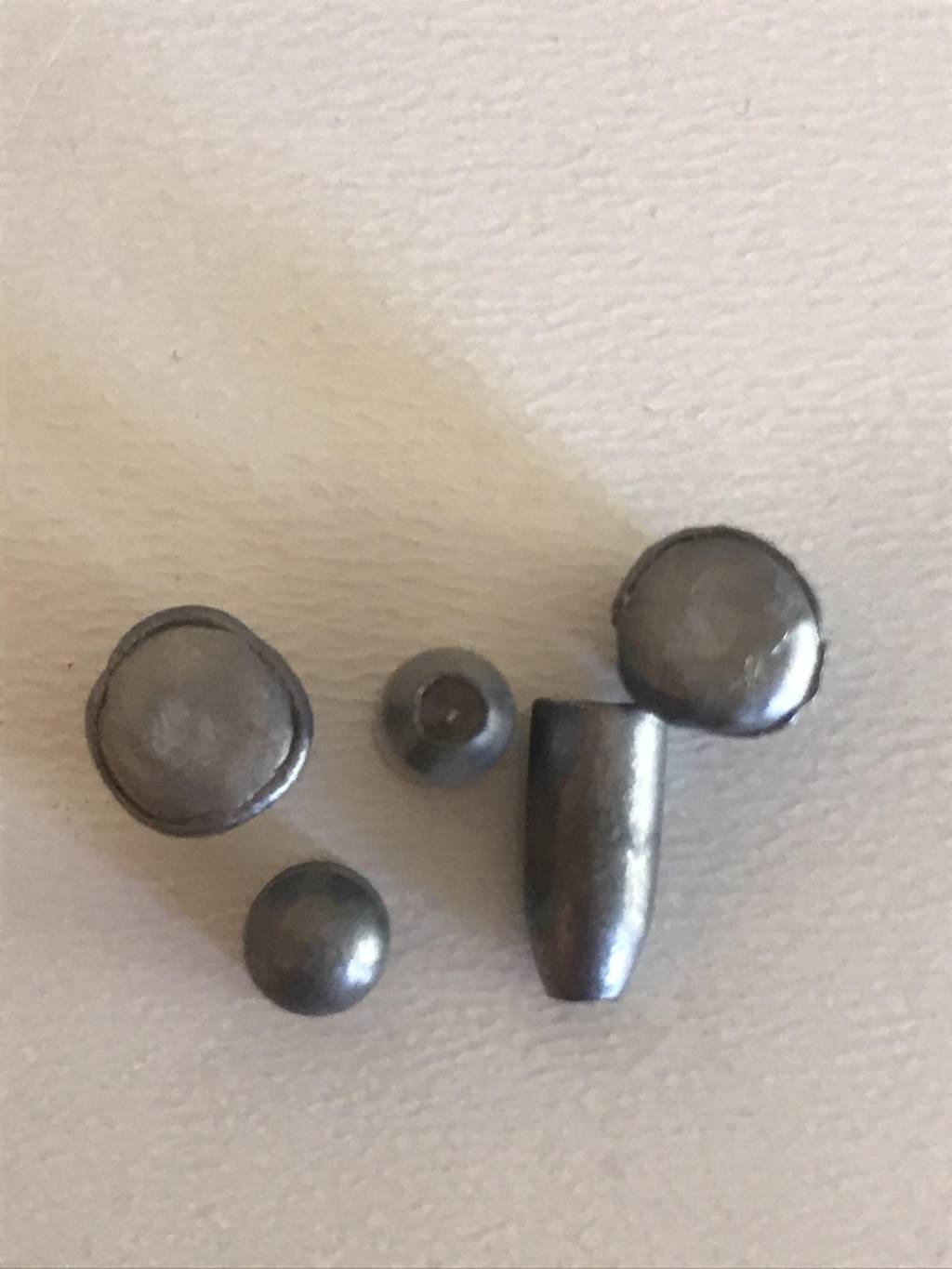

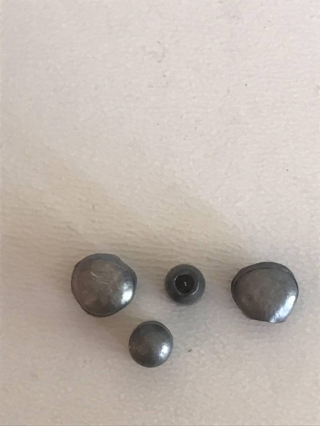

Above are the 15gr slugs which I shot into my silicone baffle box at 965 fps, the expansion is outstanding. I have also field tested the 15 gr on pigeons and they have outstanding transfer of energy, I would say better than any non expanding 22 cal Pellet I have shot.
