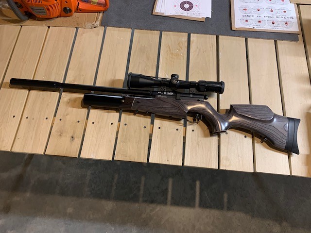

I have included a photo of the rifle as found below. I do believe there was a slight defect where the laminate didn't quite cover the base stock, evident about 3" from the back and an inch or so up from the bottom. The rifle was so heavily discounted, I didn't complain. One can't feel it so I can only assume they put the hard finish over the top of it. Not a big deal but not ideal, either.

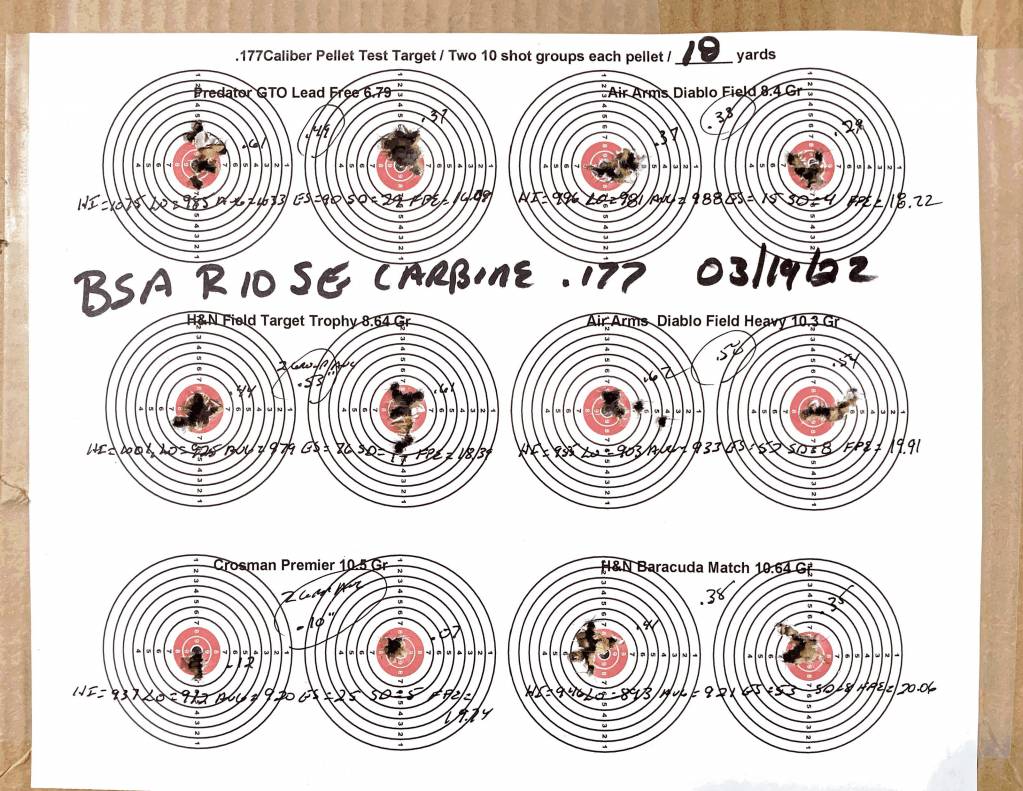

The rifle is really quiet, light, and extremely well balanced. I wasn't too thrilled with the accuracy, until I got to the Crosman Premier Heavy 10.5s. As indicated below, with these pellets I was able to achieve a two ten shot group average of only .10" C-t-C at 18 yards.
As far as power, as indicated below, my testing indicated consistent output of 18 to 20 fpe.
