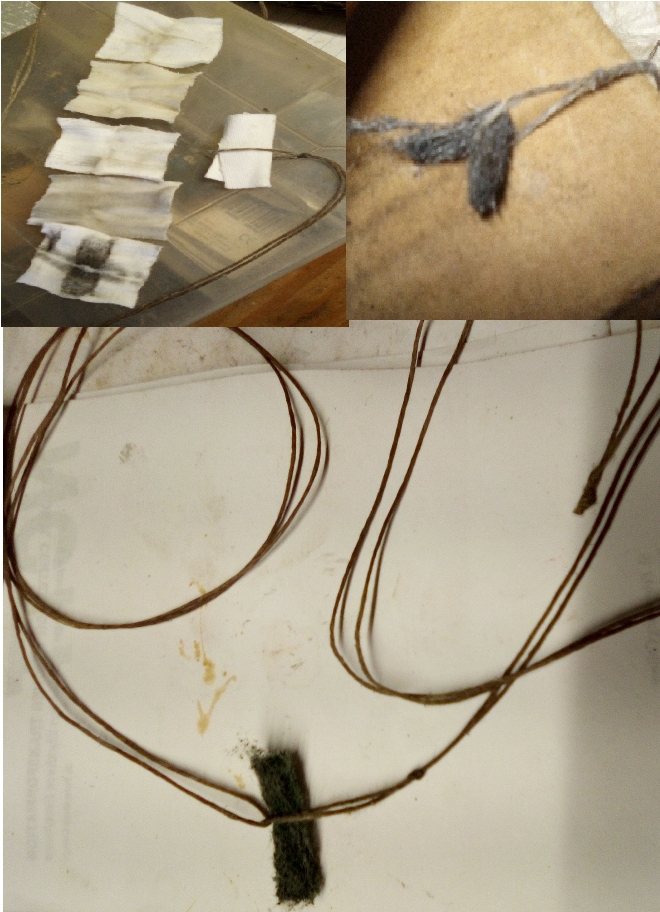

Maybe make your own pull through string ..
Just use a strong thread / cord.

You could do the pull through cord thig like i showed above ( works probably the best in little .177)
Then go buy a bag of bronze or copper or brass wool and twist a .177 ead of it for the string. . notice that in my picture above ( but mine is non soaping fine oiled steel wool ).

Used for gun cleaning many , many, many years . Also ive used steel wool and scotch Brite patches on my string like in forever. No adverse effects yet.. ( see my pics above . A steel wool and a scotch Brite patch used)
