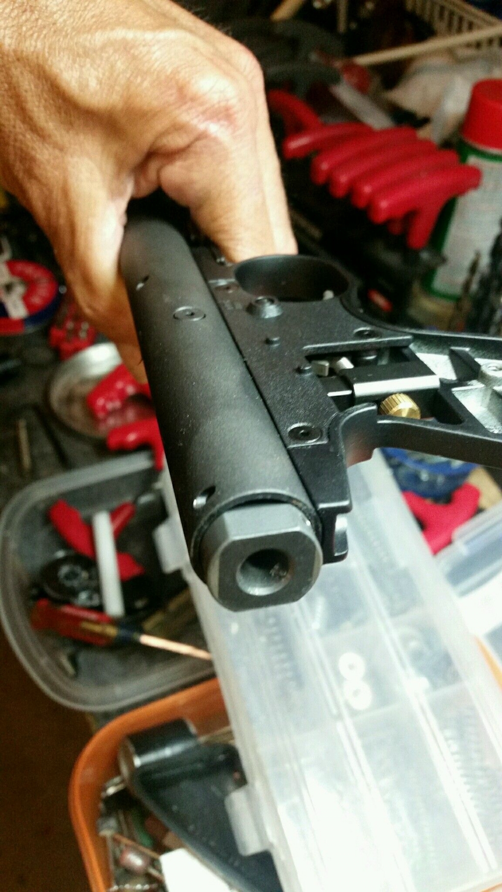

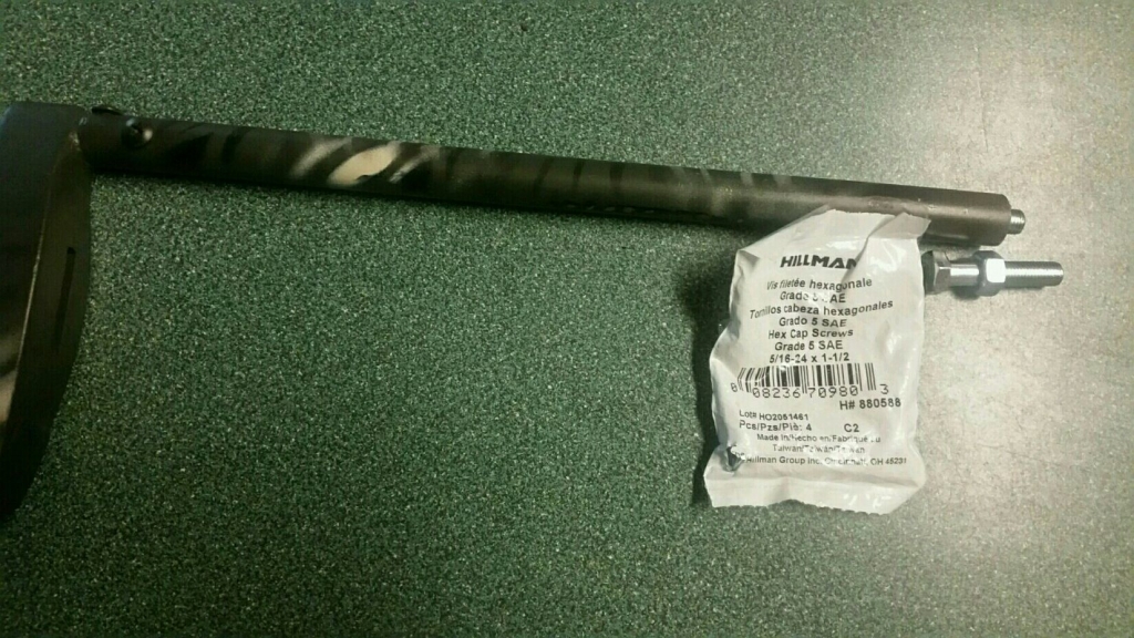

My PRod (which should be the same as the 1720) is 5/16x24.
In fact I just recently built this for it. Used JB Weld to hold the nut/bolt combo inside 1/2" copper tubing
I think it should stop where the plug ends--just to be on the safe side.
Ace Hardware sells all kinds of bolts, so you could just buy several for simulation, or take the plug with you for actual testing.

Ace is the place 5/16-24 fit perfect and yes I will vent this bolt.
Thanks for the help.

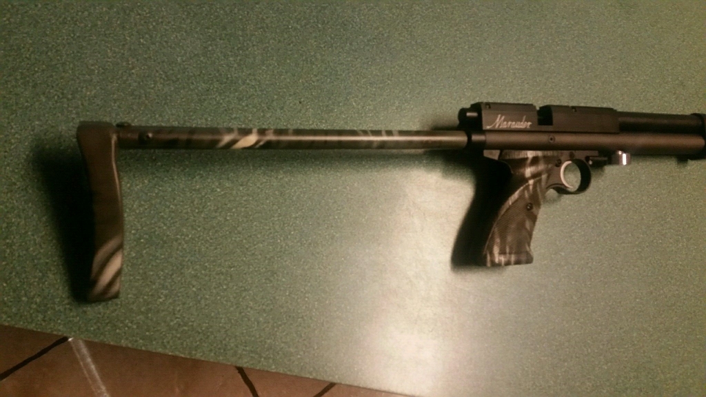

Mine is 3 turns to secure. Turn the stock 3 times and it's off for adjusting, or backpacking.

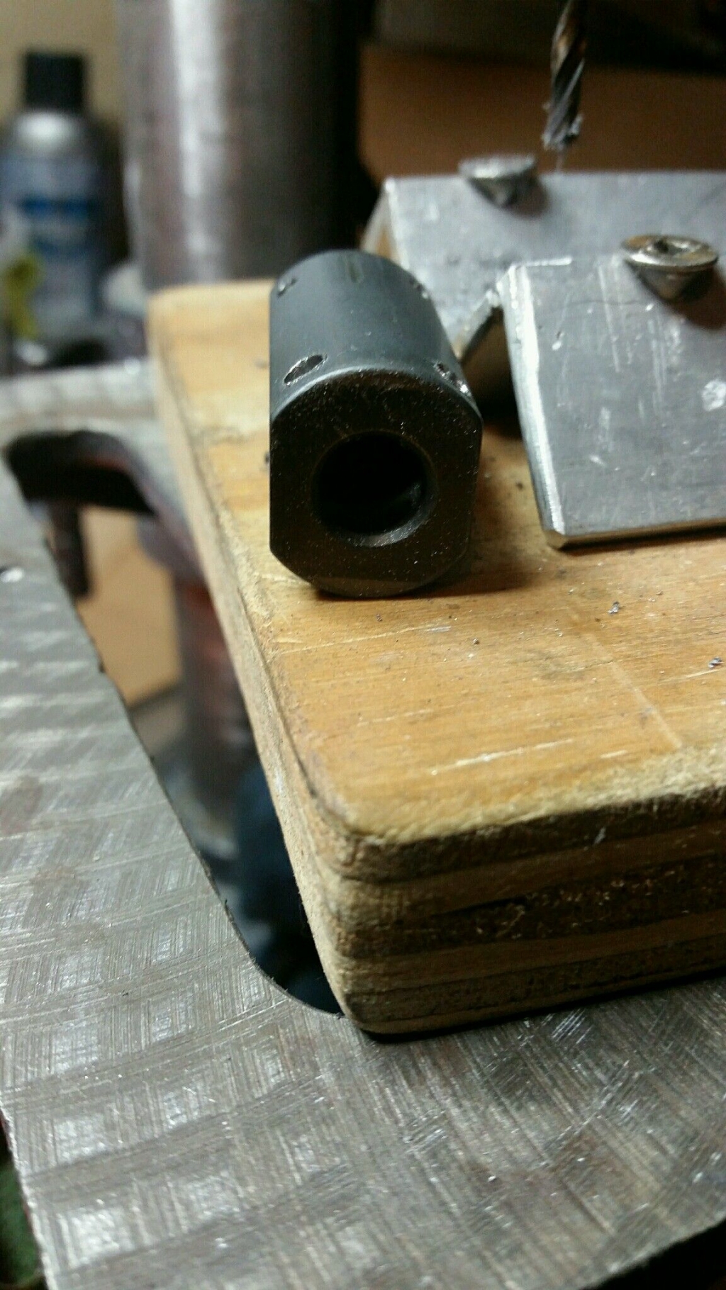

Not an "expert" but I did take my hammer to drill it and peg it with delrin pegs to ride on so I took a pic. Whoever says that without a "vent" in the bolt this hammer could pull ANY vacuum at all has either not ever seen a Prod/1720T hammer or its a sales pitch.
