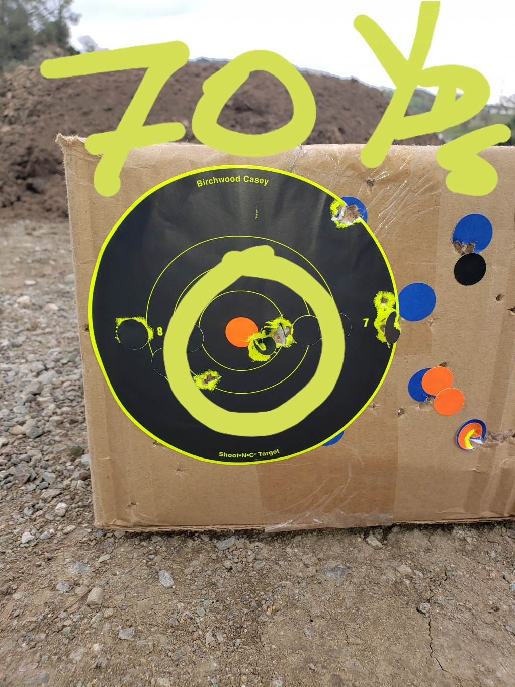

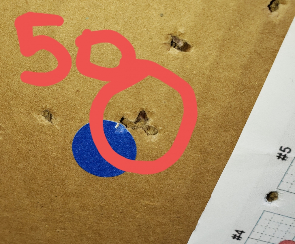

But I also just was given a .22 PRod that is doing these groups below, at 70 yards with the copper pellets. I actually have two PRods, but one of them has been miraculous in the accuracy dept.
There is a pellet hole at 7 o'clock- I had hard time chambering that pellet and it still shot pretty well. That's 6 pellets at 3 o'clock from the bull.
It's very shroud sensitive- how tight you've the shroud on the barrel can make the gun a sprayer or a player...

So, I guess it's a toss up!
