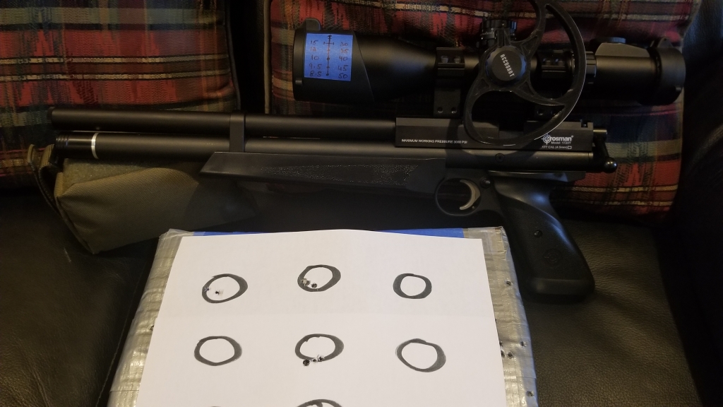

20 yards plinking, I like it. Using just sticks.
Yep, I’m surprised these guns don’t get more attention. Light, well made, accurate (LW barrel), versatile, easy to fill, etc....

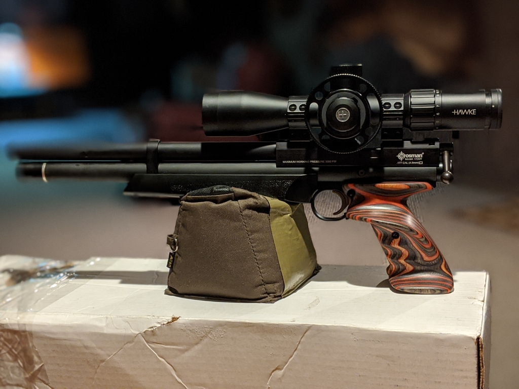

I’ve had mine for 5+ years. It has been setup as a 6fpe backyard 10m target carbine a 12fpe ground squirrel carbine hunter. At 12fpe I still get about 25-30 shots.

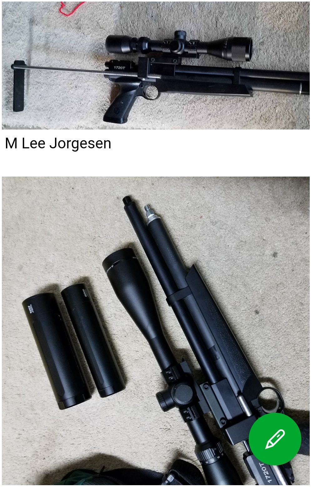

They are amazing, and for the $$$, unbeatable. @ 12 ft lbs and w a good scope, they are silent w an aftermarket ldc, and 50 yard accurate for ground squirrels. I've had a few, this one has the bigger transfer port, Huma and the sweetest trigger of any of my guns. The .177 pellet is v efficient w fur bearers.
Field target, airgun silhouette, silent practice in deer camp or while still hunting, grabbing a tree squirrel for dinner, it does it all. Eminently customizable and easy to work on w 1,000's of mods out there- #1 recommendation for those wanting a real airgun pistol. The only downside is it's a little front heavy for 10 meter, 1 hand target shooting. This one has the collaspeable stock, fits in a normal knapsack and is my 'sneak gun' when out in legal areas where a gun welding hiker could be disturbing to other nature lovers. They don't know I have it, or shooting it, unless they stumble upon me weilding it.
My 1720, as set up for pistol field target, averages sub-3/4" five-shot groups at 50 yards with 8.4 grain JSB Exacts at 800 FPS/12 foot-pounds.
I've been responsible for something over a half-dozen folks buying 1720Ts for field target, virtue of my advice, "Unless you're willing to spend over a thousand bucks, the Crosman 1720T is inarguably the best choice... for about half that much money!"

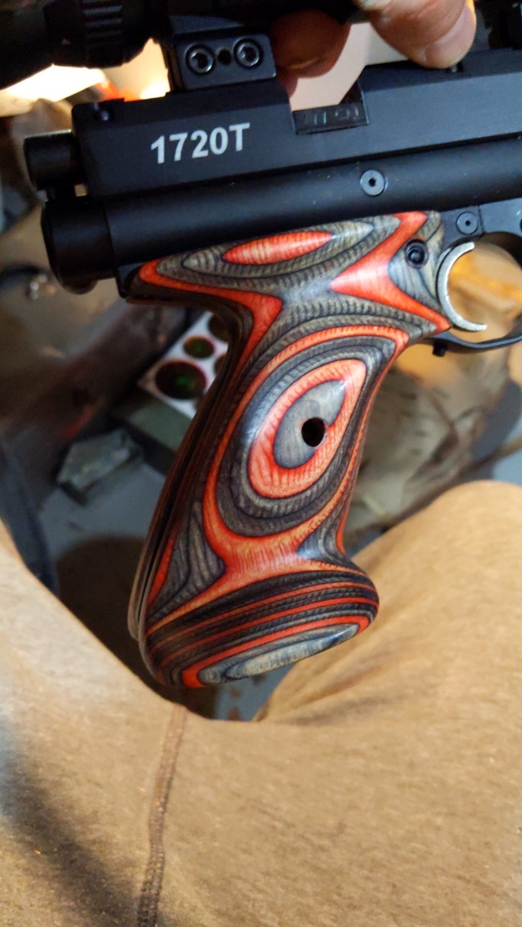

Grips- I've used this guy and he is fantastic. Maybe not as pretty as a laminate, but my 1720T grips fit like a fingerprint. The other benefit is that I can move these grips to any of my 22XX Crosman pistols.
https://www.precisiontargetpistolgrips.com/custom-scanning.html
