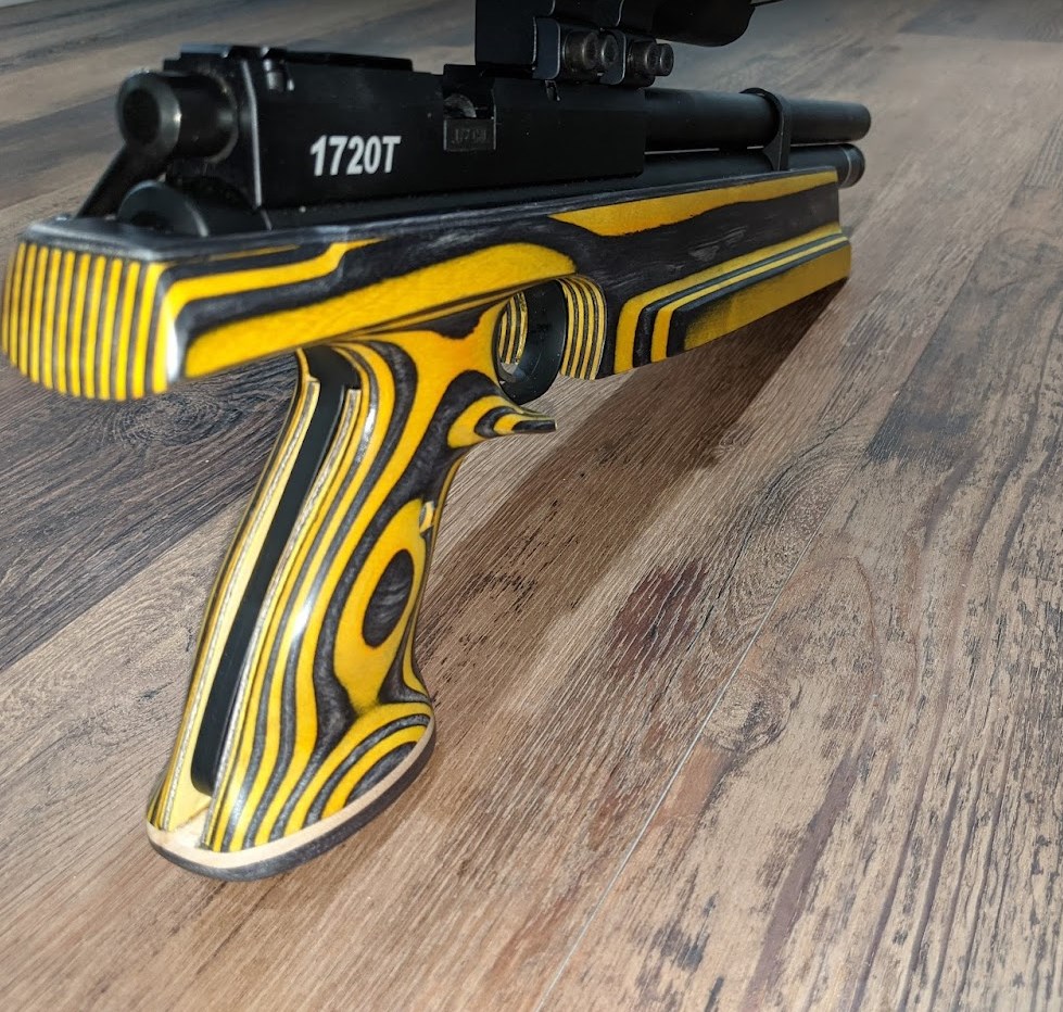

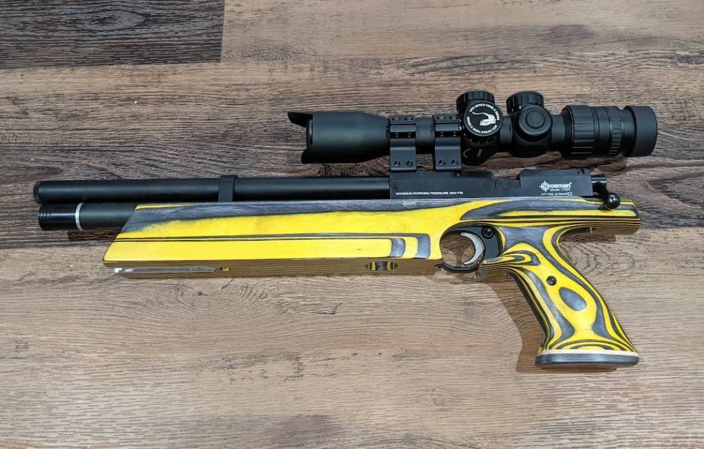

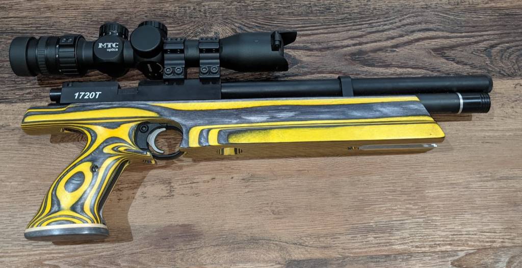

A couple months ago I asked for opinions on a pistol field target legal PCP pistol. Many said the 1720T and that's what I decided to go with. The intent was pistol field target a couple times a year, but otherwise just a fun, low powered plinker for garage fun. I've so far really enjoyed it in that capacity.
First off though, it really needed a fancy stock from Steve Corcoran @ https://www.scstocksandgrips.com/
I requested a black and yellow lam as I've always liked that combo, and boy did he deliver!
SC was great to deal with, quick to respond to emails, kept me updated on progress, delivered in the original time frame that he quoted. I'd recommend him but that's not news to anybody who's been in the airgun game for very long.
His stock really made a kinda old-school, bare-bones simple PCP pistol into something special. Feels great in the hand, nice flat forearm for shooting off a knee. The one piece design totally changes the impression of the 1720, it just feels SOLID now. So far I like it. A lot.
Also had SC do some inletting for the Anschutz rail there in the "forearm." Which is the only kinda bummer about it, the groove is different dimensions than the Anschutz to picatinny adapter that I have, so can't get to a bipod that way. And it's also different dimensions than my MAC1 knee riser (not that those are legal for pistol FT anyway, just thought it'd be fun to shoot off a knee and bumbag, or from a bench/bipod for fun, shooting flys and general dinking around). I'm wondering if those cheap, heavy gauge-wire-for-legs bipods have the correct shaped male rail to mate up. Might be worth the $20 to see.
Oh, I'd considered buying one of the adapters that attaches to the back end of the tube and allows an AR type buttstock to be added. Won't work with this stock as the action nestles down into the inletting so much that the rear of the tube is not accessible. That's not too much of a heart breaker though, cuz the scope I went with wouldn't work with a stock anyway, and I'm not big on swapping scopes around. Usually I leave a scope on a gun for a long time.

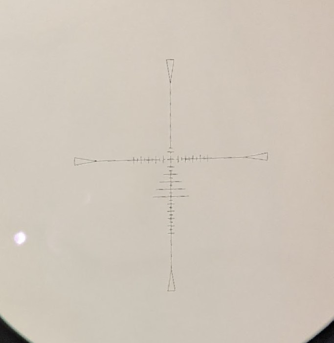

That leads me into the scope. Topped it off with a MTC Viper Connect 3-12x32. Really a kinda odd scope as it has a super short eye relief, I mean hold your eye on the ocular, short eye relief. It even has a 5/8inch wide rubber ocular with coarse threading that is meant to bring it back into contact with the orbital bone, proximal to the bridge of ones nose. The manual says only for PCPs and rimfires with the ominous warning of "serious injury" if mounted on any recoiling gun. Makes me grimace to even think of the pain this little scope would mete out on my 30.06. OUCH! I understand it is legal to use the head/face as a contact point to help stabilize the gun for pistol FT, so it might be a fortuitously odd feature. Time will tell, as I still need to get a wheel on it and see if it's serviceable as a range-by-focus scope. Otherwise, compact little scope that just feels and looks correctly proportioned for a pistol, 30mm tube, 10 yard min focus, really wide field of view, glass-etched reticle-which isn't too bad of a design, MTC calls it the SCB but it's different in real life than the MTC literature.
Here (hard to get pics of this, so sorta grainy and dark but it's the nature of sticking a cell phone camera behind a scope, not the scope image itself)

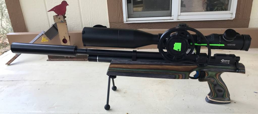

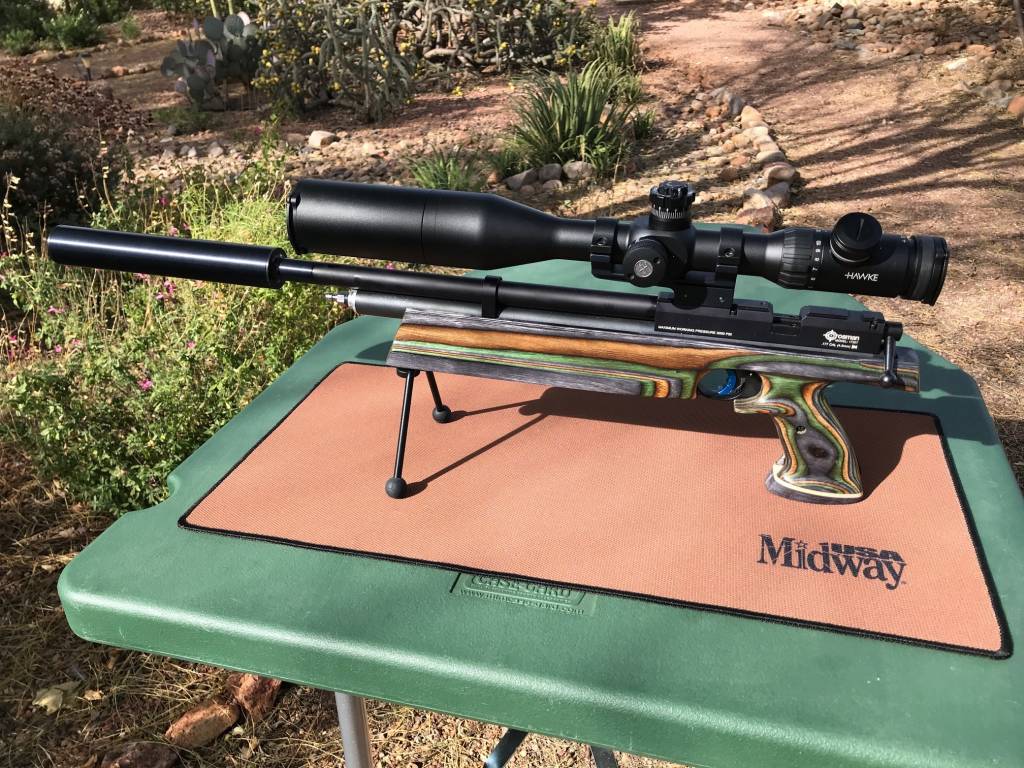

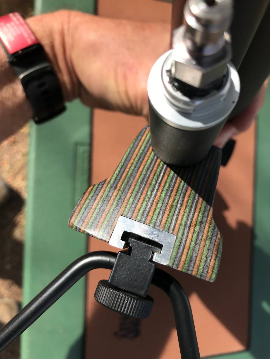

We've been emailing a little, so you've seen the pictures of my SC stock already since both our stocks were in the production line around the same time but here's the finished product. I picked up a Hill moderator since I have a significantly smaller property than you (from what I've seen in your photos) and have to keep it pretty quiet around here. JD's in the process of making me a wheel for this gun also and I'm hoping it will be here soon.
The inexpensive Amazon presentation bipod seems to fit the rail pretty good. Here's the link:
https://www.amazon.com/Hammers-Competition-Ground-Display-Anschutz/dp/B01M9CSPBS/ref=sr_1_2?crid=BWGC6FYLMF5W&keywords=anschutz+bipod&qid=1637433381&sprefix=anschutz%2Caps%2C240&sr=8-2
I agree with everything you said about these pistols. I haven't had mine very long but I have to admit it's an accurate little bugger'. I know at 10 meters it's just as, if not more, accurate than my IZH 46M pistols.
I haven't been able to help myself so I have puttered around with adjusting some things a little and I'm around 11 fpe with a string of about 20 or so pretty consistent shots with 10.34 gr pellets between 2750 - 1750 psi. I've only shot a few of the 8.4? gr through it and it likes them too. My adjustments didn't really seem to make the pistol any louder nor more quiet. Maybe I'm just getting hard of hearing too! Ha! One of these days you'll have to please let me know how you make the cool shot string charts you have above.

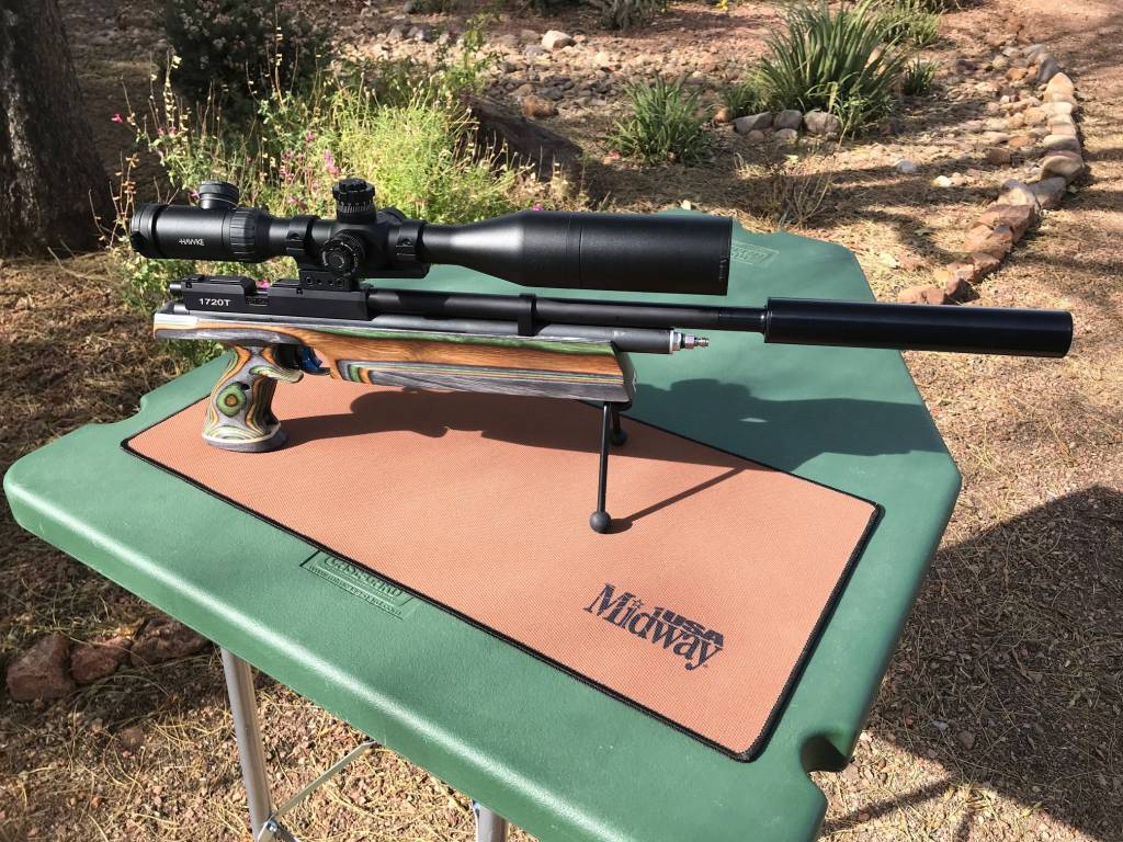

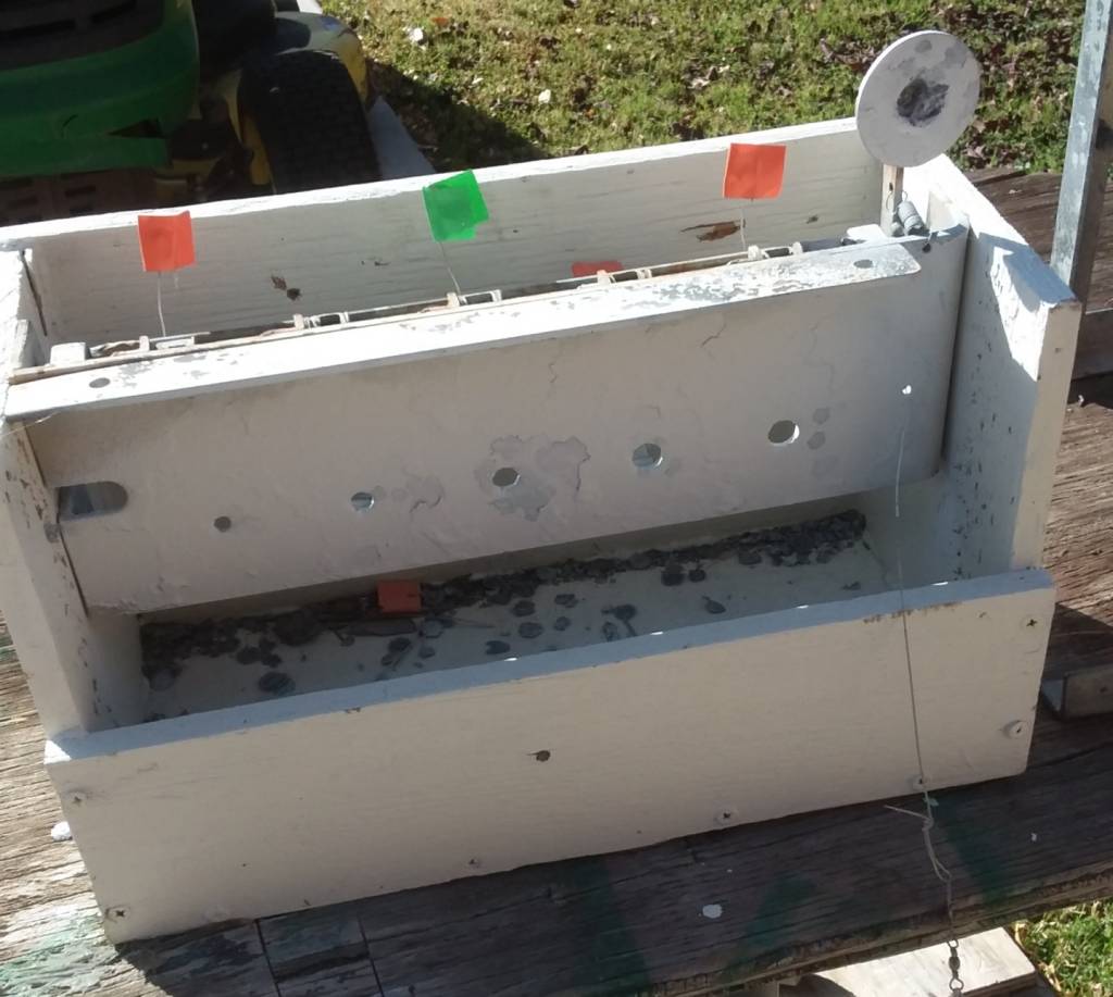

Man I had some fun with this thing this evening!!!
Shooting from that setup....

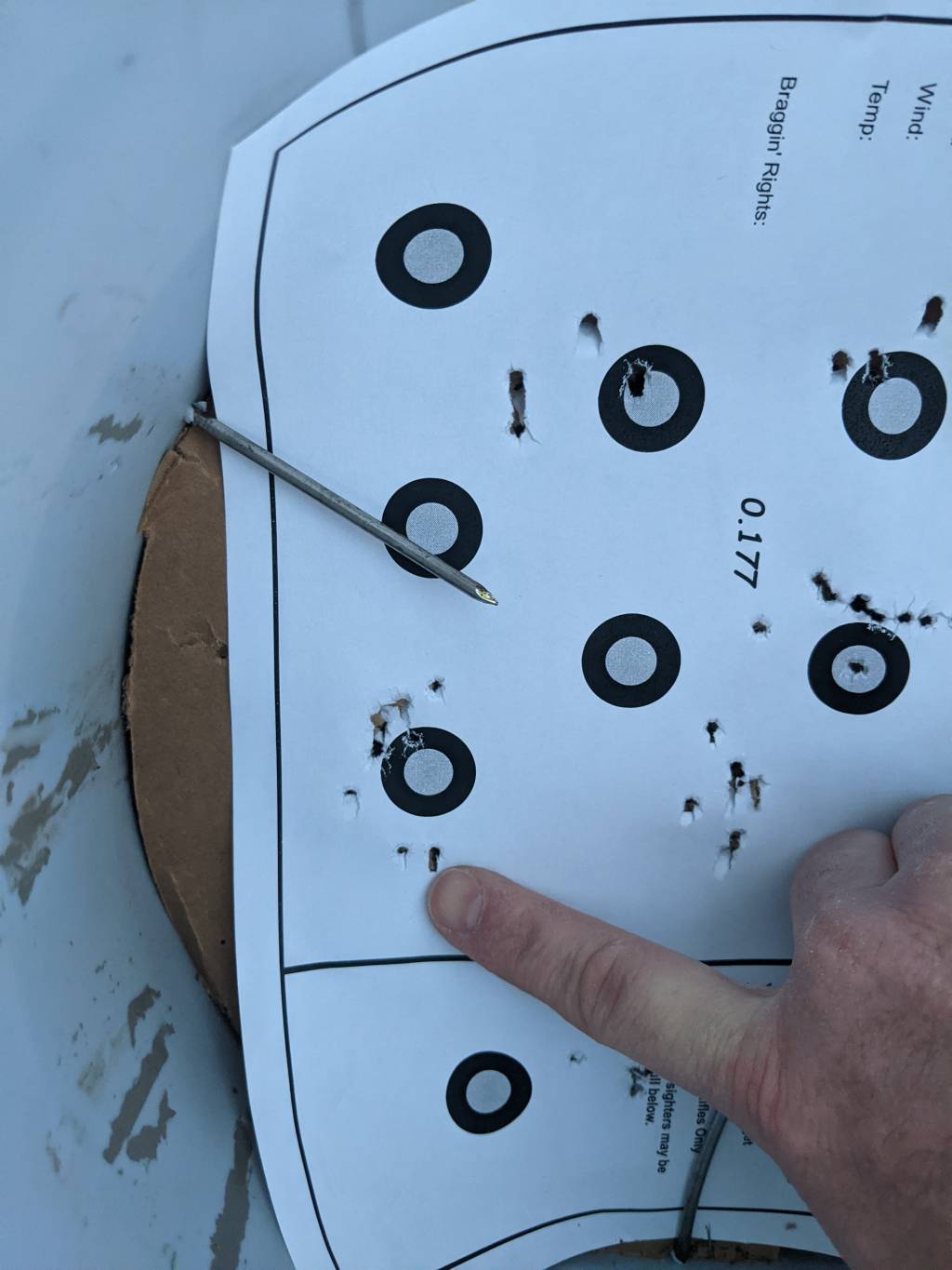

Upper left = 10 shots @ 47 yards with H&N FTT 8.65gr. Same pellet and distance right below that, another ten shots.

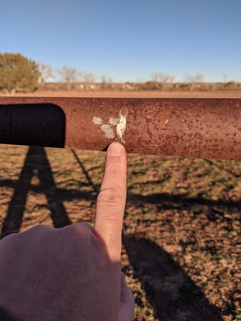

5 @ 47 yards. Still FTTs. Aim point was bird poop on fence. Fence quarters away and that can be seen in the pellet strikes.
This is two ten shot groups @ 47 with JSB 7.87s. Pointer fingernail covers 8 of the 10 in both groups.

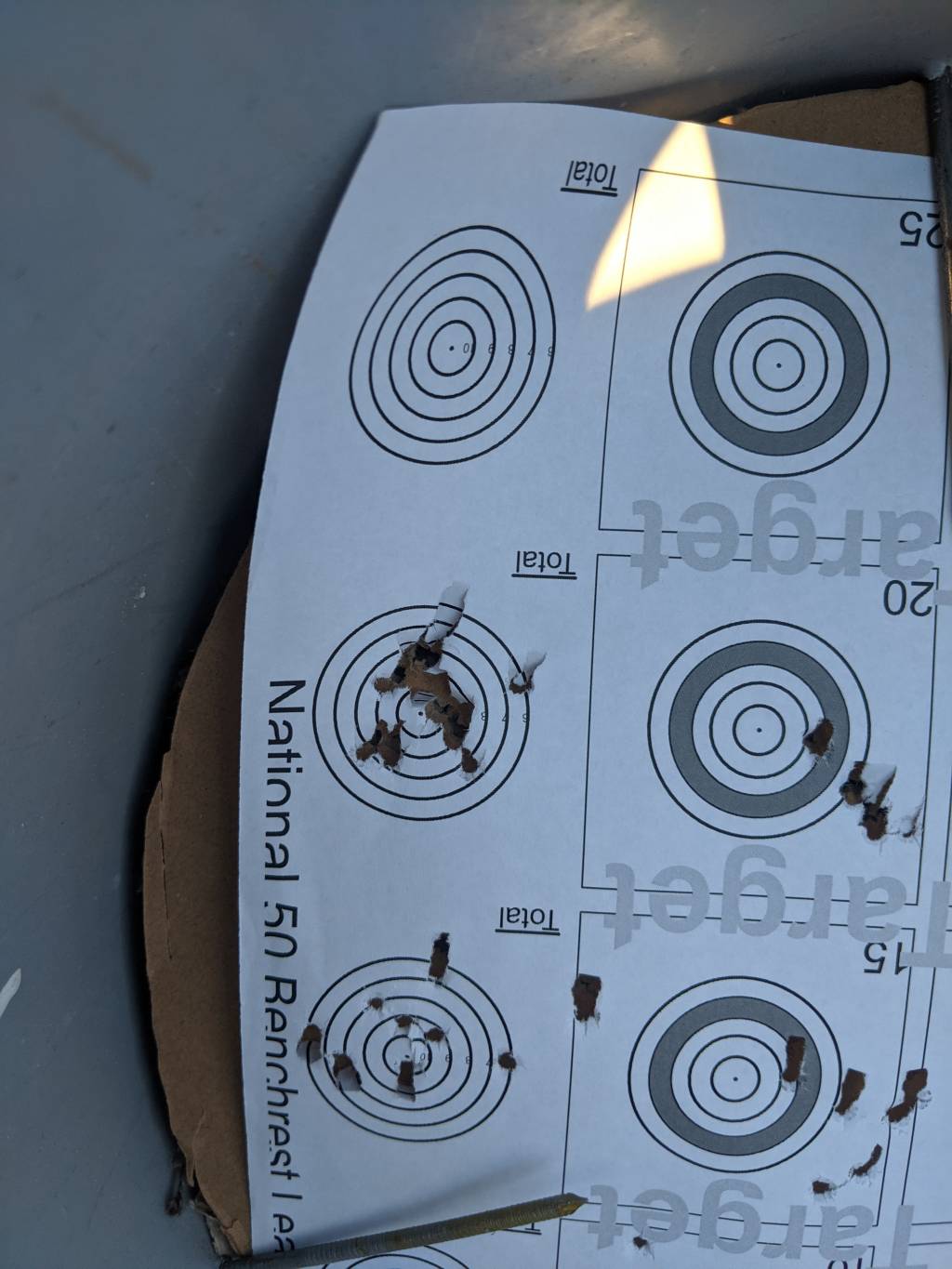

And ten at the fence with 7.87s, still 47 yards, fence right behind and above the pellet traps.
This is a five shot group @ 47 yards with FTTs.
And, believe it or not, I was able to connect with my 92 yard, 2 inch paddles pretty often! (Long ways for a little over 8fpe).
THAT was fun!!!
Maybe the most airgun fun I've had in a while. No frustration of how me or the equipment was performing, just plinking for the sheer joy of it. Had the little buddy bottle next to me, easy top offs, 40 shots per fill.
Really stable setup for a pistol. Could hold dead still.
Big smiles and occasional giggles during that entire session.
