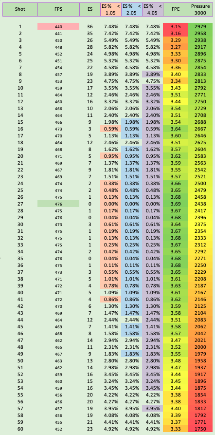

I had some time and good weather yesterday to work on a couple of airgun projects outside. One of those tasks was to finally chrony the 1701P. I haven't adjusted anything except the trigger on this gun. It has been shot almost daily for about 6 weeks, so pretty well broken in with 6 or 700 shots sent. This is what I got with JSB RS 7.33gr pellets:
So, wow! How nice is that! I am impressed and pleased to see that many shots off a roughly 45cc, unregulated air supply. Seems to operate well in the 2800 to 1800 psi range.
