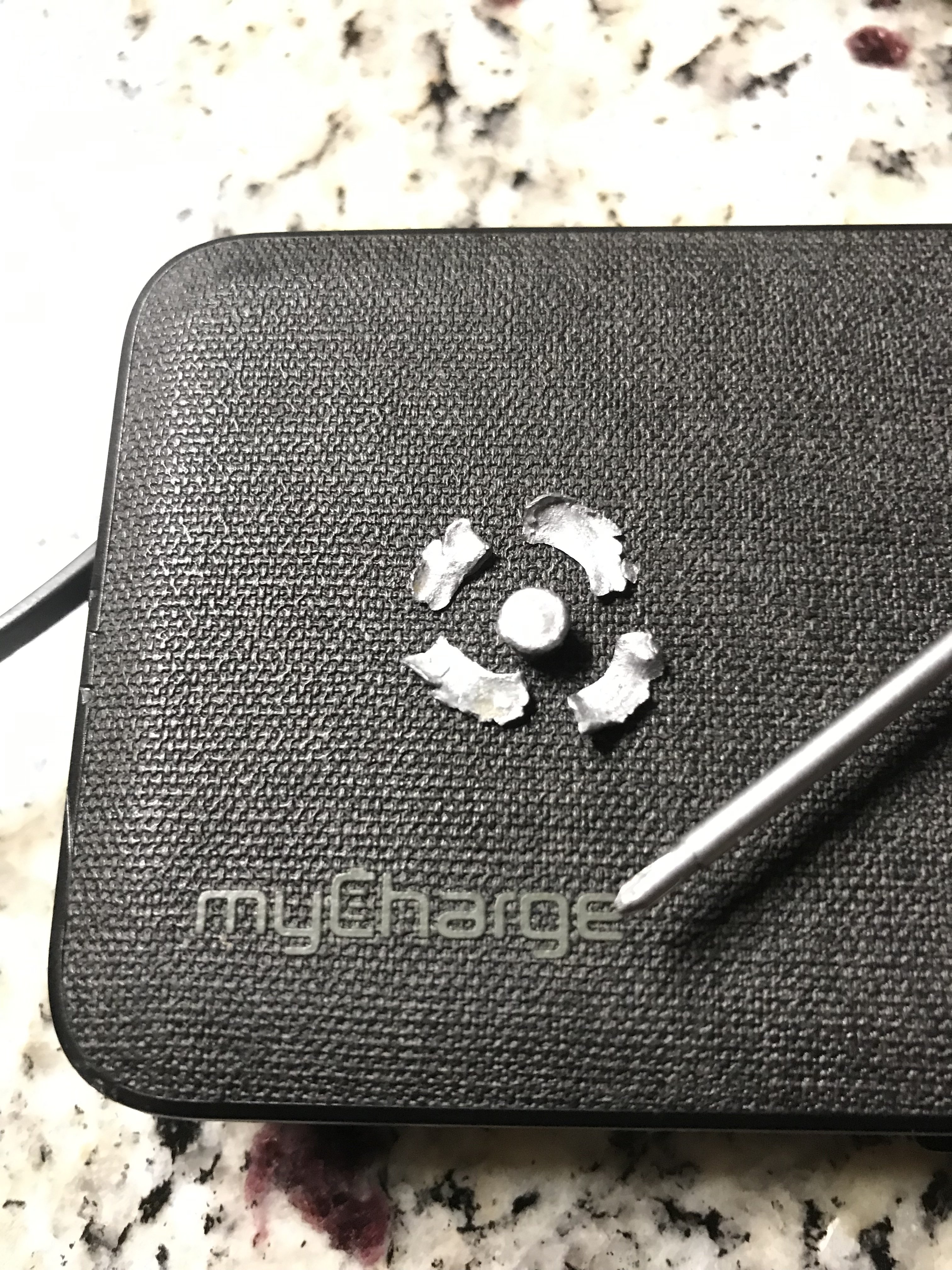

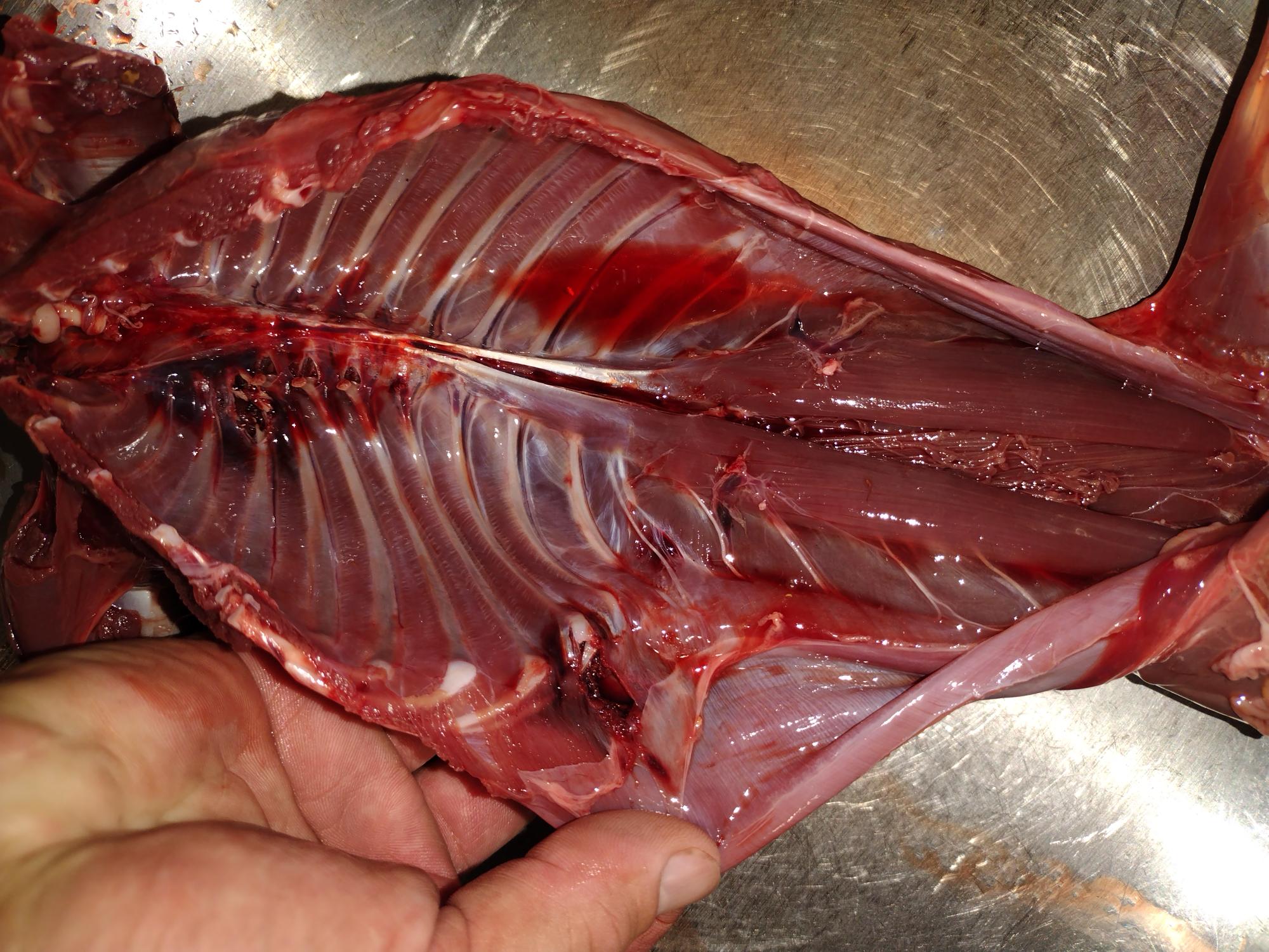

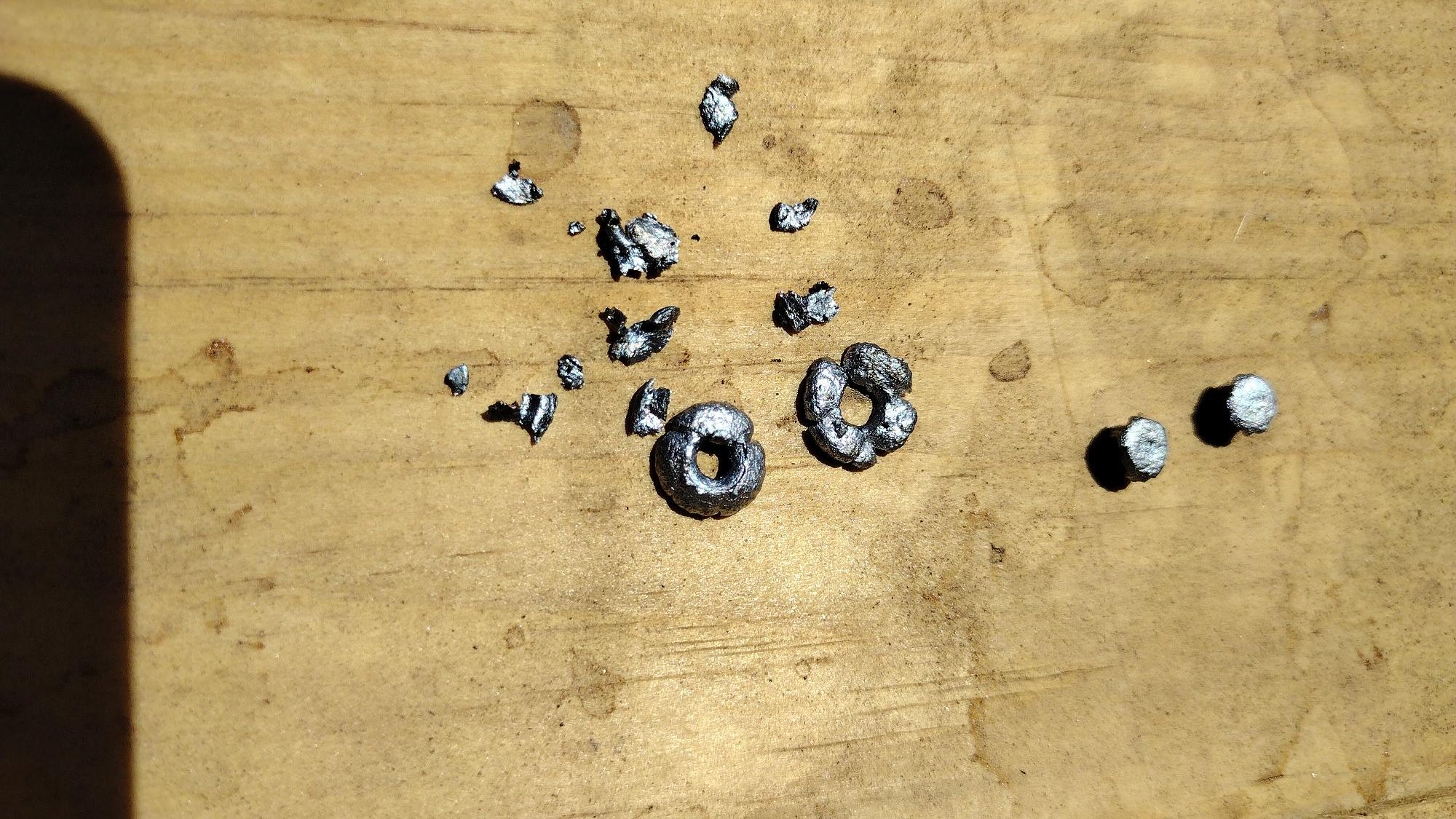

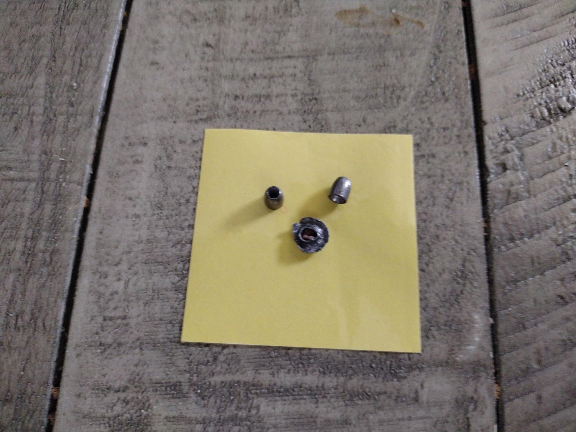

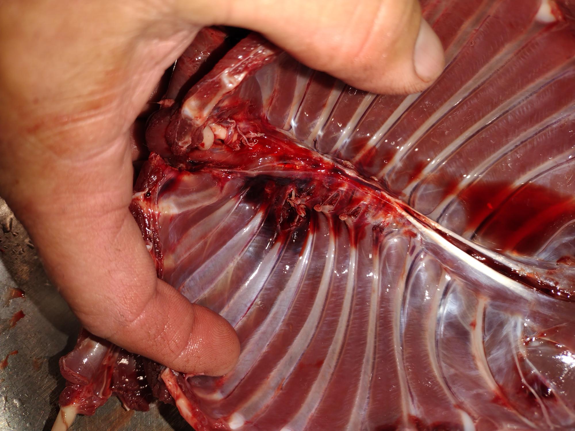

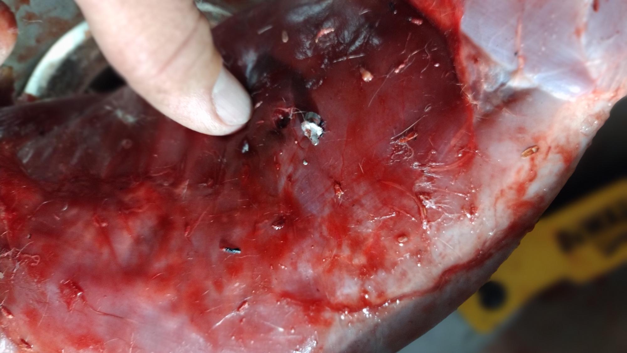

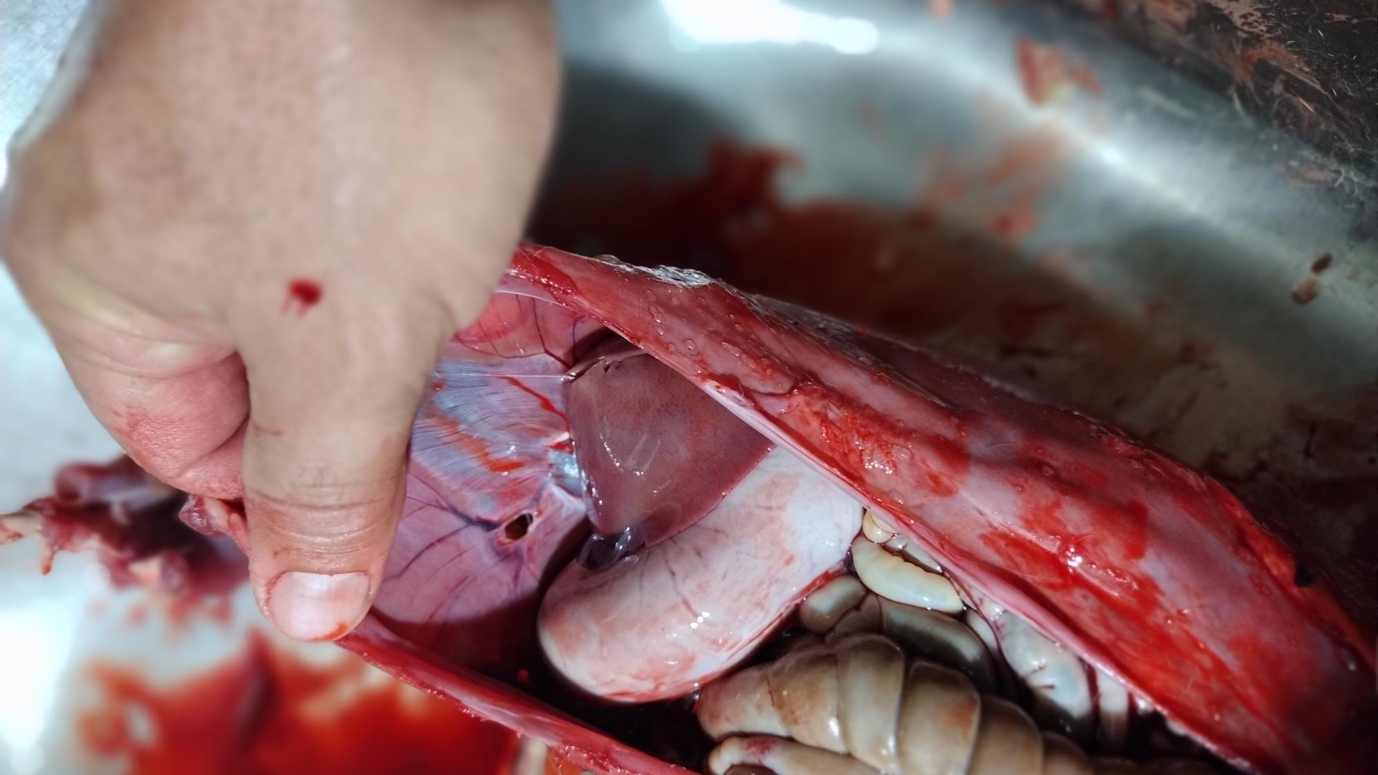

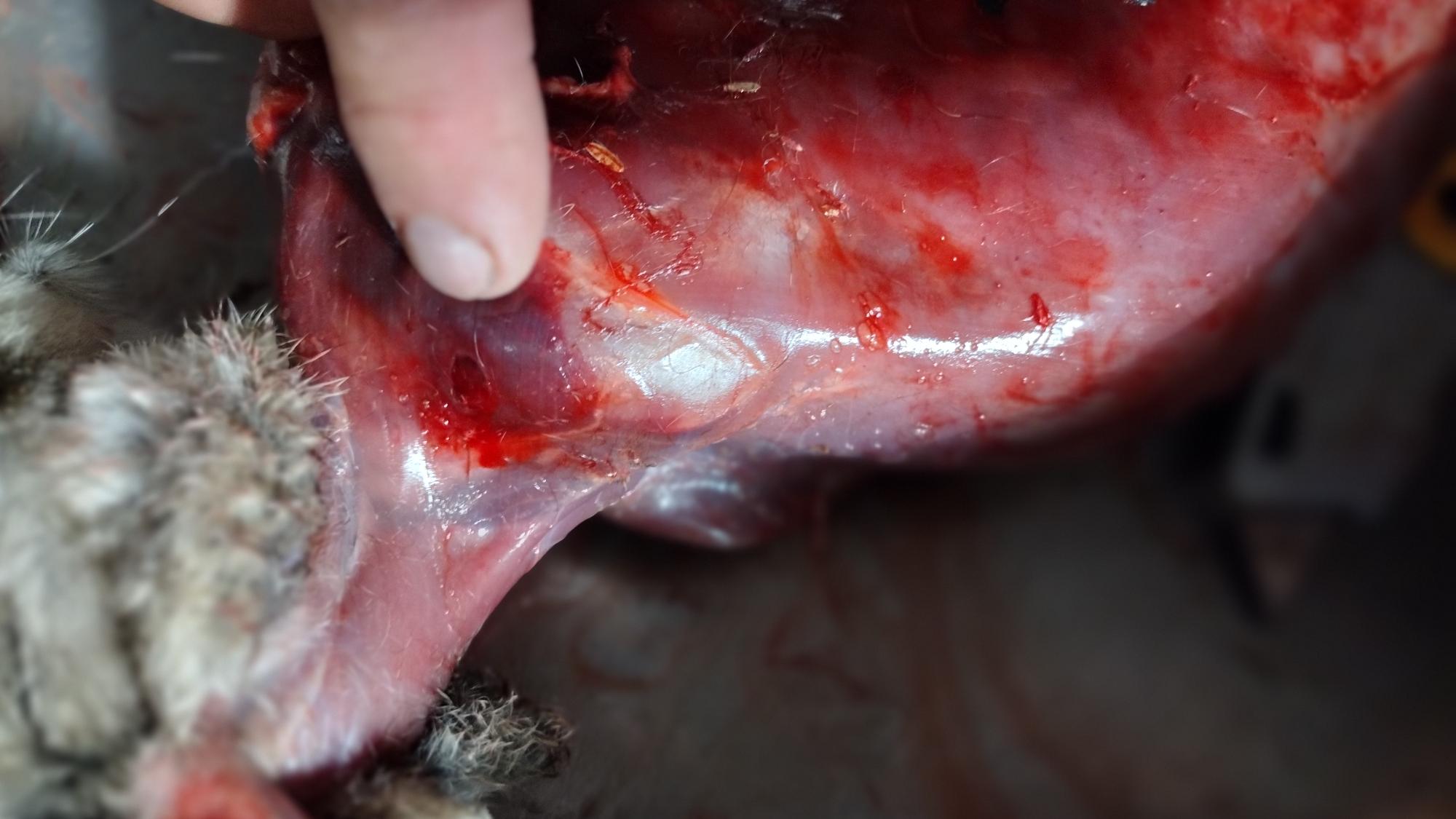

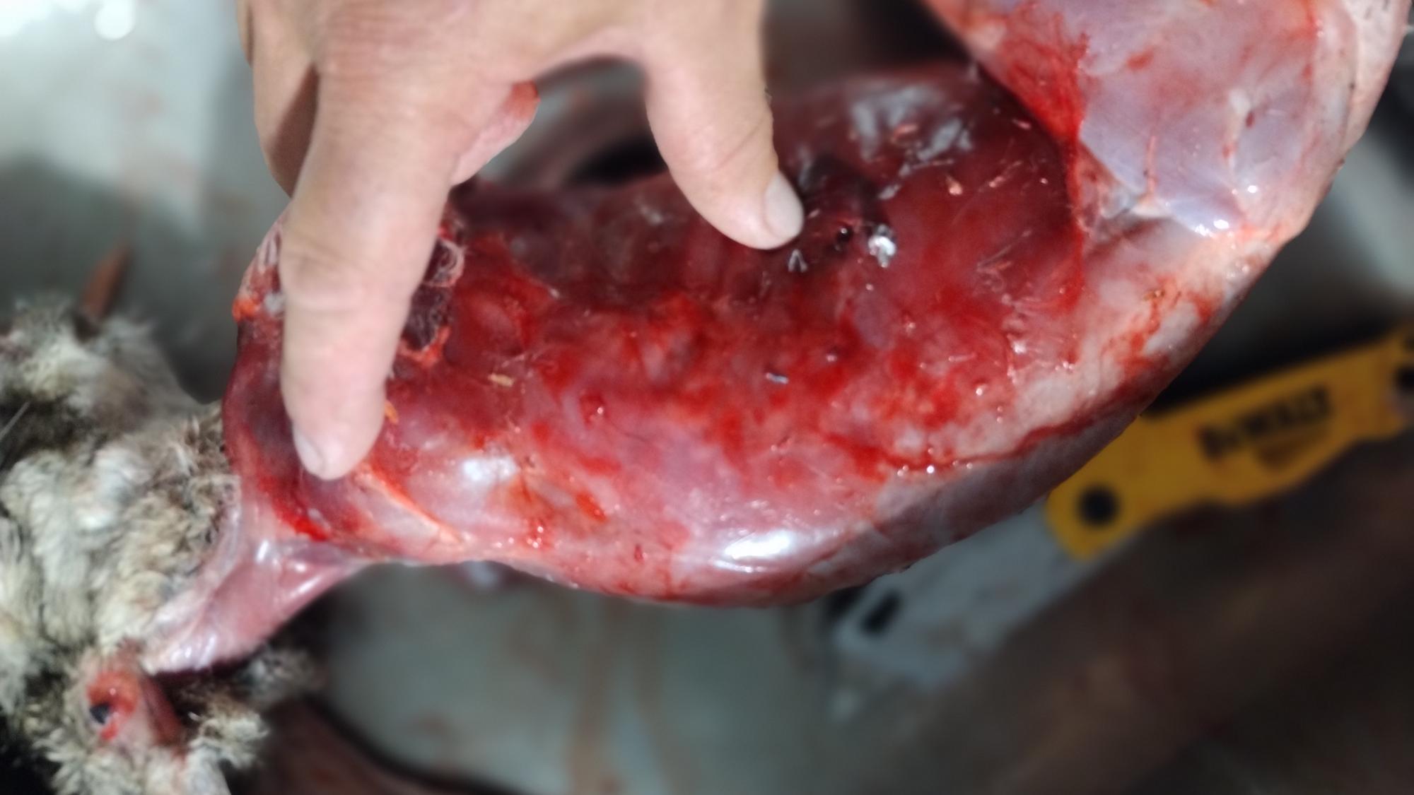

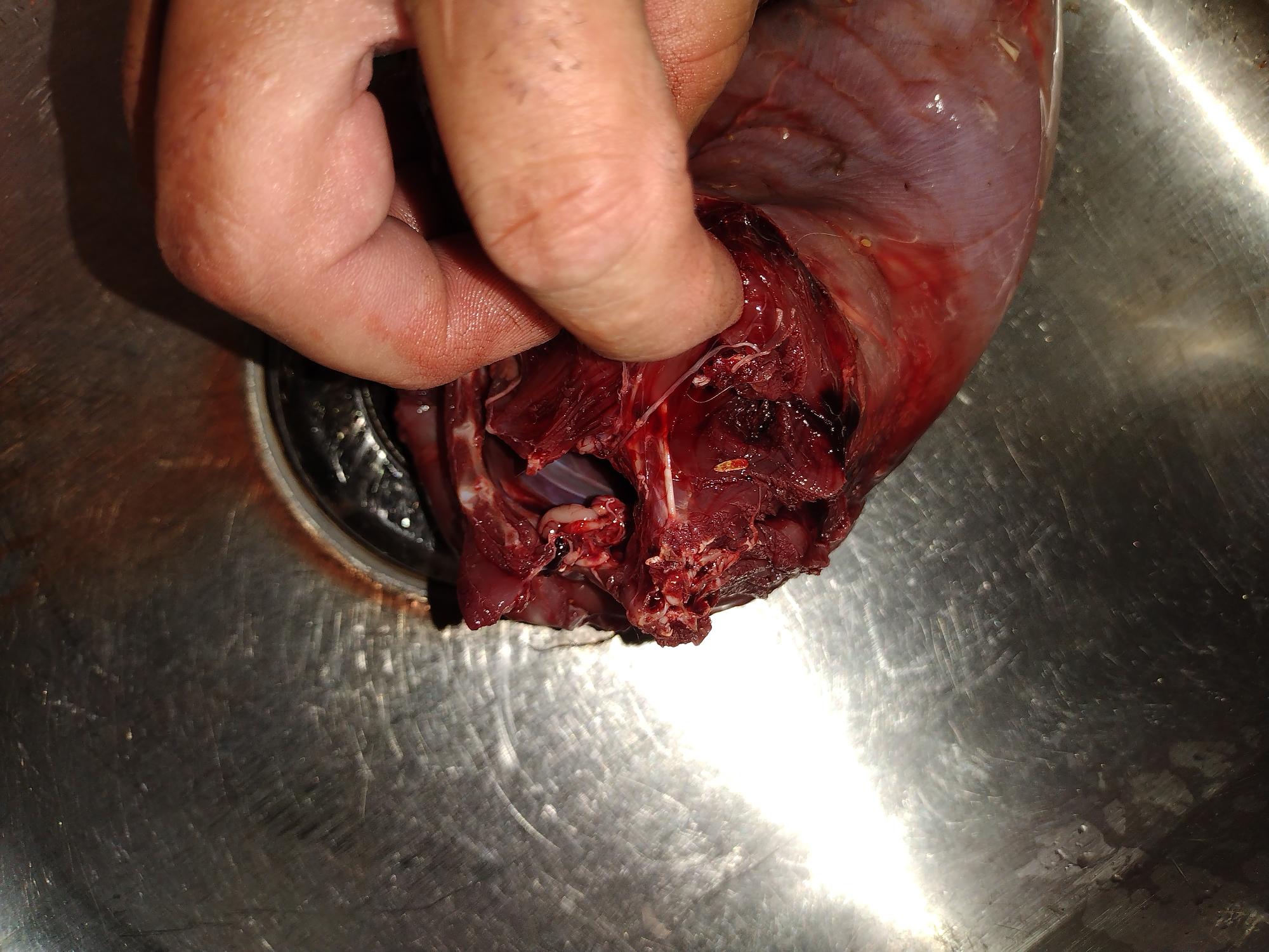

I've been testing different slugs on small game and this is the 2nd I've taken with the Knockers. In both cases there was good penetration but not much expansion compared to the JSB Knockouts in 13.43g
Instead of expanding they fragment, breaking apart early even though I am shooting them about 80 fps slower than the JSB Knockouts, and leaving the core to penetrate. If the fragments were bigger and carried further that might be different, but majority of them I find almost immediately on impact, I think I'm gonna stick with the JSB Knockouts. I think I'd rather have the expansion, maybe not as much penetration but definitely more tissue damage imo.
This Jack was facing me and head was low so I was aiming at the top of his head and just as I shot his head went lower and so the slug entered by his shoulder, continued then broke his ribs, tore up some vitals, broke through his last 2 ribs and rested just under the skin.
The performance of this slug and results with the fragmenting were almost identical to a squirrel I shot.
1000010261.jpg1000010262.jpg1000010263.jpg1000010264.jpg1000010265.jpg1000010266.jpg1000010267.jpg

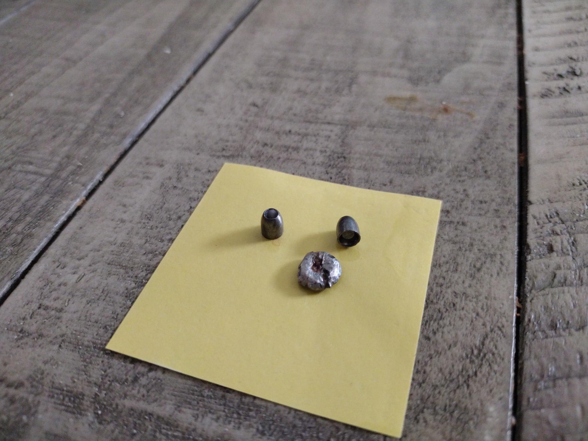

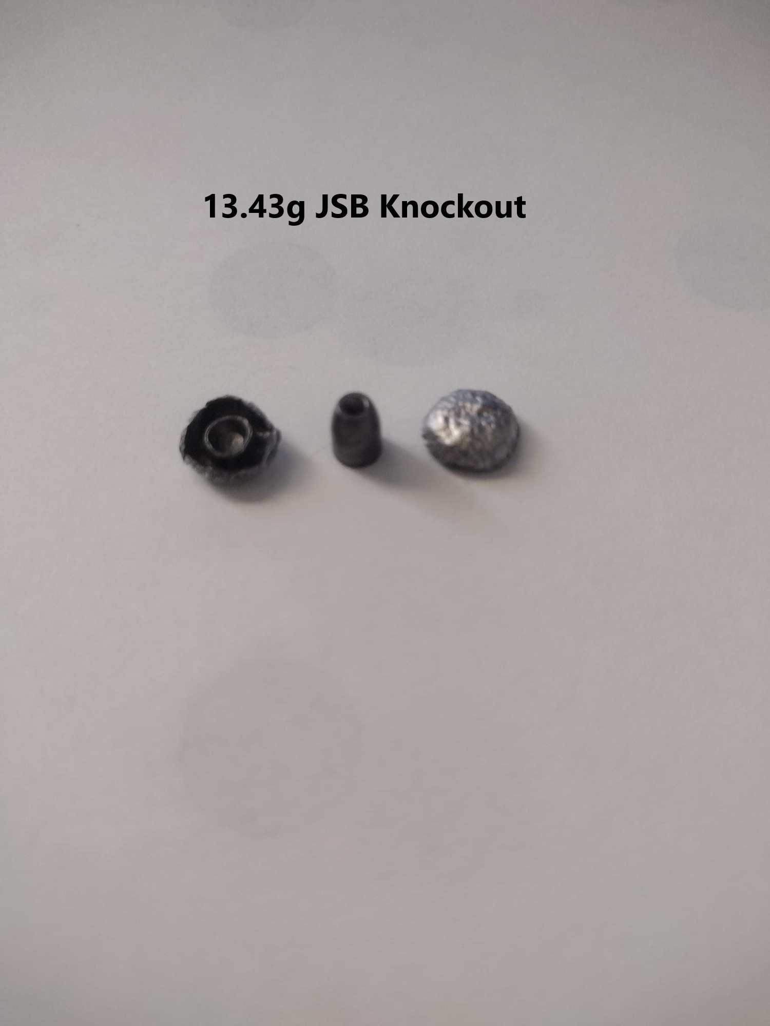

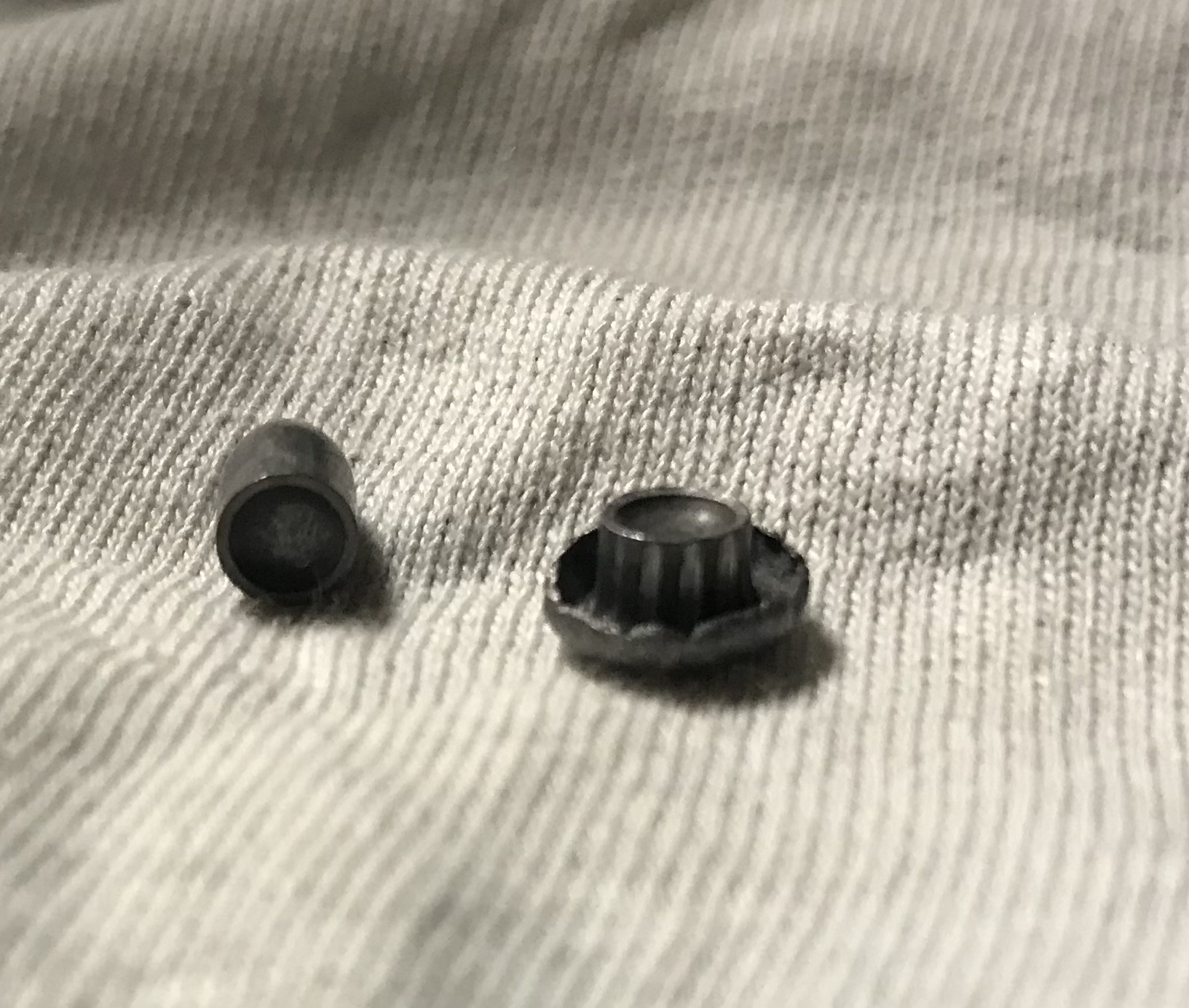

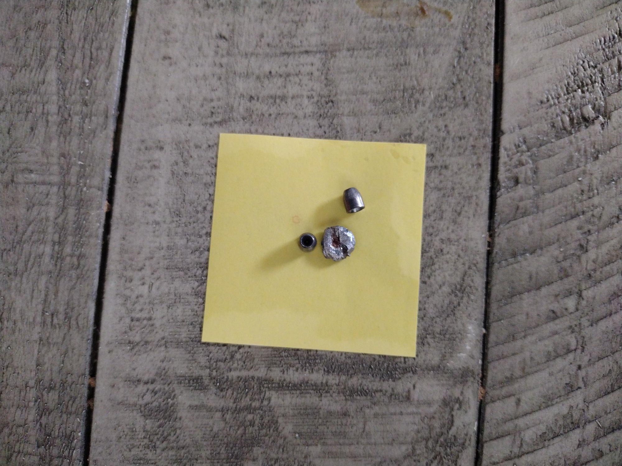

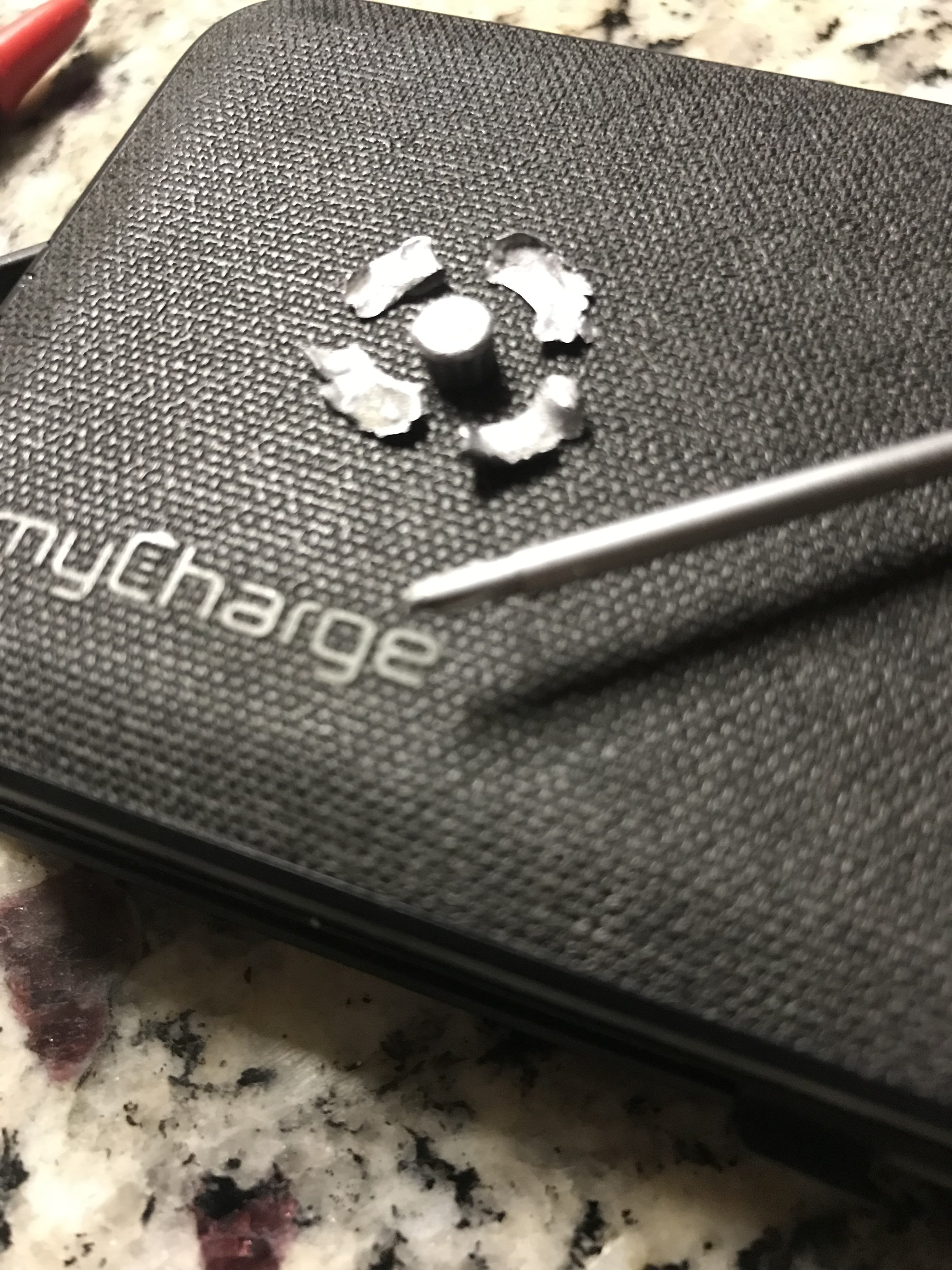

You can see a little mushroom effect on the slug but most fragments broke off, the walls of the hollow point are very thin. Below is an image of the JSB 13.43g Knockout, you can see the difference, also an image of the Varmint Knocker...both shot into 5 gallon pail of water, The flattened out slug to the left of the Varmint knocker was a 10.03g Knockout, the majority of those fragments are actually from the Varmint Knockers although I had them laying next to the other slugs
View attachment 574429View attachment 574430View attachment 574431View attachment 574432View attachment 574433View attachment 574434View attachment 574435
View attachment 574437View attachment 574438

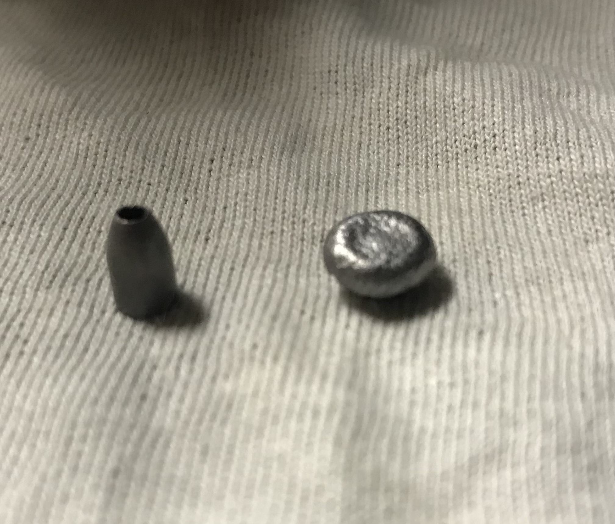

I'm shooting the 13.43g Knockouts at 978 fps / 28 fpe so don't know what to tell ya, not sure if they're redesigned or not but I love'em. As far as the VK 16.5g I think on small stuff like birds or chipmunks they'd be great since they fragment so quickly but then at the same time you don't need a 16.5g slug for stuff so small because that core keeps on going, I think a lighter slug with rapid expansion like the JSB Mk3's would rock smaller critters.
I took a small rabbit with the JSB 10.03 Mk3's this morning @ 53 yards and they would be perfect for smaller critters, I won't use them again for rabbits, almost no penetration. Shot him right in the eye and didn't penetrate much further after that, like a quarter inch. I dug it out of his head because I knew there wasn't an exit and I wanted to see how far it did penetrate. If this was a vital shot I don't think it would have penetrated deep enough.
I'll put a vid up shortly but here's the slug.
Reactions: JaceSpace1369
View attachment 574557View attachment 574554View attachment 574558View attachment 574555
