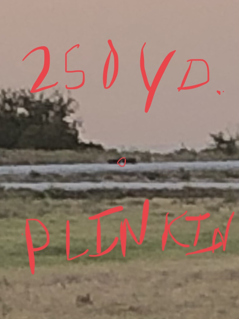

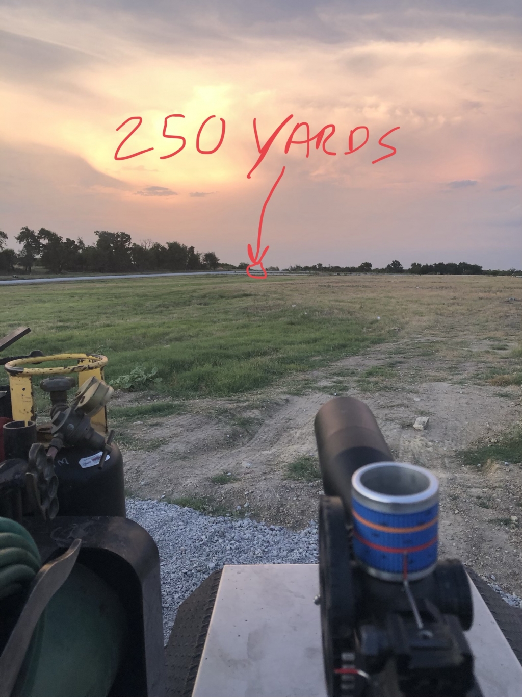

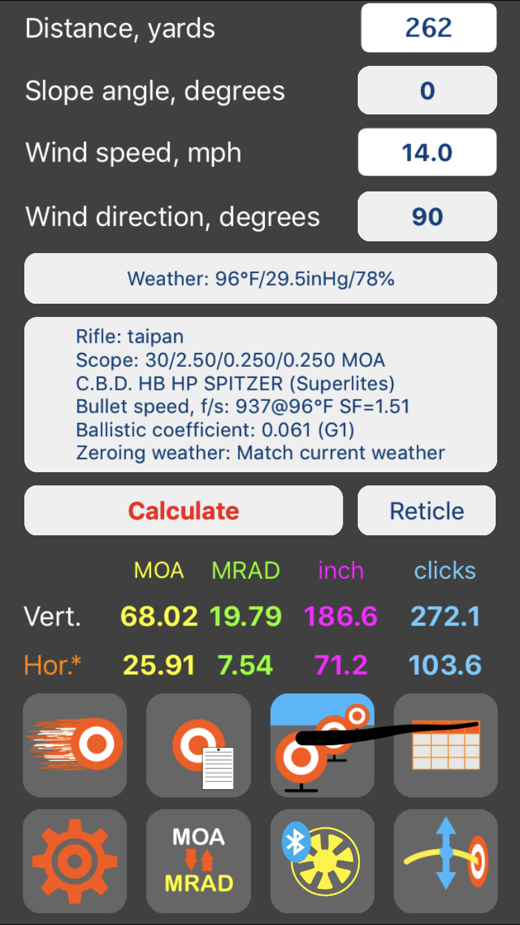

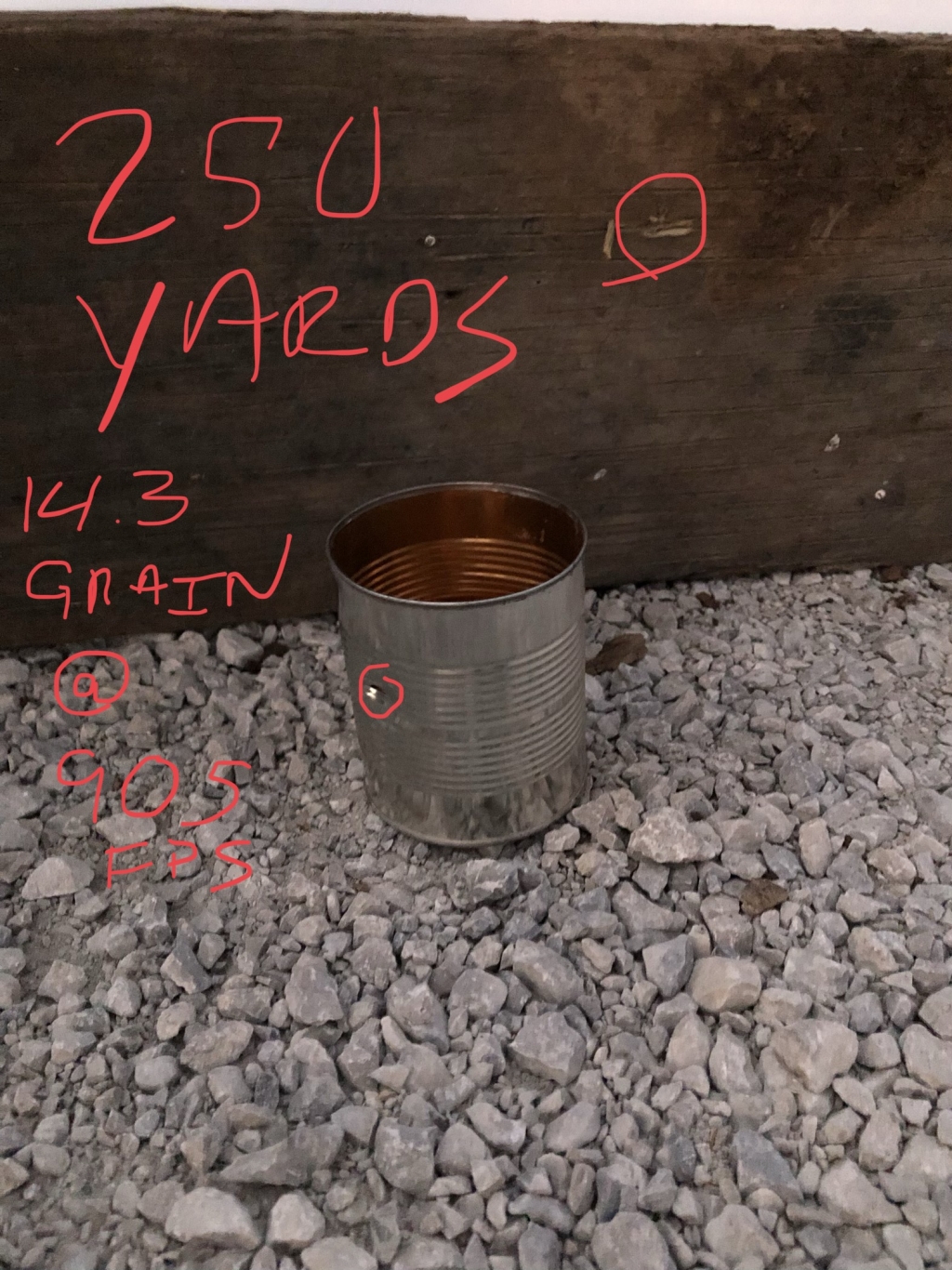

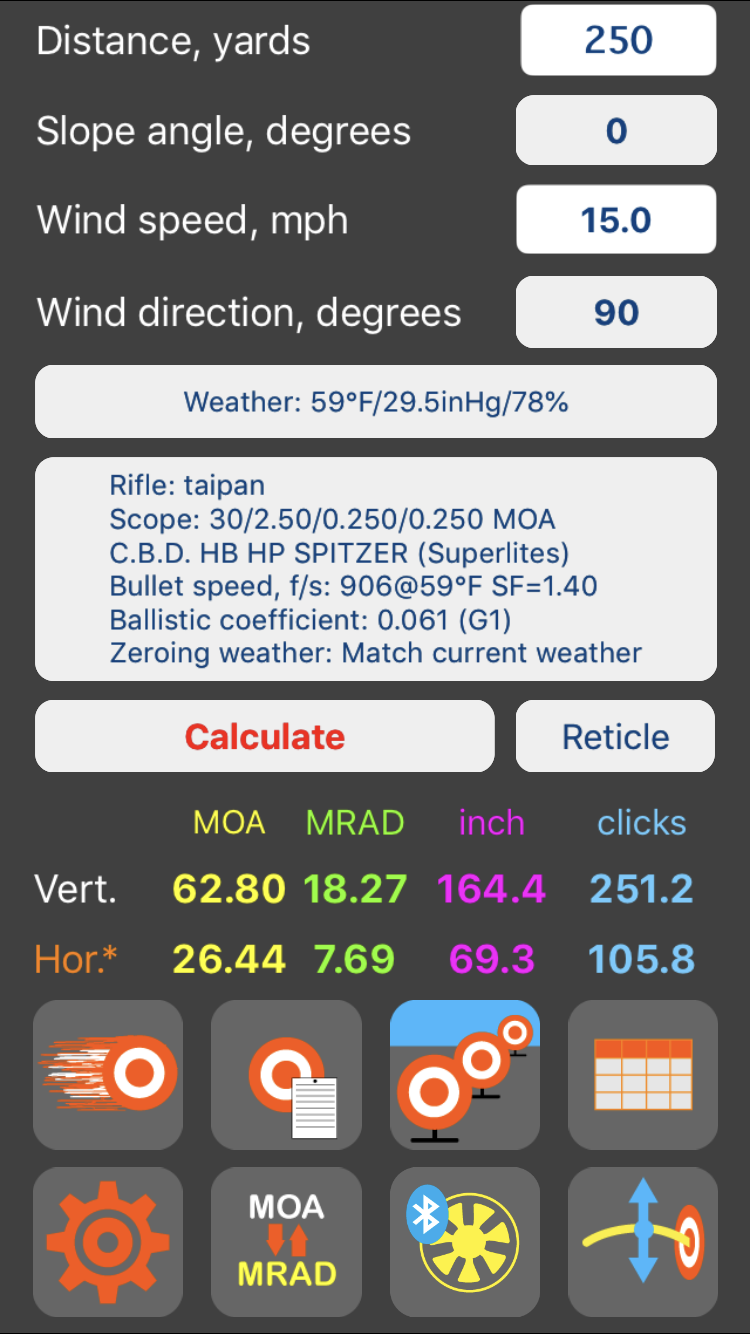

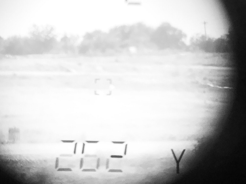

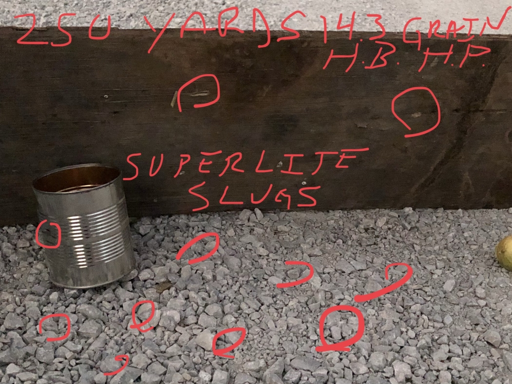

. Seriously though, at 14 grains and the current velocity it’s 13’ @ 250 yards (StrelokPro shows 164” elevation)
. Somewhere over the rainbow some feral baby soup cans are in big trouble!

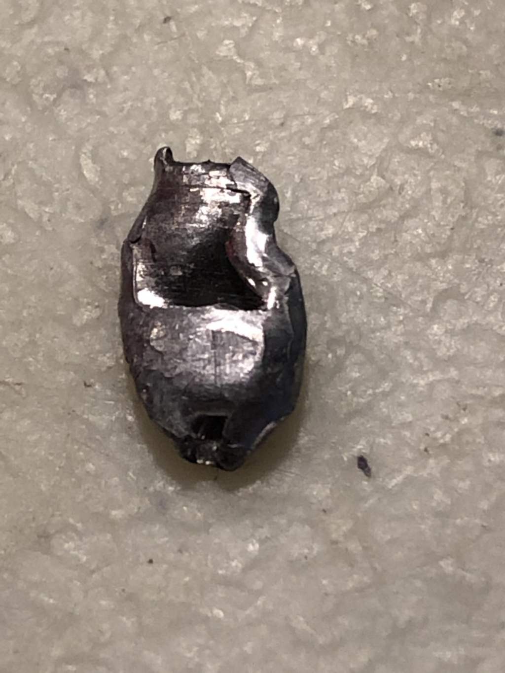

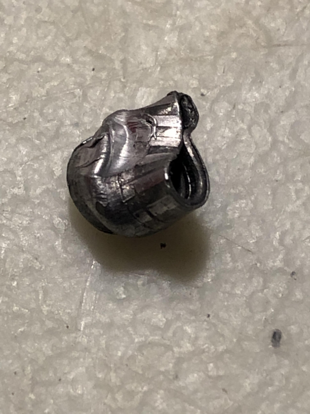

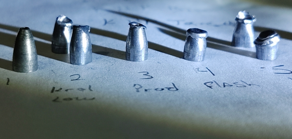

I got eyes to see) so that’s a variable or factor we can eliminate. He gave me some excellent honest feedback! He was able to go into great detail with multiple guns having different power levels to choose from. He even did water expansion testing!!! Maybe he’ll chime in and share his results.

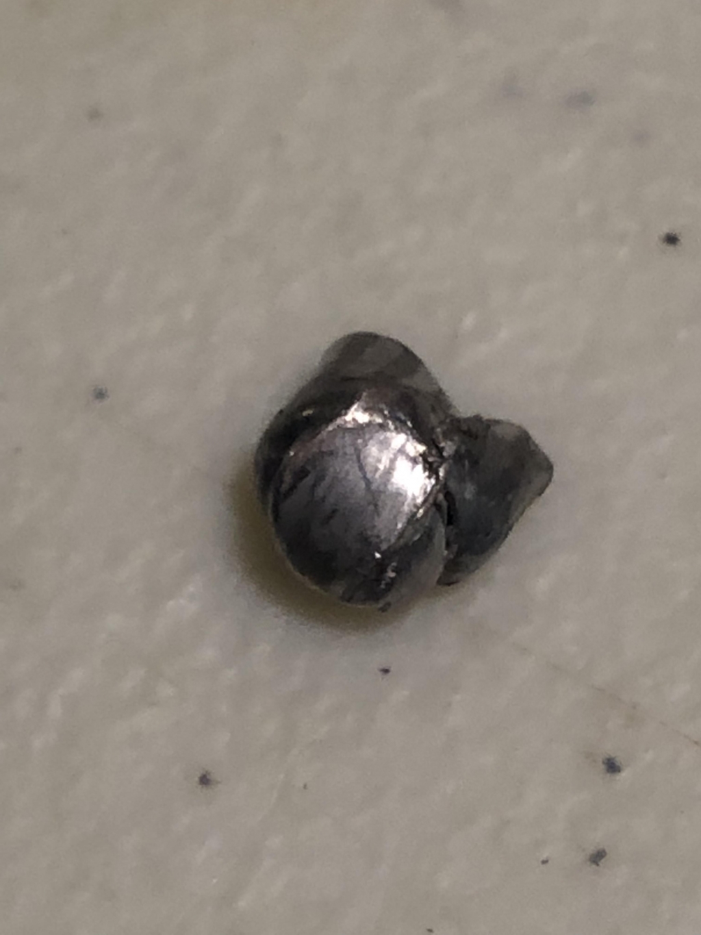

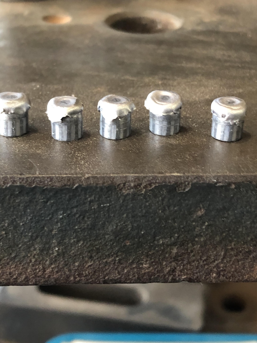

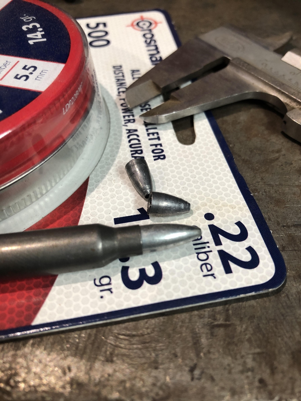

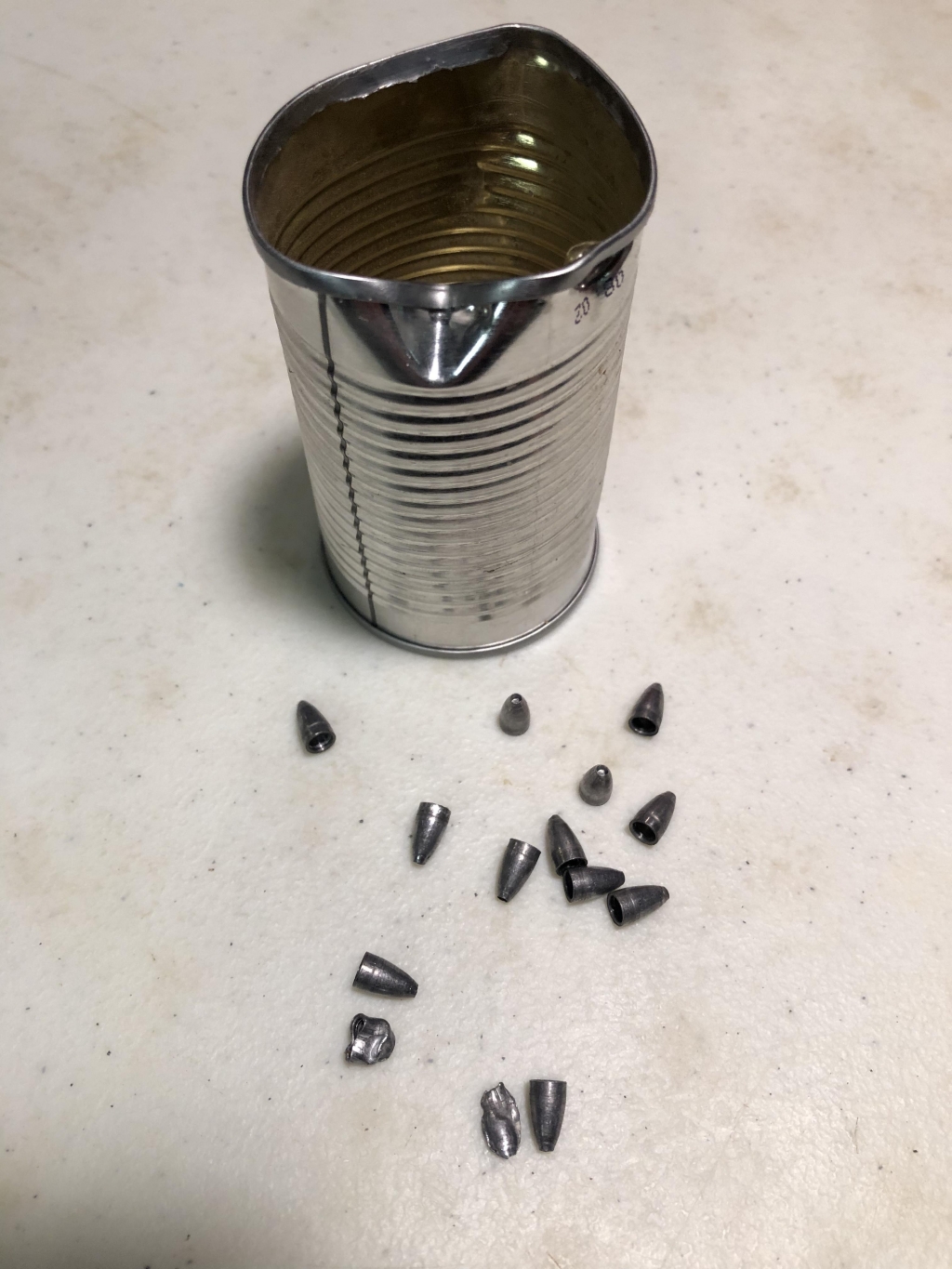

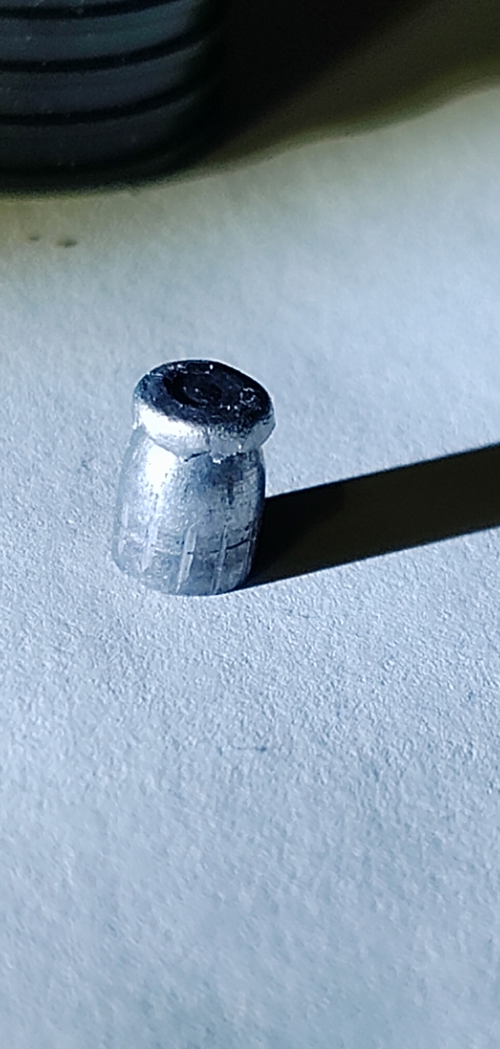

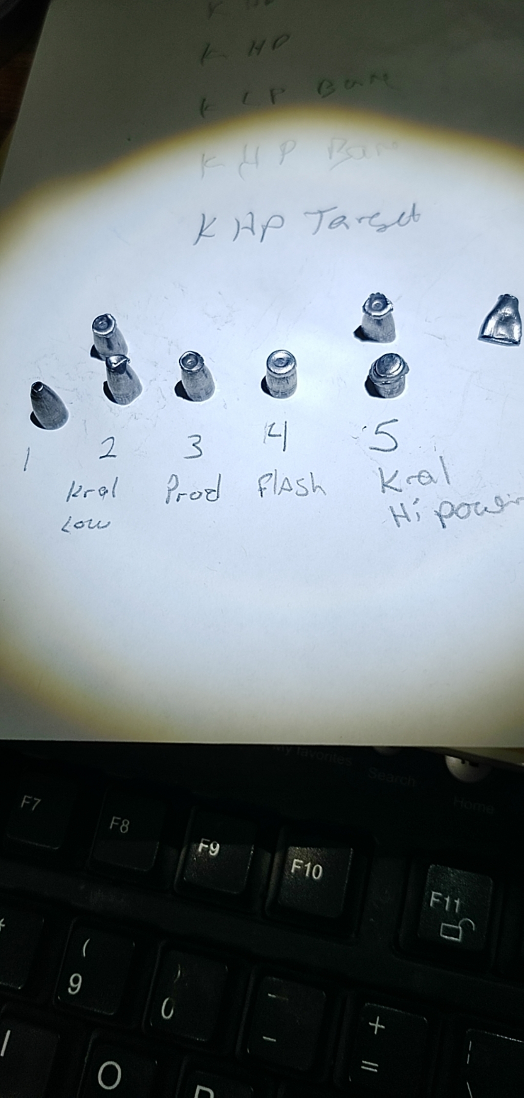

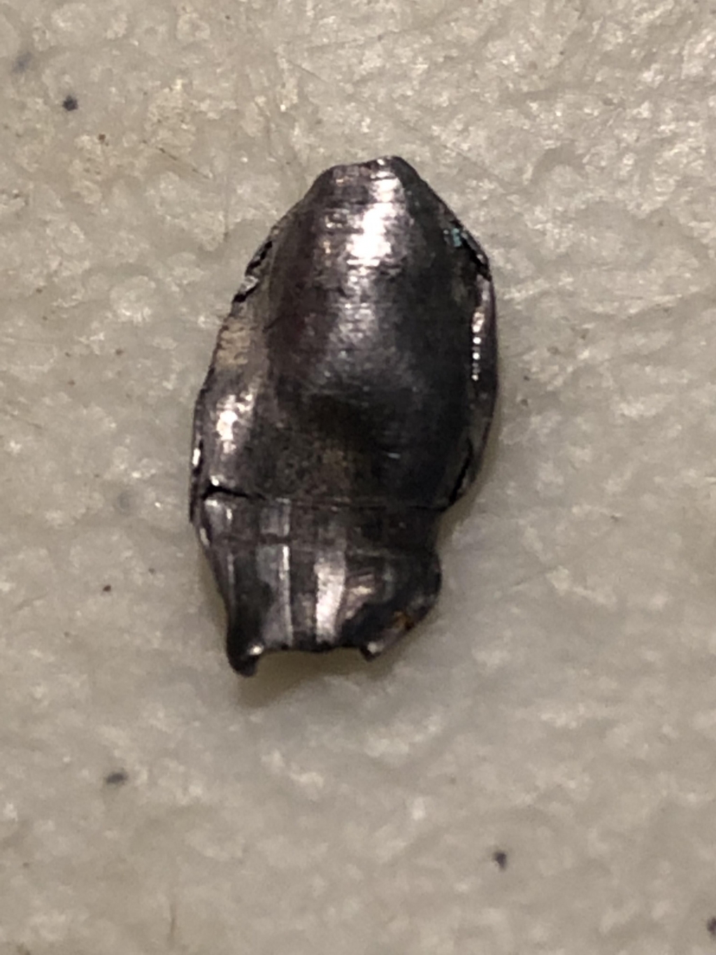

The fact that I am seeing the results I am seeing in my gun does not change the fact that I am experimenting . The projectiles are unproven and still undergoing slight changes as I learn from information gathered and processed. When said tester showed me the pictures of his recovered slugs not making good contact with the “ lands and grooves “ , I knew that they were doomed from the start! If it’s too loose it will not load straight. Even a few thousandths of variation is all it takes for inconsistency. If you do something the same way every time you will get the same results this is a proven law of nature , a fact of life we all know! And Loading a projectile different each time due to a sloppy fit in the barrel will produce different results each time. So as I was communicating with him, I was actually out in my shop swaging. And I thought that that a projectile that is loose, not making a whole lot of contact on the rifling, could make up for it simply by being longer. More rifling engagement through surface area not depth. At that point I changed the spacing on the H.P., I made it deeper, taking up more space in the die, displacing material , that has nowhere to go but to the rear, causing the flat/ skirt of the projectile to grow in length
I am trying to adapt a known projectile shape from the powder burning world to work in my air rifle. Or yours or anyone’s for that matter. The results I have seen thus far lead me to believe that with a little refinement I can achieve the accuracy desired. Of course I know that i am only subjecting myself to harsher conditions to overcome with a 14.3 grain piece of lead at long distances and sometimes unpredictable wind, but I’m still having fun! Hope you are too!
Here’s a Screenshot of the StrelokPro showing the elevation.
