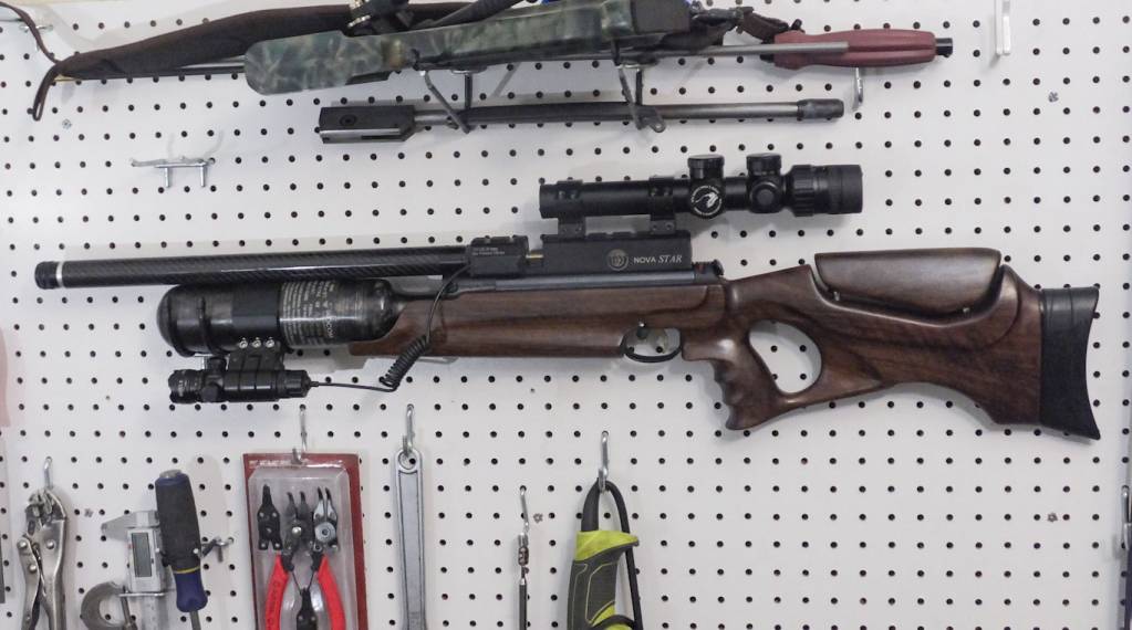

It's been over a year. And I FINALLY am seeing proper results from this gun. First I'll post a picture of it's current format.
It has a 22 caliber Lothar Walther barrel that measures 14.25" from leade to crown. The shroud is tensioned via a threaded muzzle/brake. Additionally I have a very small, almost weightless (.9 oz) moderator with 3d printed caps and baffles. The small mod is the most recent addition aside from swapping the scope, and changing how it is mounted.

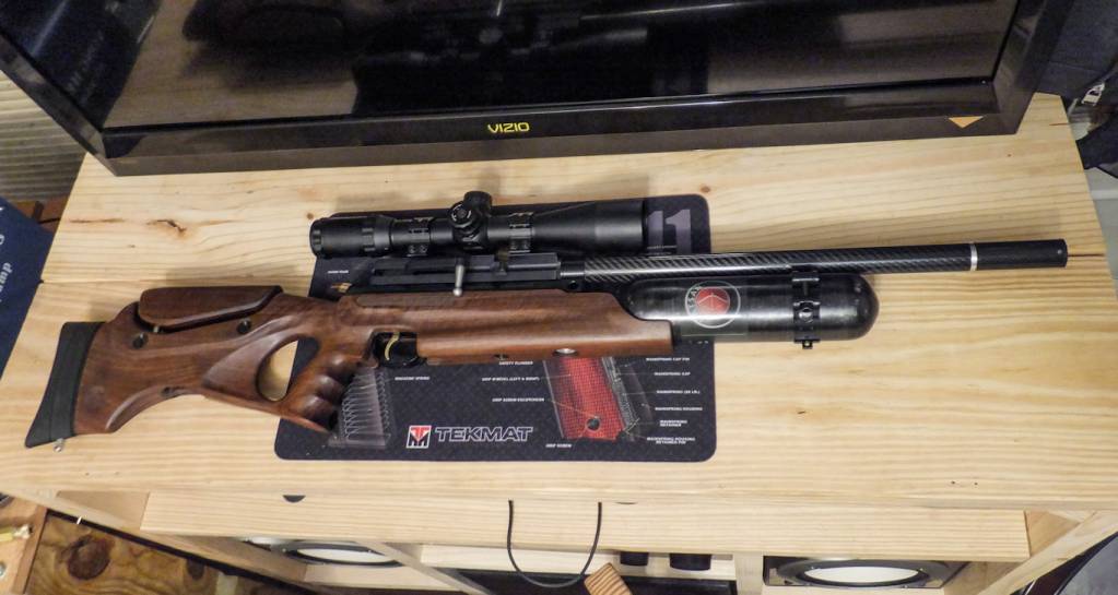

I had been using a MTC viper connect scope, but do not feel it is a good fit for this gun. For two reasons... Although the gun has a short barrel, I am still catching glare in the scope lens. I put it on my 1322 with maybe 1" added to the barrel length over factory, and I was still getting glare off of the shroud. Not so bad, but here's the real issue. Hatsan being Hatsan, in their Hatsan ways, milled the magazine cutout a good bit deeper than it needed to be. The magazines do not sit flush in this gun. There'a s few mm of nothing under them. What this results in is a receiver block that I can bend very easily. Without anything holding down the front half, I can pull the barrel upward. And it will move upward quite easily as the thin, flimsy section of the receiver flexes.... Note the scope is only mounted to the rear of the receiver below.
So, what we're left with now (top picture with 3-12-44mm scope) is a scope that is actually mounted in a way that is structural. It's a Hatsan. Why would I expect anything else? I digress. Between the structural enhancement, the LW barrel, and the tensioned shroud, it is punching some very tight, single hole groups at 25 yards now. I also have the original .177 barrel shooting just as well with monster re-designeds. That barrel would not shoot when I got it. I honestly think the tune on the gun was trash (WAY too hot, super harsh hammer cycle). And the barrel possibly needed polishing.

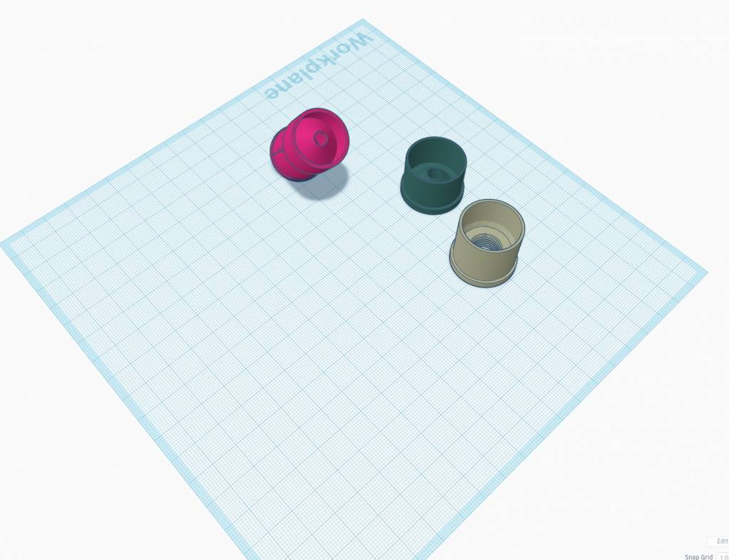

Posted below, 3d images of mod caps and baffle core. And shot string from this gun with 15" barrel. Can get an idea of how happy this gun is as long as you arent trying to crank down on it too hard. I decided not to port the tranfer port or the valve housing. My conclusion is that the multi-port design helps create the flat, long shot string. The turbulence and competing ports do reduce power a little. But the tradeoff is consistency.
