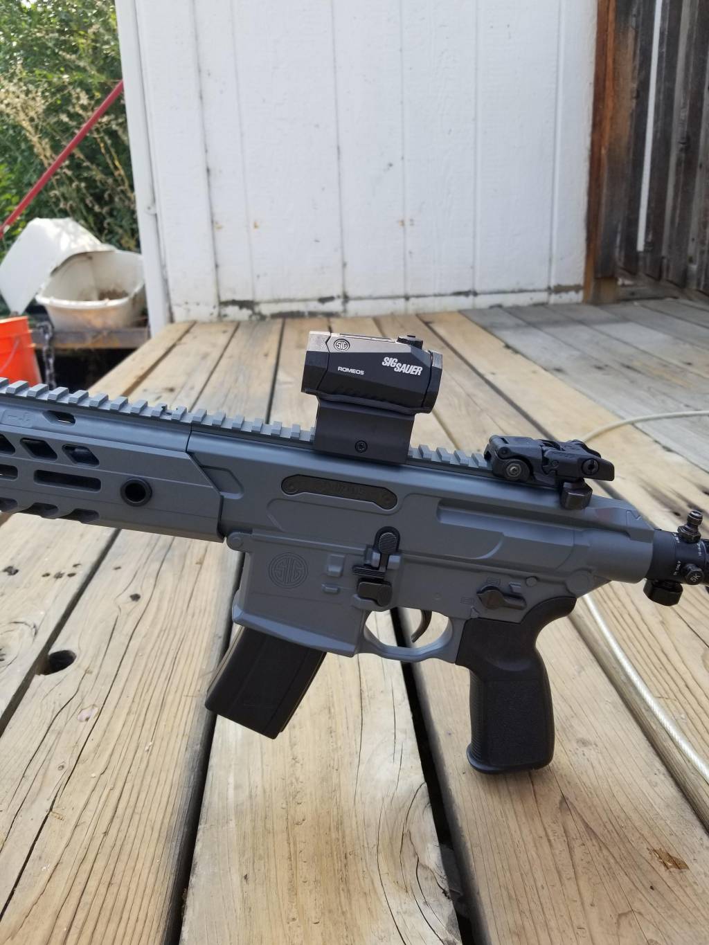

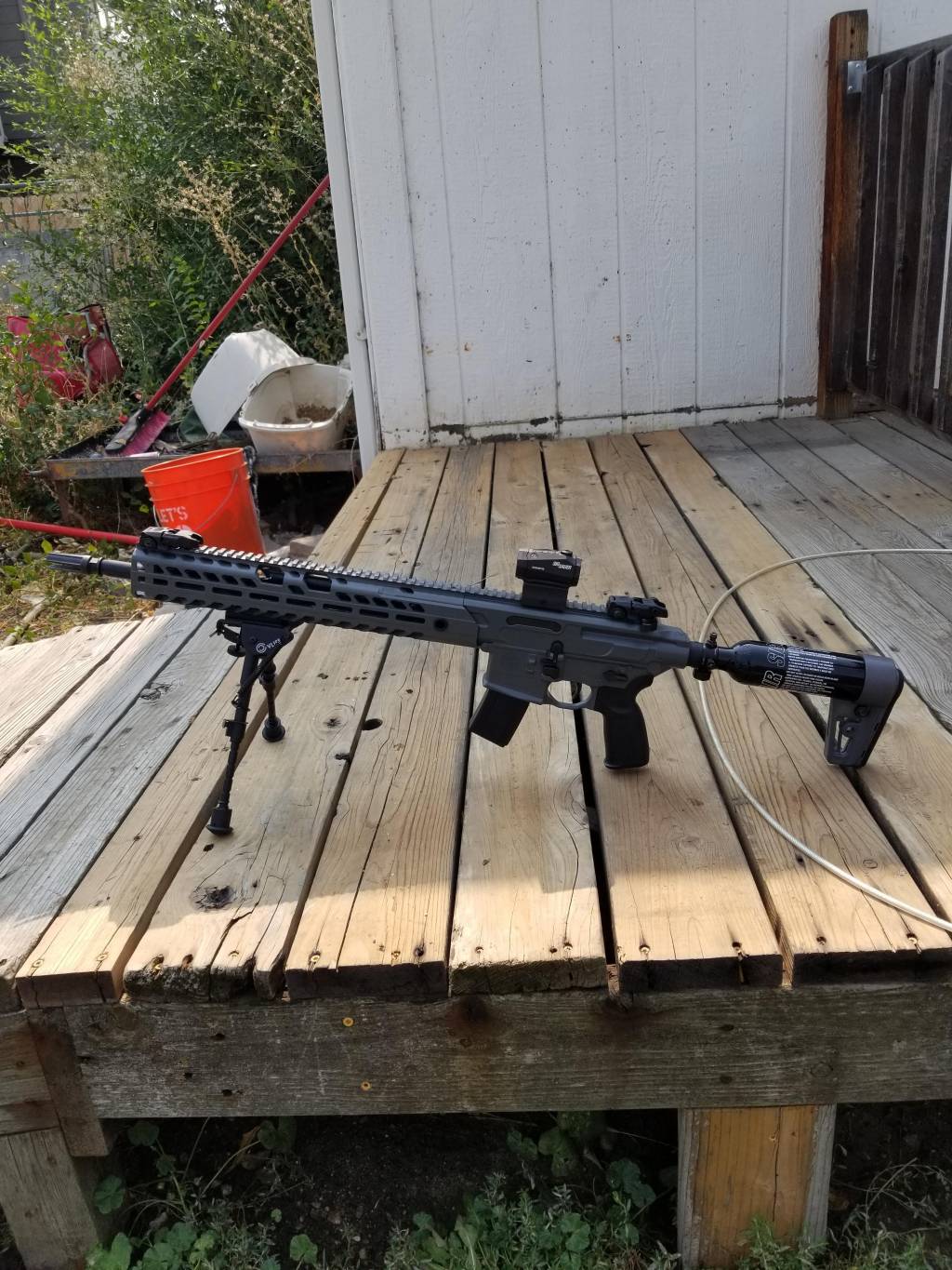

I have had good results with the sig sauer romeo 5 reddot, on my ar15, and on my sig virtus pcp rifle. They mount good hold zero, the dot brightness is adjustable, for small profile. The sight comes with 2 mounting plates, one low one co-witness.
Not the cheapest, but a good choise.
