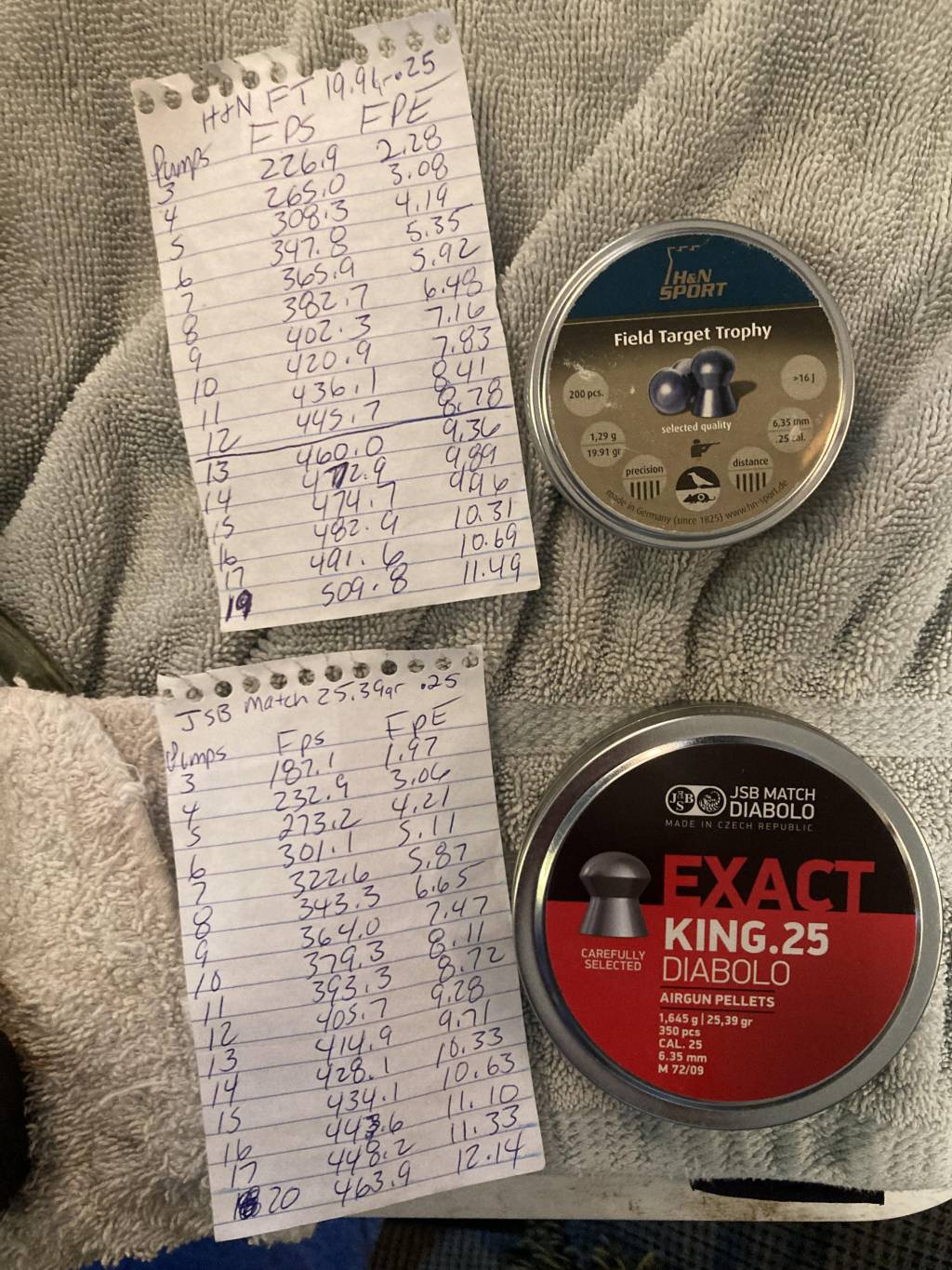

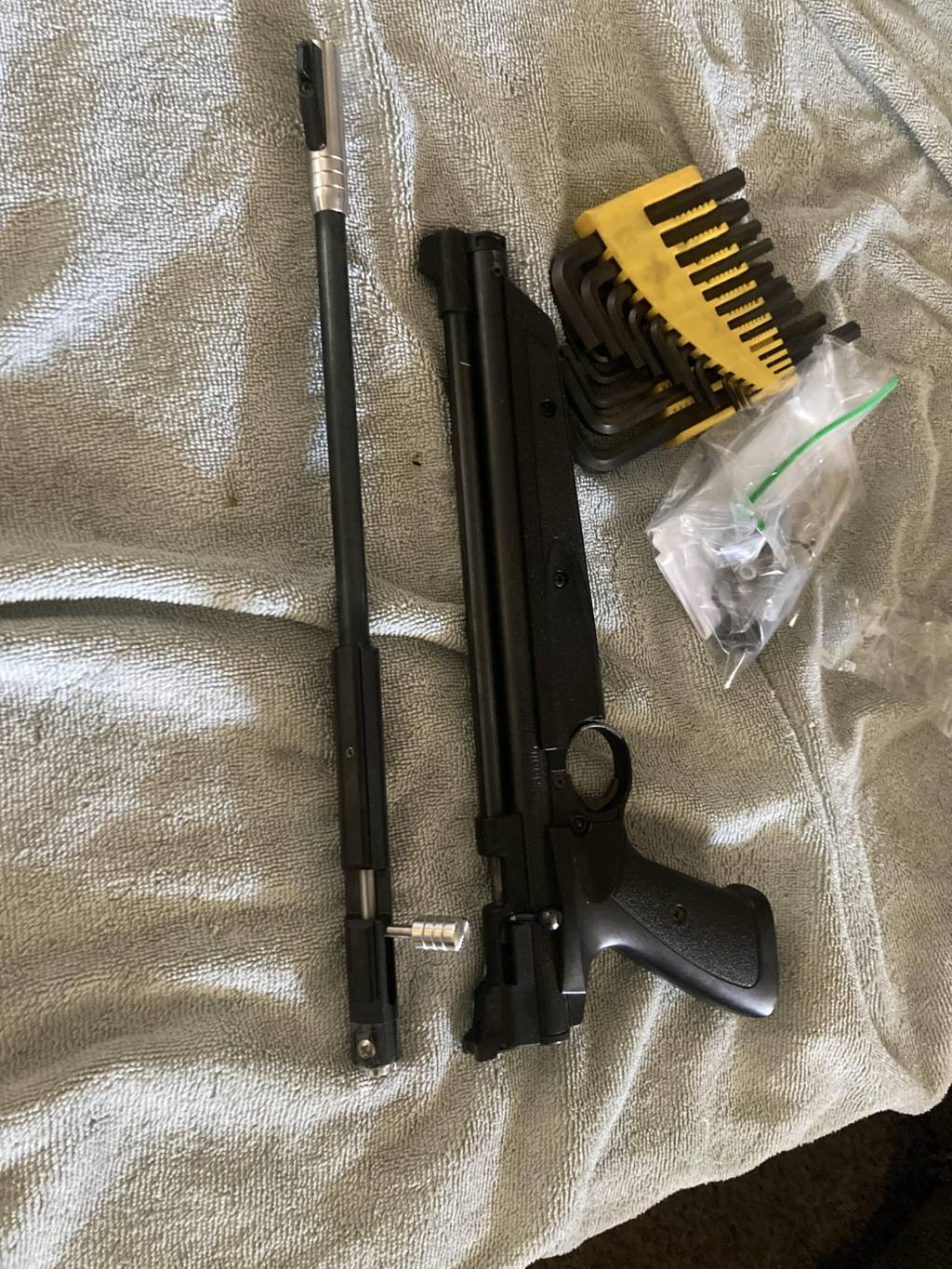

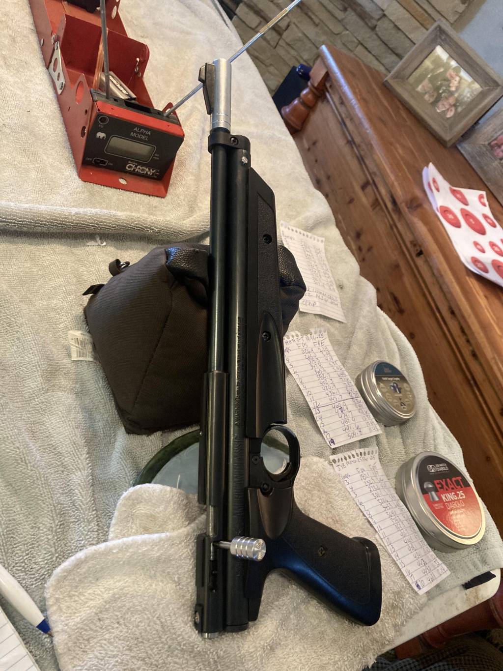

Roy Weid @ MountainAirAirguns supplied the parts I supplied the labor ! Really consistent fps per the amount of pumps . Rear sight is out for delivery today so accuracy testing is coming soon .

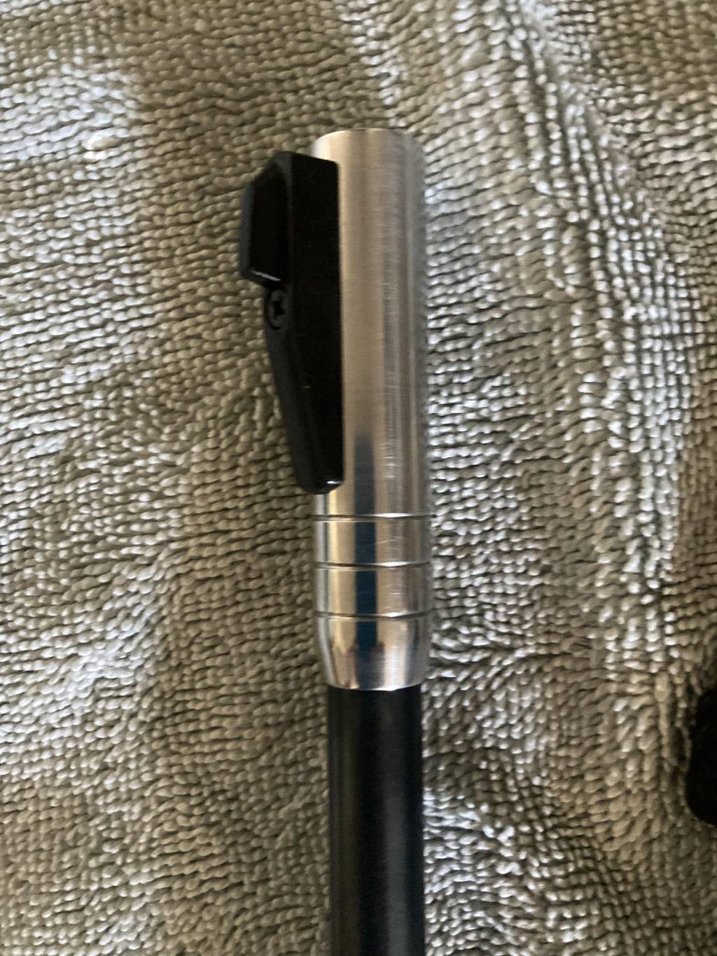

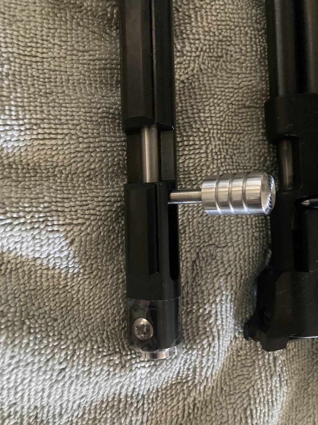

Roy also built the valve in this set up. He used to build and sell the entire gun and I always wanted one , well he quit building them but built me the parts to do my own . Will get some groups when I get a chance
